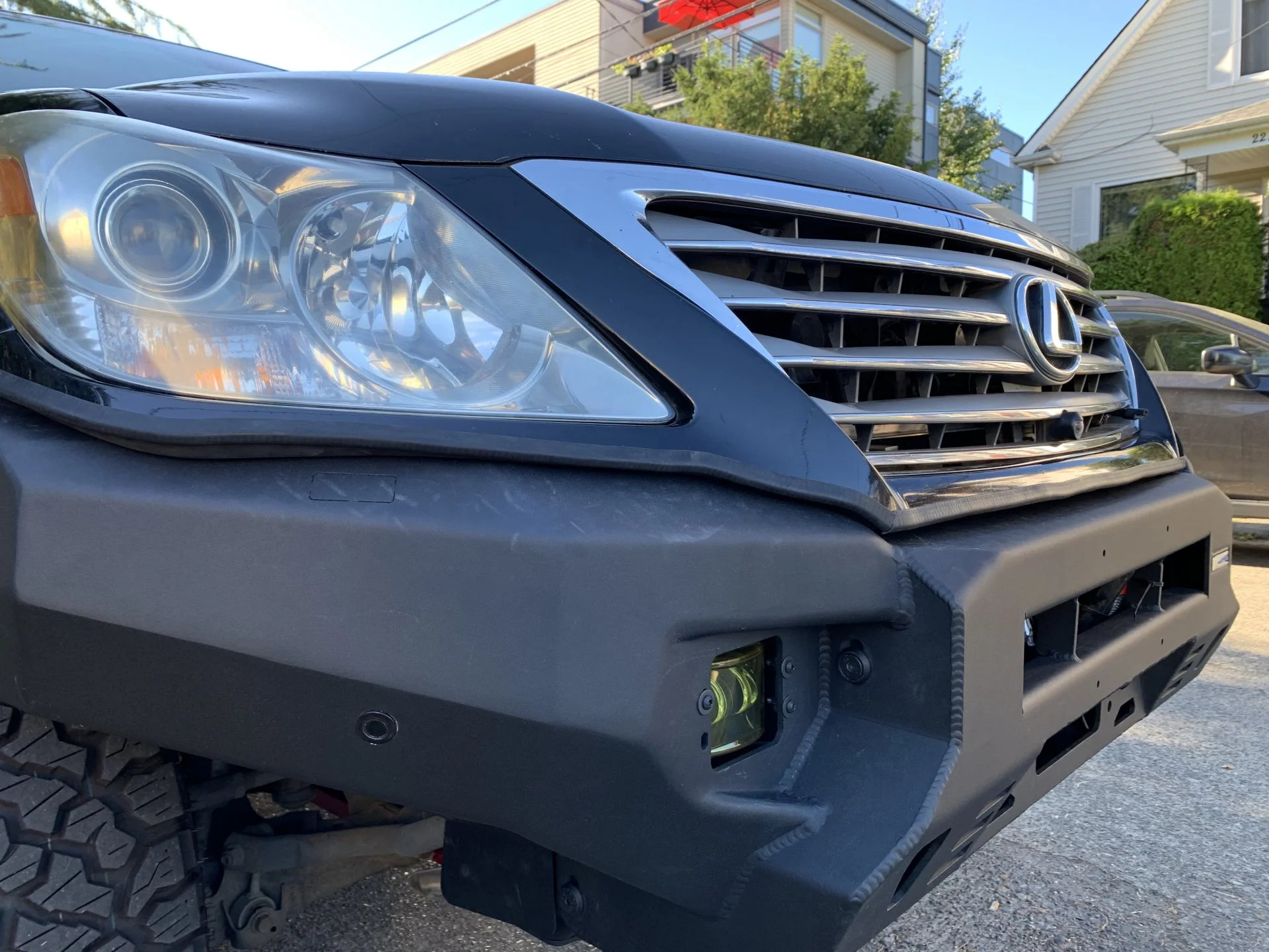

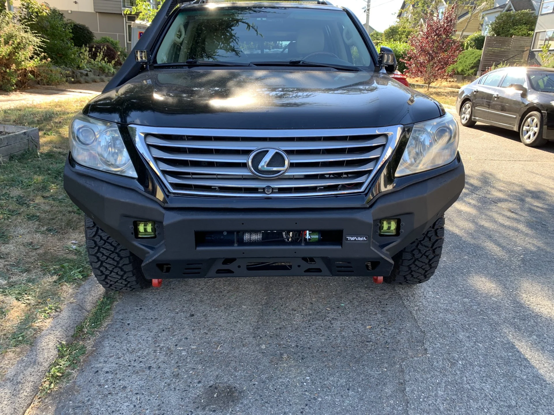

Here’s the finished install. Very similar to the render!

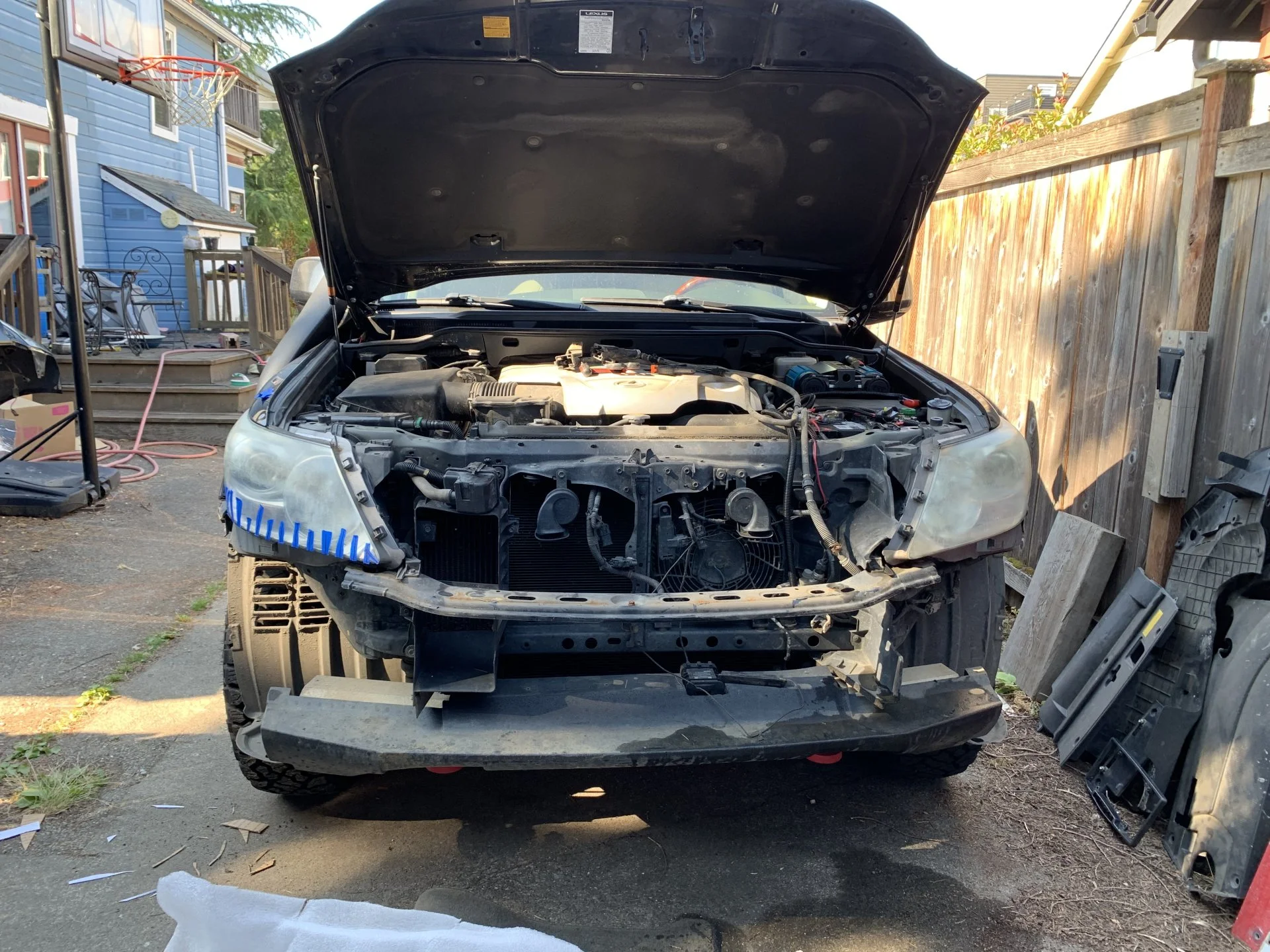

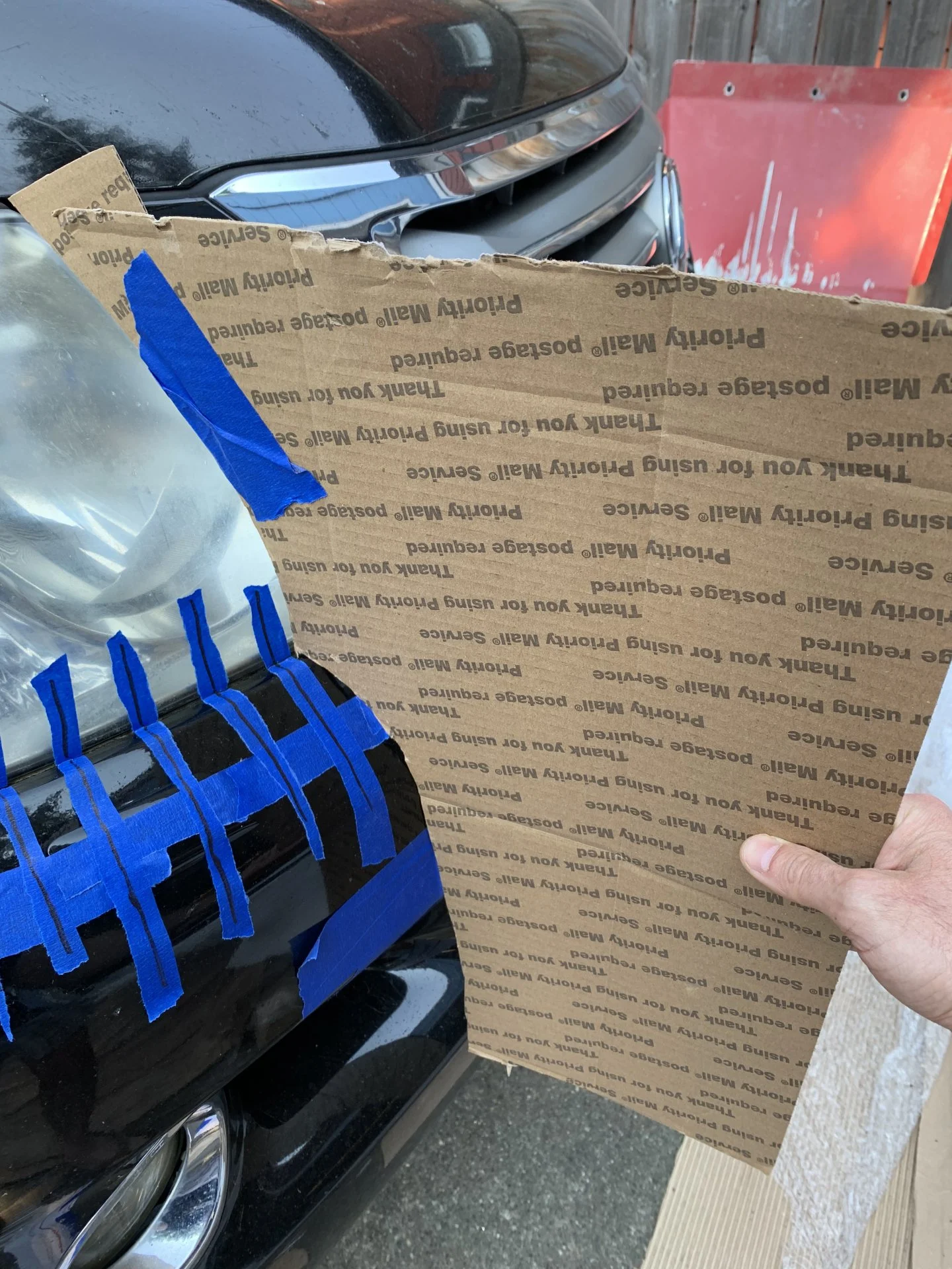

Made a couple projection templates to help with potential future trimming
My grille and cover clips wanted to stay attached. So I took them off together.
Broke one of the light washers trying to unclip the trim cover. Bummer, but want going to reuse them anyway.
Still managed to dump a couple cups of washer fluid before I realized I had no real plan to pinch those hoses. My radiator hose quick clamps are somewhere in the garage. For now the washer pumps are doing it.

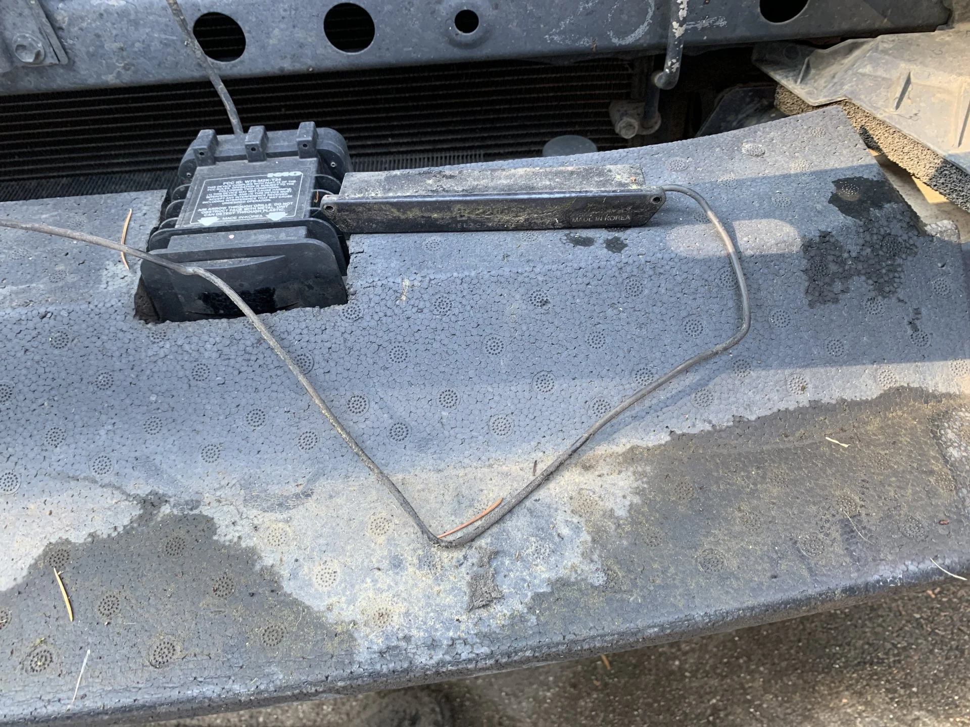

Looks like I have a laser and radar detector up front . Those will need to move . . . Had to disassemble the license frame to get the radar detector small enough to fit they the bumper cover

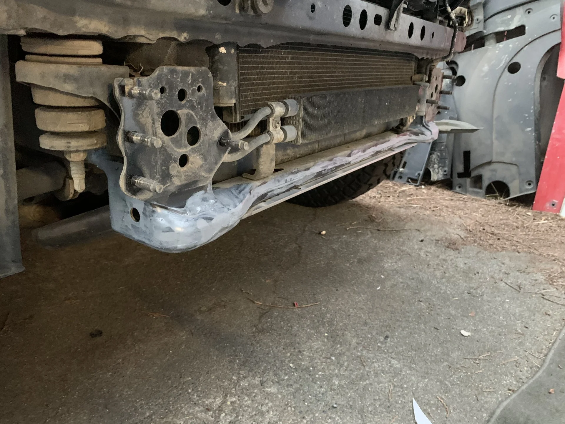

On step 19 - mount winch bracket.
Have some rust on the horns to take care of first.
Winch mount - 50lb
Bumper shell -60 lb
Brackets - 2 lb
Used a luggage scale, so around 110lb total for the bumper. Haven’t weighed the oem stuff yet.
Rust converter drying. Hope to prime before dark.
