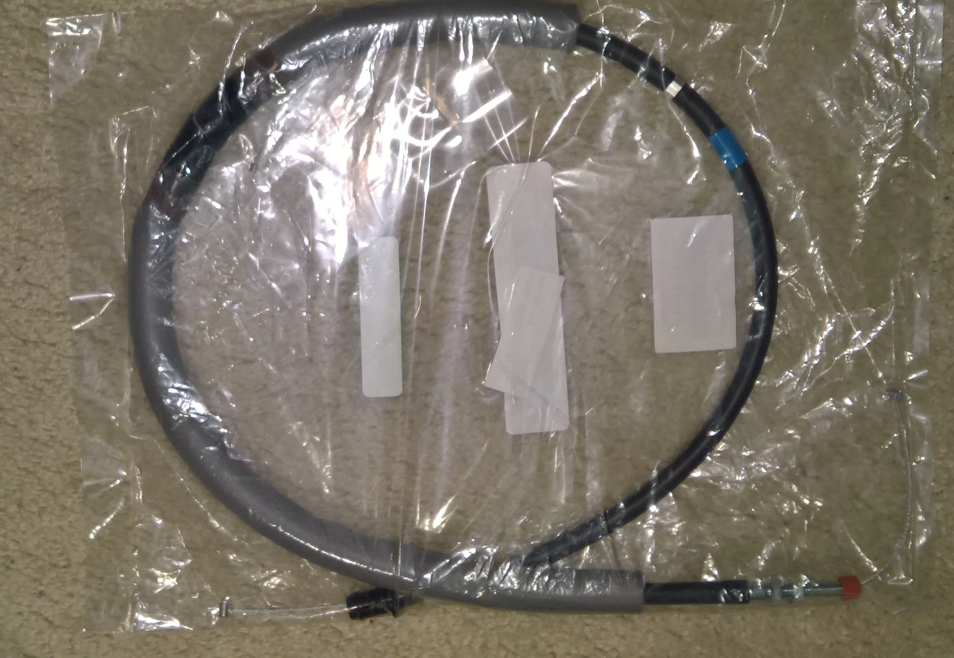

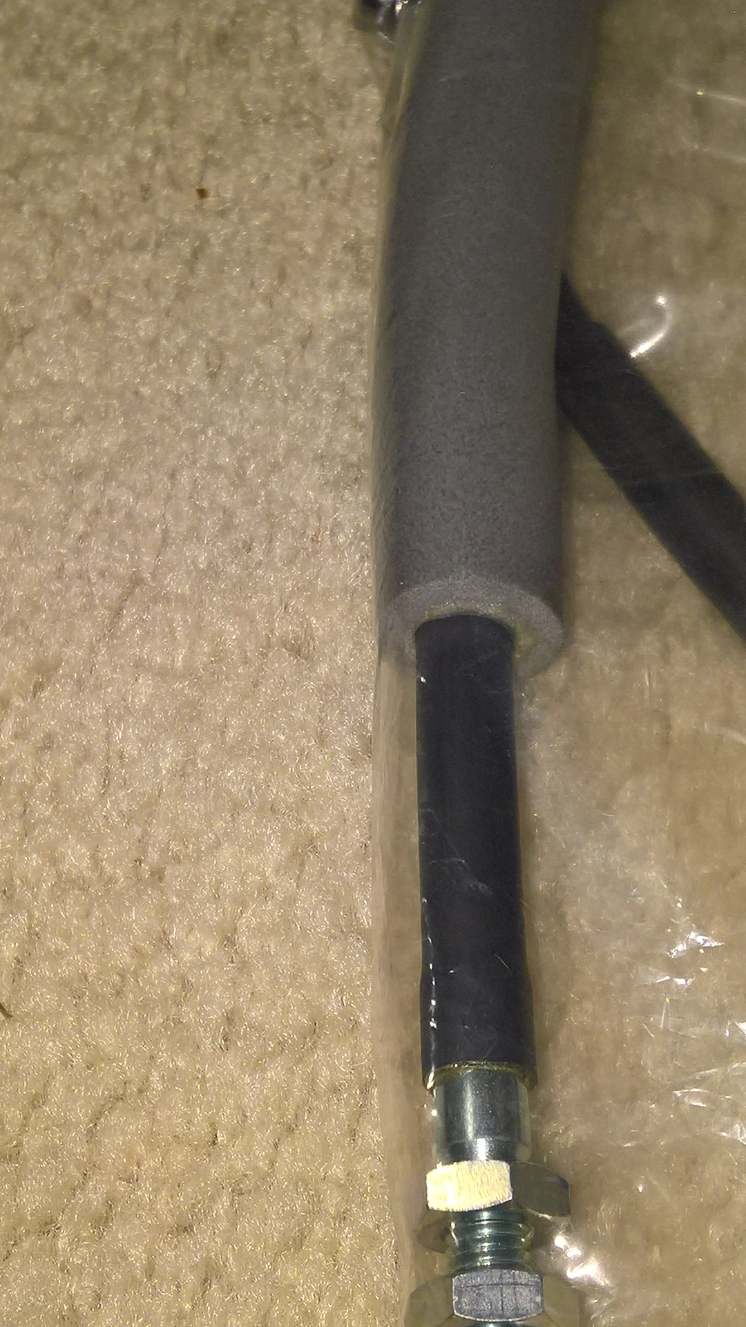

So for grins I ordered the Throttle Cable Assy, 35520-60111, which was used on earlier FZJ80 models with the A442F transmisison (which itself is a supercession from 35520-60010) and come to find that it's not exactly the same in appearance regarding the heat insulation sleeve for the later years of FZJ80. Instead of a heat reflective insulation sleeve it has a foam tube around most of the cable (see photos below).
The length of the part for the early models (35520-60111) is ~42 inches from the tip of the red rubber on the TB end to the tip/end of the black plastic part that goes inside the transmission.
So bottomline I'd like to compare an original cable for the 95-97 FZ80 model, 35520-60140, to 35520-60111. If someone has an original kick down cable from a 95 to 97 FZJ80 laying around it would help. Main info needed is the length of an original cable along with photos including both ends but particularly the end that connects to the transmission.
Point of this is, if the only difference between the cables is in the foam sleeve then a heat reflective insulation sleeve could be added.

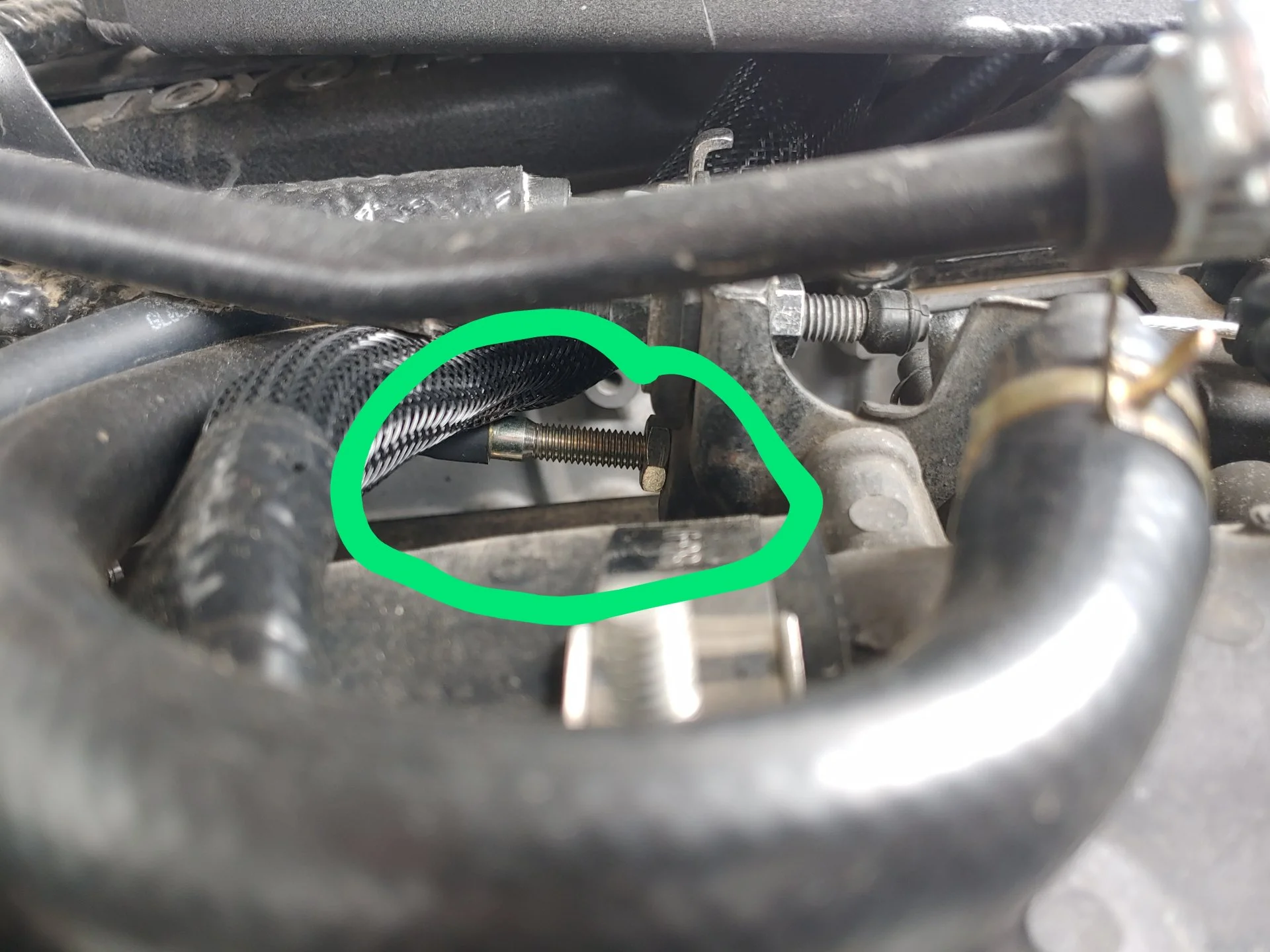

I'm using one now on my 95'. It's a little shorter than the original, so we had to dial in the adjustment.
*Note - my throttle body is in a different location because I'm SC'd.
White Sheep: which transmission does your 95 model FZJ80 have, and is your throttle body position further away or closer to the firewall compared to a stock position? And how much did you have to "dial in" the cable, mm's or inches?
Also, did the replacement Throttle Cable (35520-60111) connect to the transmission correctly; same design for the transmission end of the cable??
Could you post up a photo showing the replacement cable and Throttle Body?
The throttle body is closer and I just had to tighten the tension on the kickdown cable.

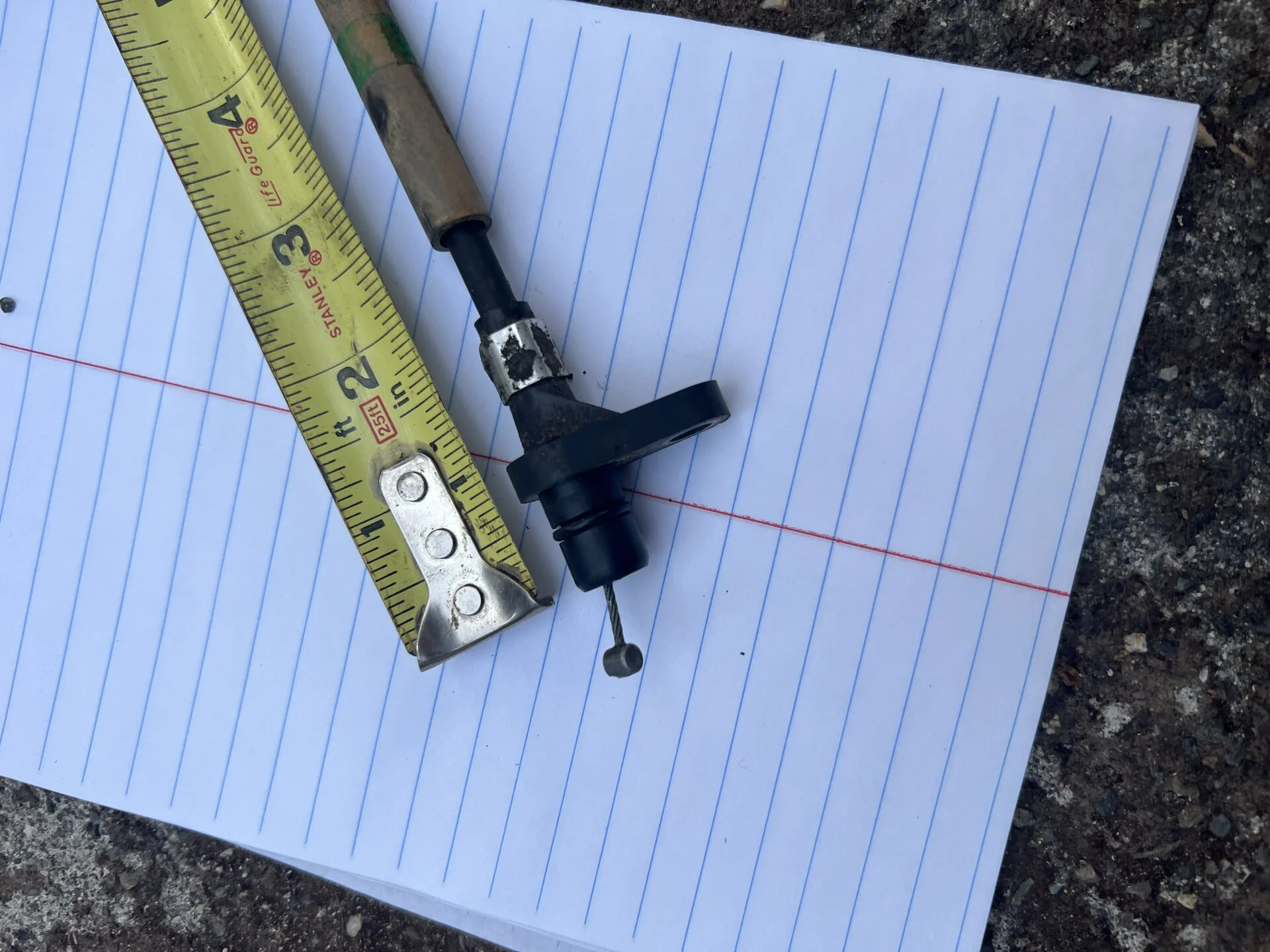

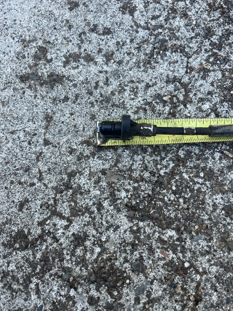

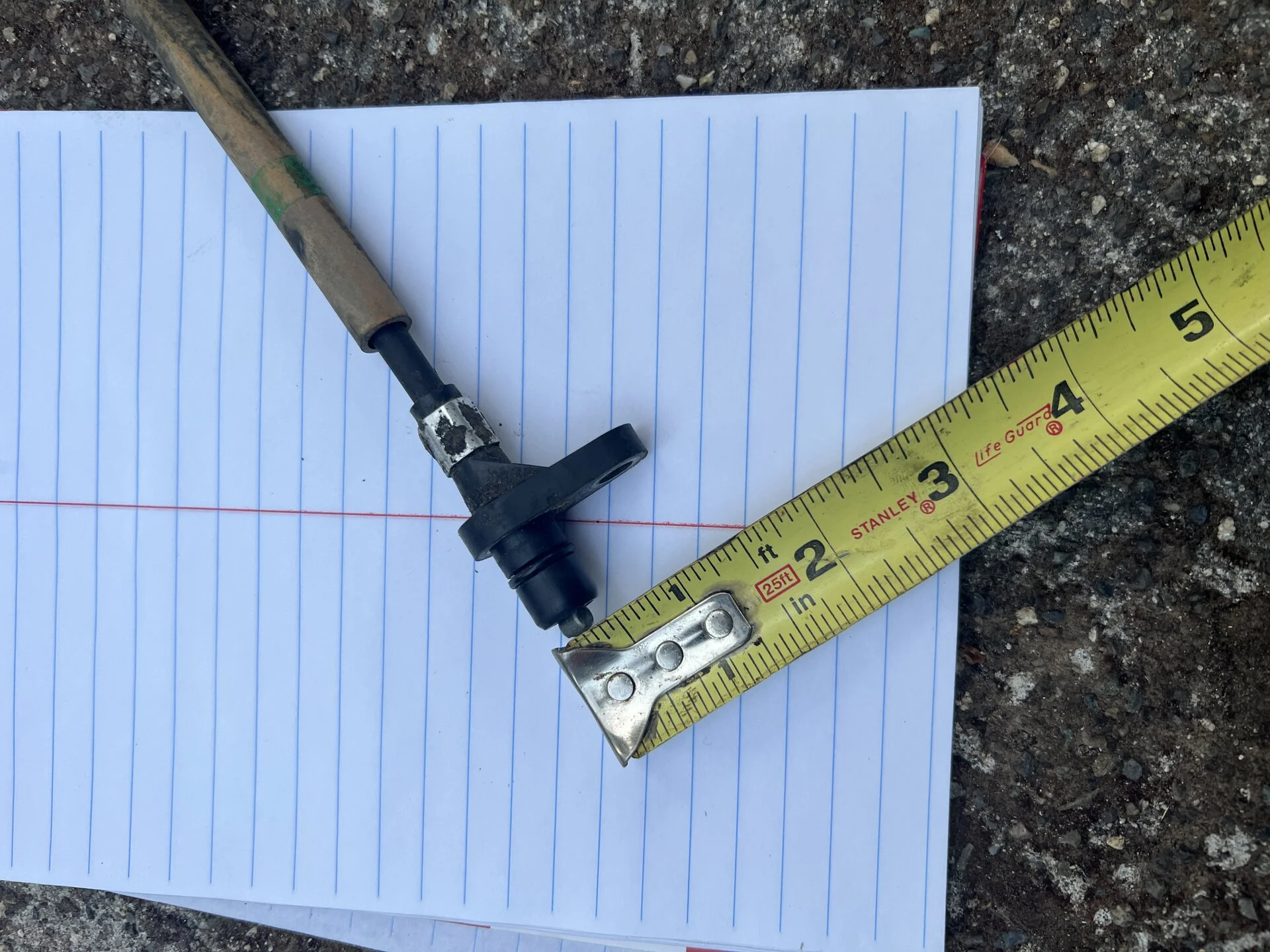

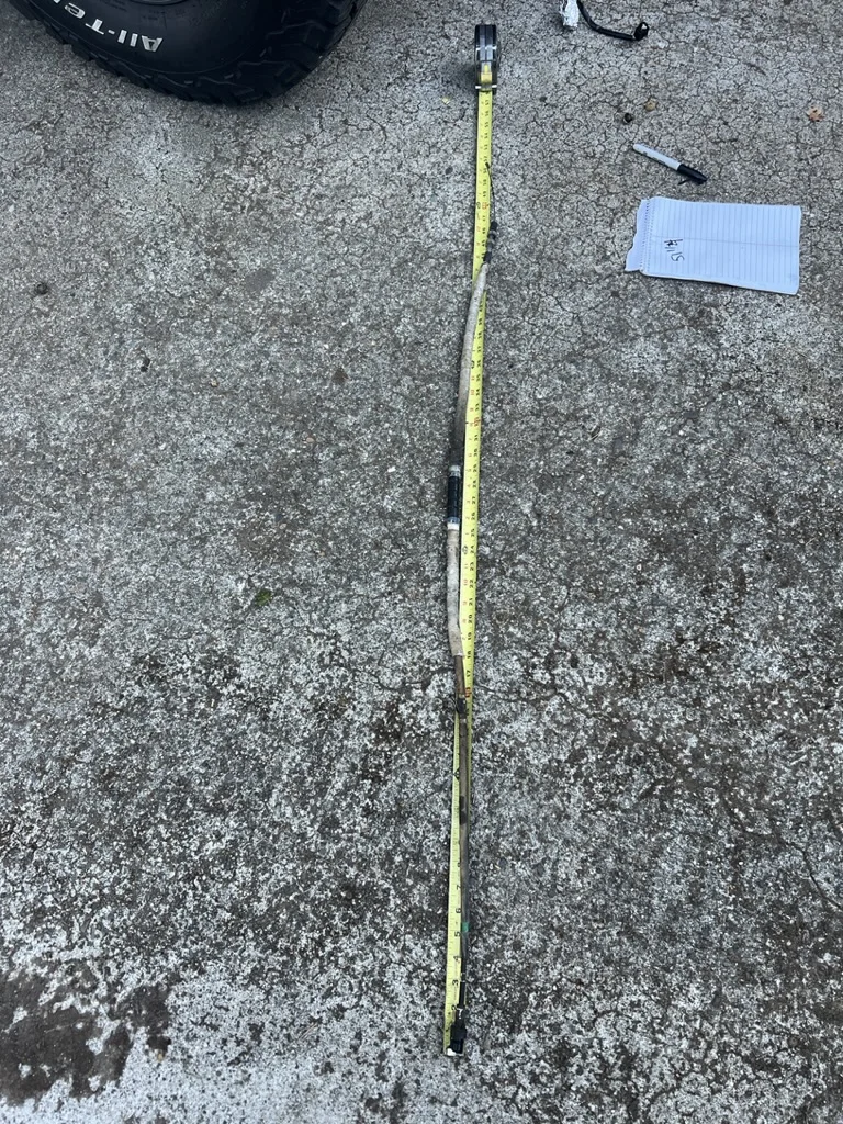

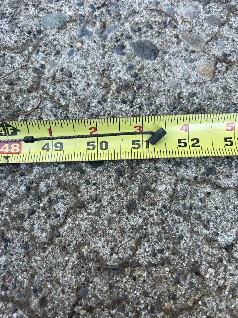

Here is an A343F kickdown cable out of my 96 FZJ80
(35520-60140)
51 1/4" long
@jeffwgates Thanks and Welcome to MUD !!!
Could you post up a photo or two showing the black end of the cable that goes into the transmission?
I'll pull out my new 442 cable and double check it's complete length.
