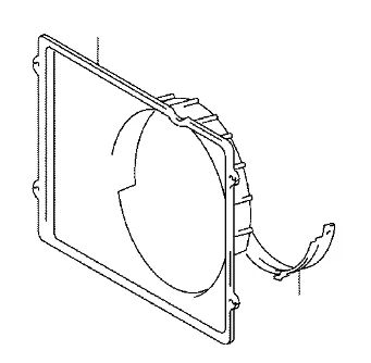

Team,
So I was replacing my Timing belt and while removing the fan my fan shroud kinda broke into pieces and when I took it all out it was pretty much cracked where I could not fix it. I was wondering if a Toyota Sequoia 4.7 fan shroud fit ours? I know the top part may need to be modified to pass the ac lines or so. But would it fit? From what I can see it is the same radiator size at least in length.
BTW I would look for a used fan shroud and not a new one.. cause both then are about the same pricing.
Thanks in advance.
See if you can find a parts diagram on say, Partsouq, and compare the PNs. That could be an easy way to tell
So I know the parts number is not the same between the 2 cars.. as I mentioned it likely b/c of the AC lines that come from the top in the LC. These lines get connected to the LC fan shroud the clearly the Sequoia Fan shroud does not have.
I don't know how this will turn out. But I will greatly appreciate someone finding a way to use a Sequoia fan shroud.
The two piece Sequoia/Tundra/Tacoma design is as handy as a pocket on a shirt.
Check the part numbers and application cross reference.
Fan shroud is matched to the fan/ fan pitch & depth/ fan bracket and fan clutch. There is an optimal distance the fan sits inside the shroud in order to pull air effectively through the radiator. If the shroud is too short it will pull air from sides and not through radiator.
You’re better off ordering the right part or buying a used part- than trying to make something else work

A new OEM shroud is not expensive. $83 plus the ride from www.partsouq.com and $102 plus the ride from toyotapartsdeal.com
If it were me I’d just swap in a new one, or at least a good used unit before attempting a retro-fit.
