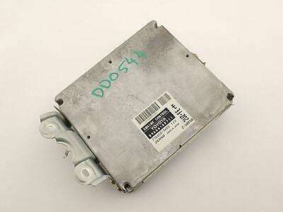

You could always try to find an inexpensive ECU, through a salvage yard (or eBay), to have reset, and then your vehicle doesn’t have to sit…
Something like this maybe?
Man that is an awesome idea! Thank you. I read that suggestion somewhere else in my research.

If you are able to remove and resolder a small surface mounted eeprom on the ecu I would be happy to send you a free pre programmed eeprom.
Awesome! I have a couple of buddies who know how to solder. I will talk to them and get back to you!

Out of curiosity, does the re-flash of the ECU also reset the remote FOBs? I have an odd situation in my 2002 LX470. At some point the PO needed to replace the ignition cylinder and the Toyota dealer did so, but instead of having the ignition cylinder keyed to match the original key code, they just installed it. So now I have one key that functions in the ignition, and one for the doors, rear hatch, and glove box. I do, however, have two functioning remote FOBs and I'd like to keep it that way...
If I sent the ECU for a re-flash, would I lose the remote FOBs as part of that process?
Thanks!
Thanks!
It’s been a while since I did this to my 99 LX, but from what I remember…
Replacing/reflashing the ECU made the vehicle forget about the RFID chips in the keys (which tells the immobilizer which keys are authorized to start the vehicle).
I’m pretty sure that it didn’t affect (or forget) the remote lock/unlock/panic function on the keys with that function.
(The RFID chip is inside the same plastic housing as the buttons/battery. On some of my keys the “chip” is readily accessible/removable/replaceable/transferable, on others it is not)
