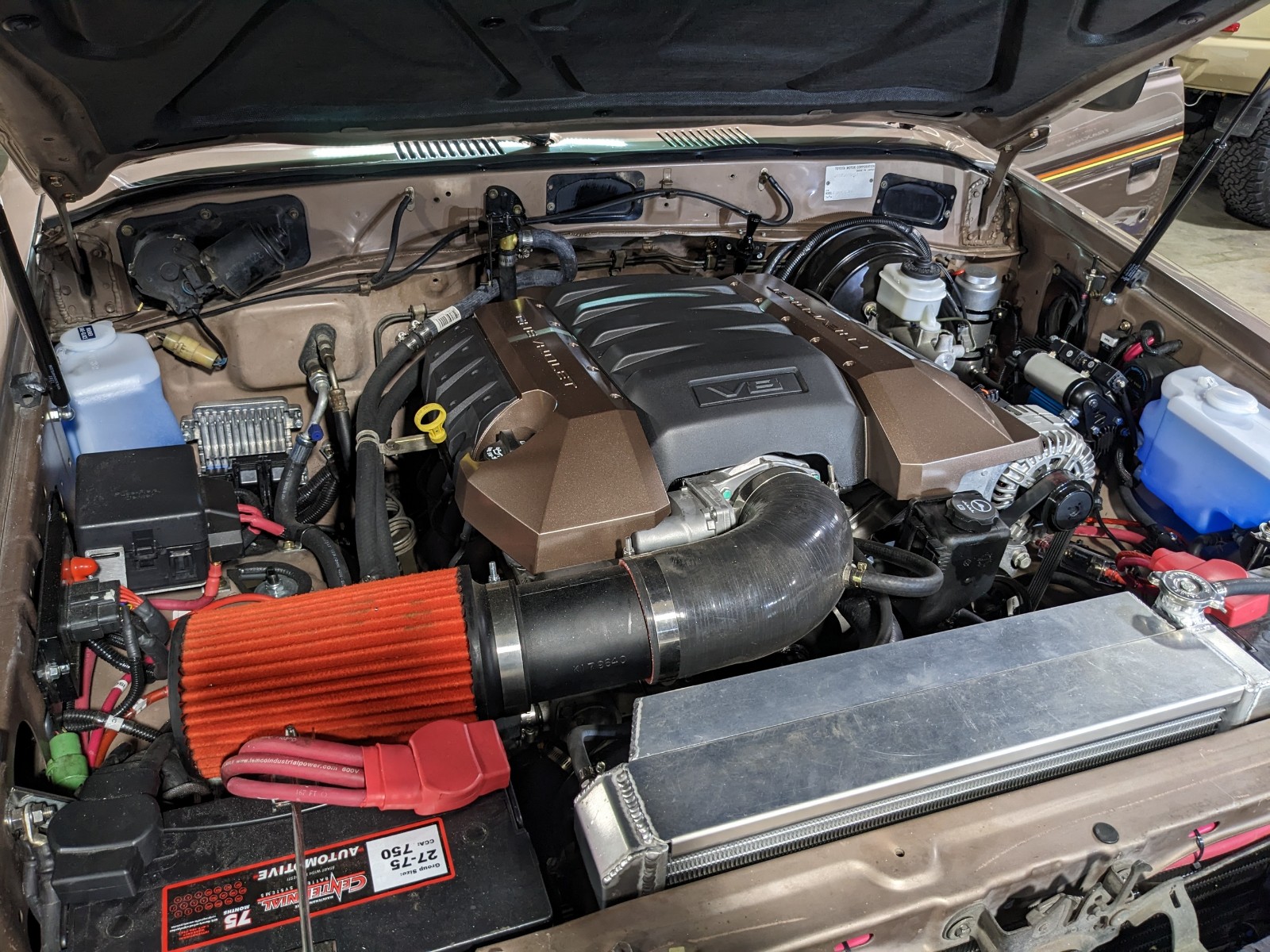

I thought you were in Colorado. Some counties in colorado are still emissions free. If your in Texas go for the LS swap. You will not regret it. If you had a fj40 it might be worth hot rodding the 2f. But you won't get enough power out of a hot rod 2f in a fj60. Plus LS parts are available in abundance at every parts store. They are easier to repair than a 2f as well.
Oh no, I’m in El Paso county, Colorado. So it still true :) I’m trying not to fall into the purist trap but I really want to keep it stock engine, which is why I asked but I have to be realistic now.
Oh ok. The LS will just make it more useful all around. You can tow trailers with ease, easily keep up with modern highway speeds, much easier to drive, and you have infinite performance upgrades if you want. You can call up proffitts and ask them how much a swap costs with a used motor. It will be 20 to 30k most likely for the shop to do it. Thats definitely a chunk but im guessing youll keep this rig a long time. Still cheaper than a new suv and will retain value since its a fj60 rather than lose value like a brand new suv.
The EROD LS exists too, for those suffering the californication laws
Yep we install them on almost every build. Passes all SMOG counties and even the dyno tested "Enhanced SMOG" areas (more strict)
Will run 100mph with ease; if you want..

Put a manual trans behind the erod and it’s extra hot roddy!
Cheers
I wonder what options would work for a manual behind an EROD in a 6x series rig.
Anything that will fit a gm bellhousing. H55, nv4500 etc.
