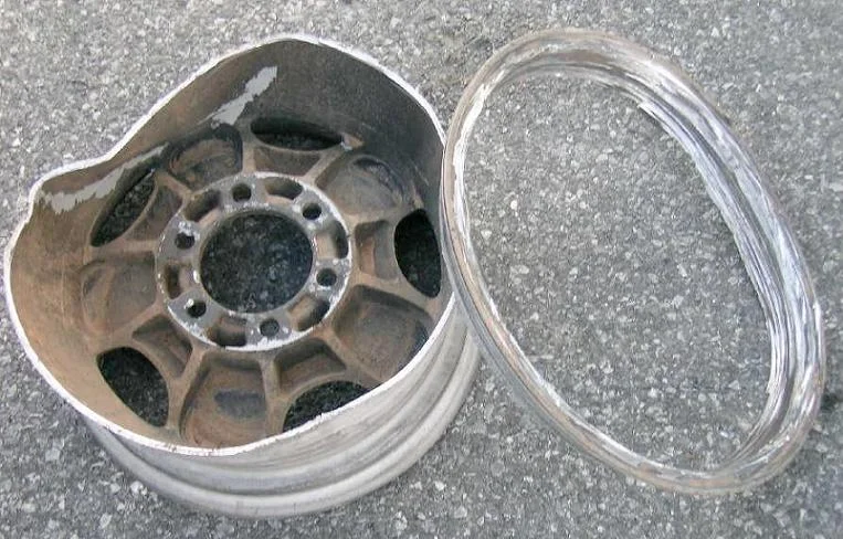

I had my cruiser at the garage last week to get the PA state safety inspection. Since they have to pull wheels for brake readings, I asked them to rotate the tires. Drove it home and left it sit all week. This week I drove to Philly for work. On the way home, my rear driver-side wheel decided it no longer wanted to be part of my truck. It left my truck at 65 mph, hopped over the barrier and tried to become part of the front end of a tractor trailer. Less than 200 miles from the service. Thank goodness no one was hurt. The cruiser had to be hauled about 80 miles to get it close to home. Not sure what happened to the tractor trailer, but the driver was okay and the truck had to be towed as well. Lesson? Torque your own lugnuts. The garage is being very good about it and is taking care of fixing the cruiser. The basically said they will do everything necessary to make it right. I'm glad there are still some stand-up people in this world.
I knew something was wrong before it let go and was preparing to pull off to check it at the next wide spot on the interstate, but the wheel beat me to it.
Anyway--worried what might be wrong with the rear axle/suspension/driveline that can't be seen at the moment. The plan is to replace everything that looks damaged and then put it on an alignment rack to see where the back end stands. The axle hitting pavement at 65 mph can't be good.
And now the pics.
More pics.

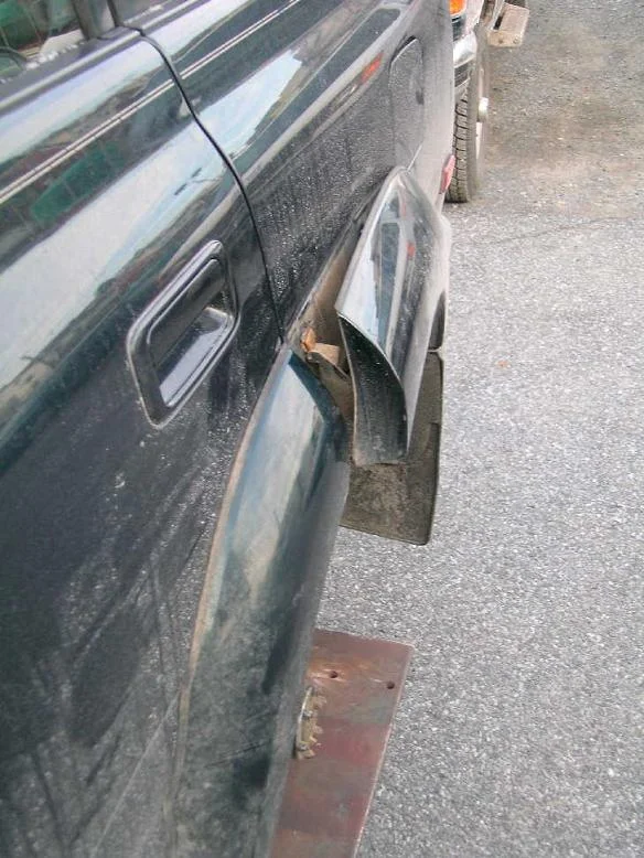

Some more of the underside and flare.

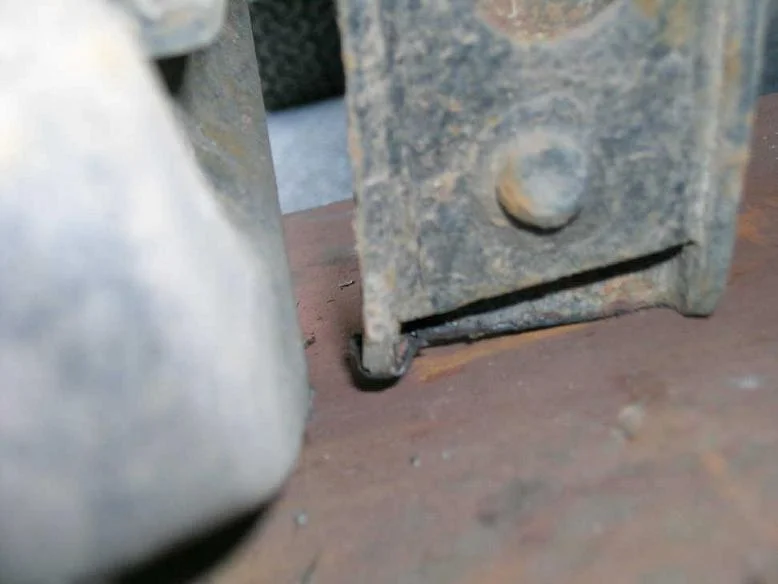

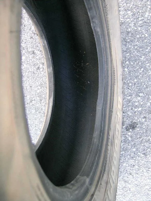

A couple more closeups
Shock mount and tire bead. Tire bead is slightly bent.

The truck should be on the lift today. I plan to go over to the garage and get a better look at the axle. I'm concerned about both the axle being bent and the condition of the shock mount, since it drug on the pavement. Should I also be concerned with the status of the wheel bearings since the rotor took the brunt of the impact? The way this is going, I think I will only be really confident in the repair if the axle is replaced.
