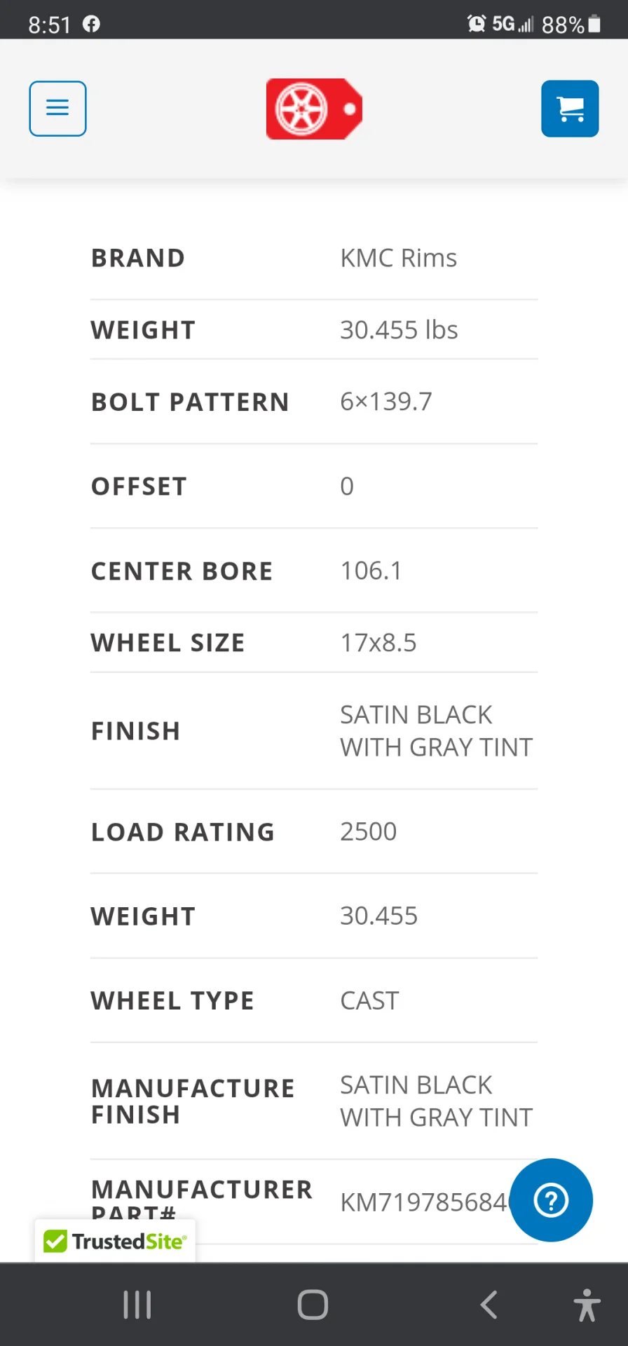

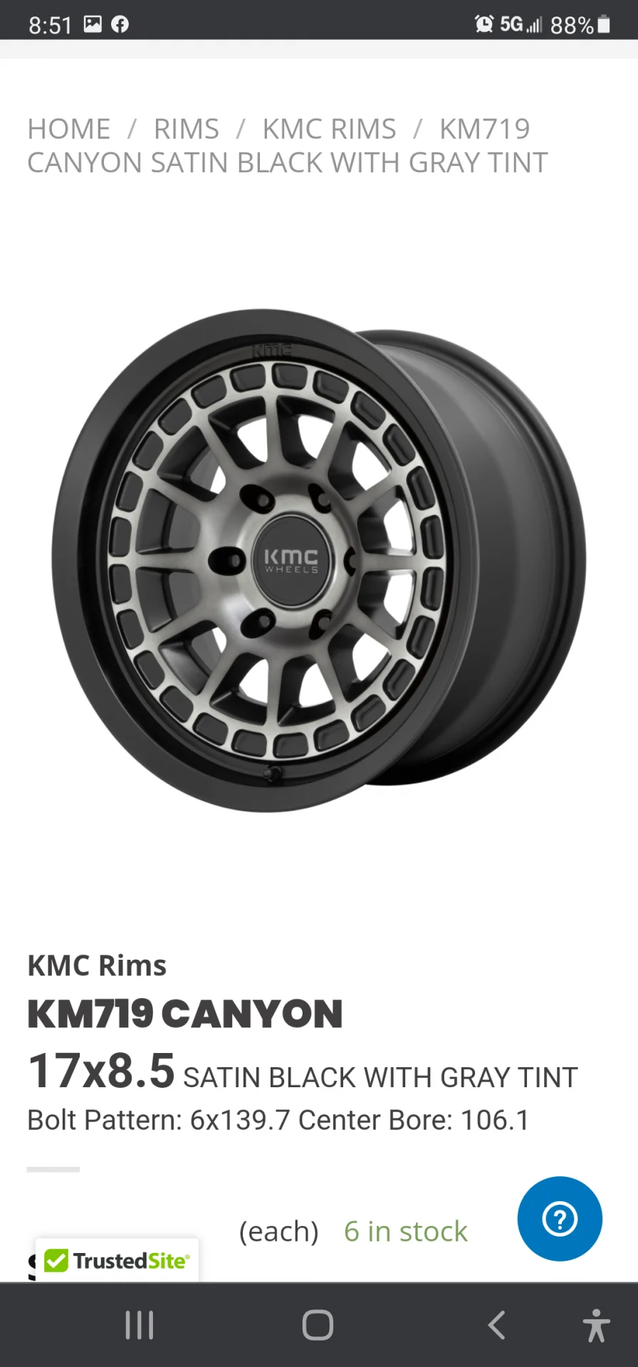

Hello, I like these wheels. Not too flashy and I'd like to pair them with some 35x11.5 if I can find any but these websites say that they don't fit my lx450 and I find it hard to believe.
I don't understand why these websites say they dont fit it even though the bolt pattern, offset, and bore holes are correct.
The only thing I could really think of is that there's a cover for the center bore hole or something.
Please let me know, thanks!
Those appear to be a perfect fit. I recently ordered a set of wheels in the same exact configuration.
There website probably says they don't fit because 80 series only came with 15" & 16" wheels.
They will probably fit just fine. You might just want to call them and check.....
The wheels look nice and should fit less the center cap.

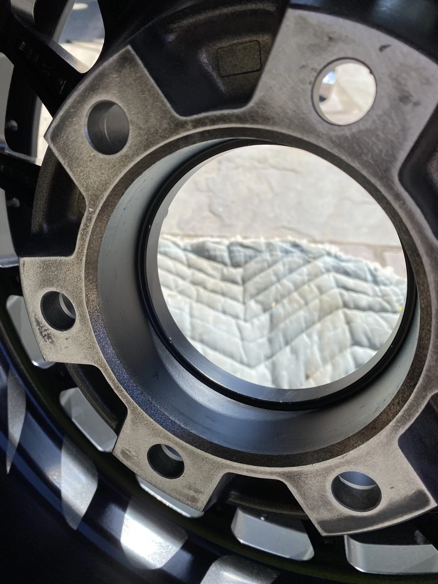

Looking at them, and many many other 6x139.7 rims, you probably have to get them clearanced/bore out some of the center as it is the correct 106mm center, but that 106mm may not go all the way thru to the front surface with of the rim. The 80 axle ends protrude thru the entire center of the rim, unless you run some major wheel spacers.
There’s other small fitment issues that may come up also regarding lug holes/depth etc. On my rim manufacturers site the rims looked like they’d fit but had to get them clearanced once I received them.

Yeah. The offset, and the center cap won't work once they're mounted.
Recommend looking for -12mm offset, 4.25" backspace.
This brings a 33x11.4 right to the edge of the flare.
