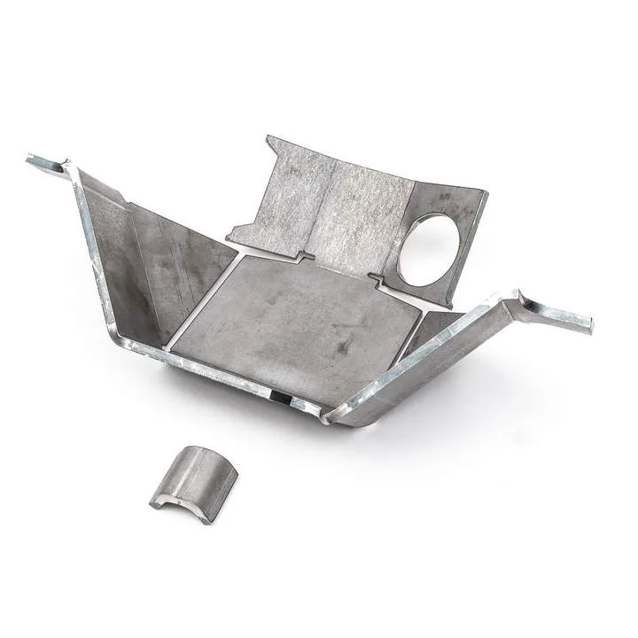

This is the only one I've seen, and it looks to be pick up only.
But it won't work with an OEM electric locker, which I believe most 99 models have.

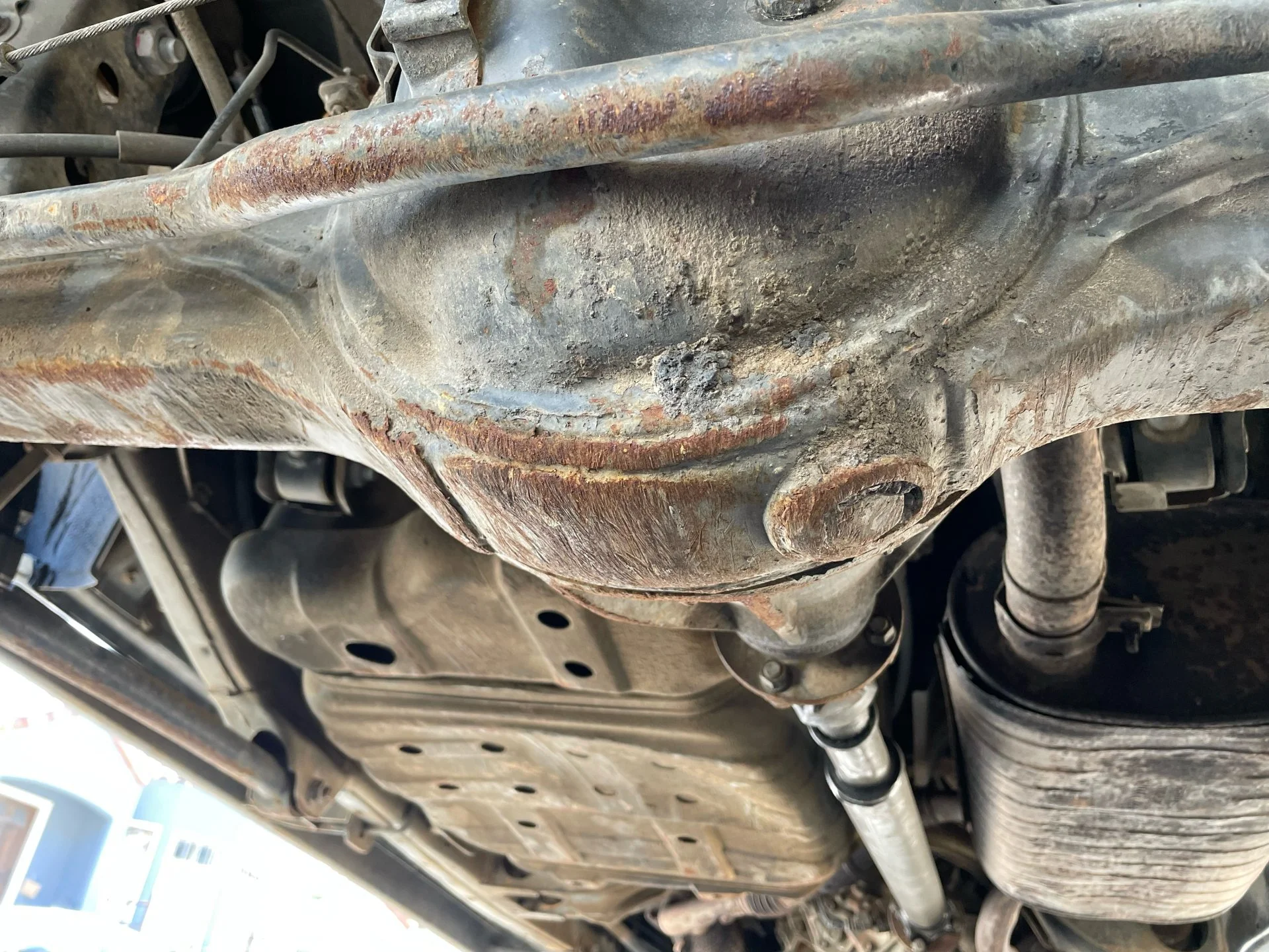

Seems like if you're hitting something hard enough to crack or pierce the diff housing (which is pretty thick cast? steel), a thin skid plate isn't going to save you. If you're just worried about dragging it across something, there's plenty of meat on the housing to not worry about that, in my opinion.
There are plenty of places to beef up a 100. The rear third isn't one of them. Could (and have) dropped the whole truck on the thing with no dramas. Now, adding armor to the relatively thin sheetmetal covering the ring gear...totally different story...though it doesn't sound like you're needing it yet.

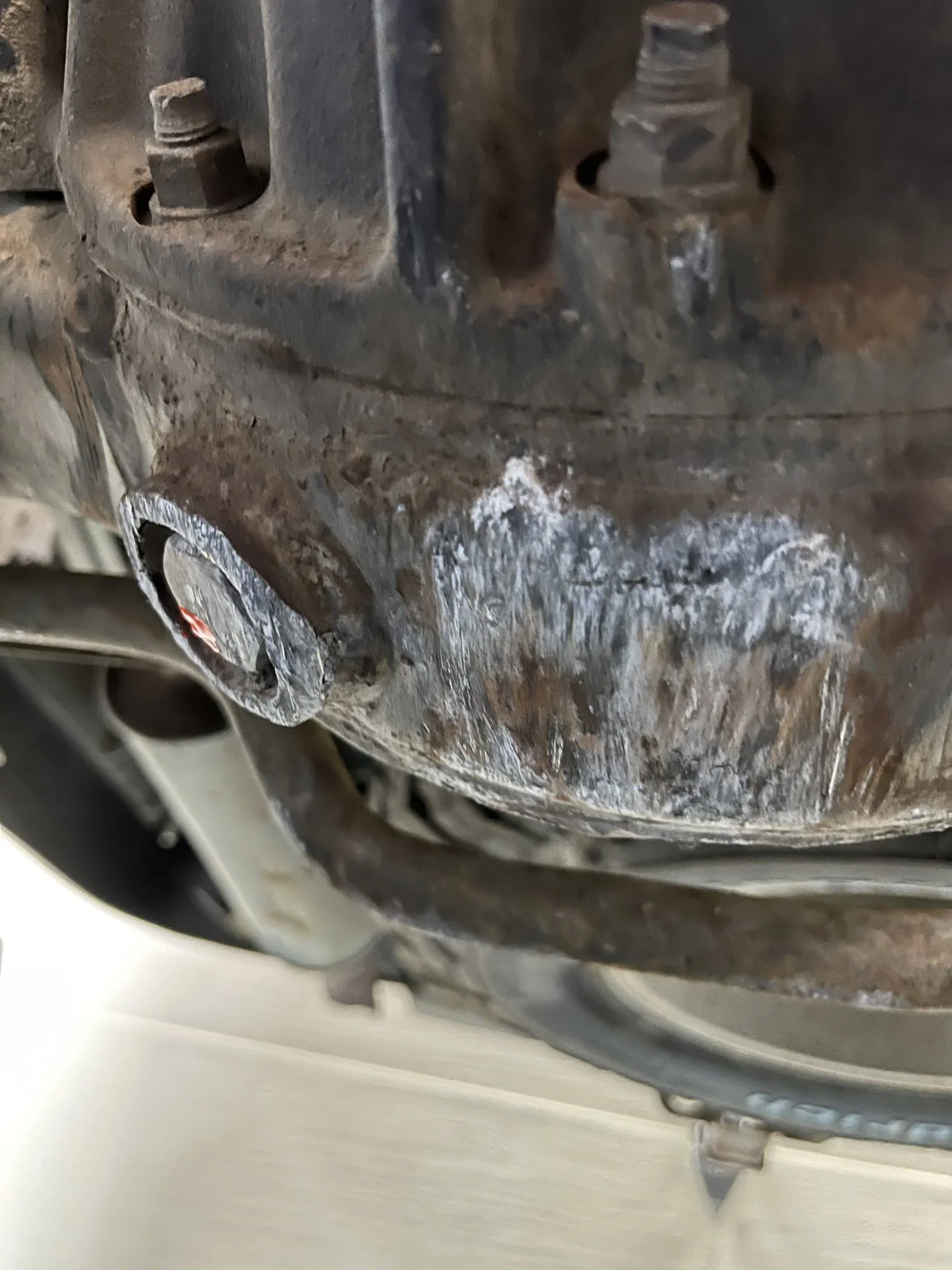

Cracking the housing shouldn’t be a concern but for anyone who runs rocks I can see these benefits: protects the flange, yoke, drain and lower front facing carrier studs that can get rounded off.
That looks sort of promising- I’ve seen a few for 80’s that I thought should fit 100- but they had been inobtanium for 2yrs.
Agreed. I took out a big chunk of my flange on Upper Swimming Hole at Katemcy Rocks.
This one was made by Ballistic for the 80- but NLA

Thanks for all the info and offers to help! Unfortunately none of those fit a 1999 with a rear e locker ….. so looks like I’m out of luck for now.

I've ran those trails and more difficult ones over the years. My rear diff housing is fine. The drain plug takes a bit of work or you can siphon from the filler plug (less desirable but acceptable). The area of concern is the backside of the diff but it's protected by the sway bar.
