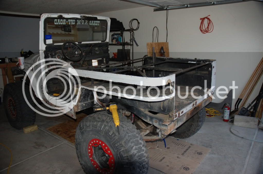

How she sat before the tear down.
First off was to get a cross member under the old girl. The old skid plate doubled as a cross member but it was flimsy. Also took the opportunity to get the belly as flat as possible.

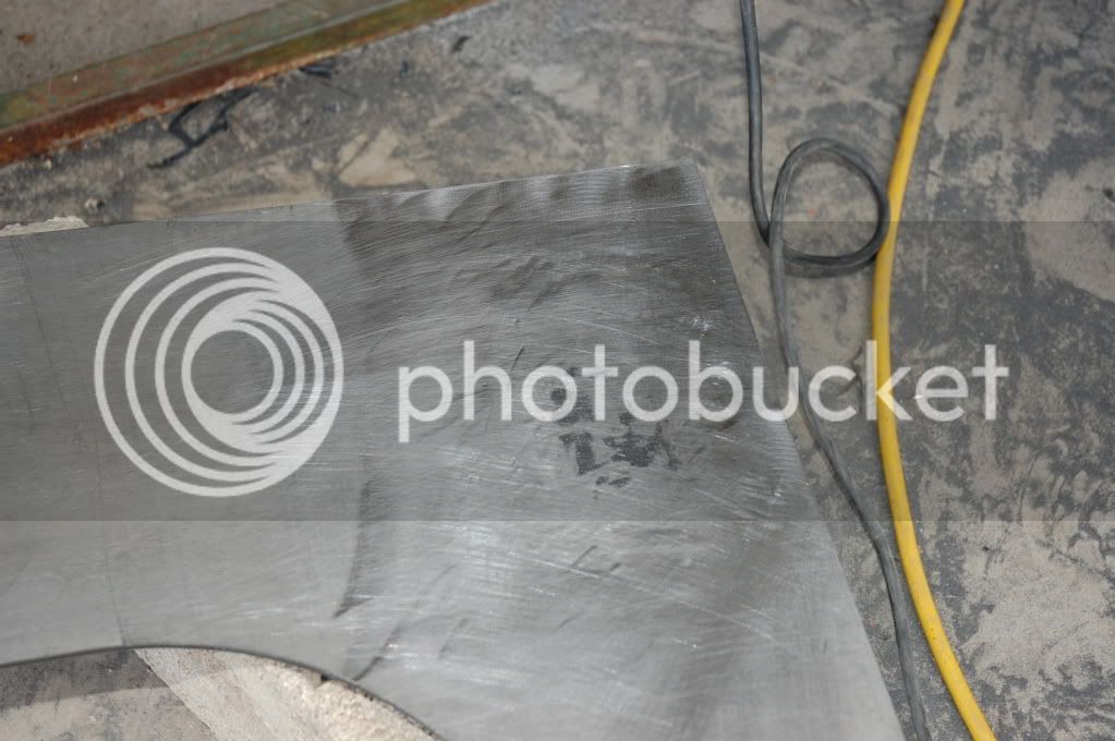

Apparently you can order Bud Built 1/4 panels without the fuel door cutout...oh well :doh:

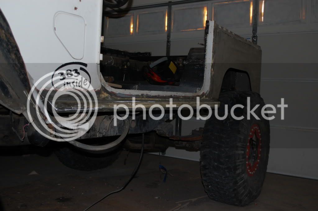

Rear sill and bottom of 1/4 panels were pretty rusted out so that had to go...
dayum!
Had some 4x2 box tubing laying around so it became the new rear sill....I think it'll be strong enough
Has a strip of angle welded slightly below the top for the floor to sit on.

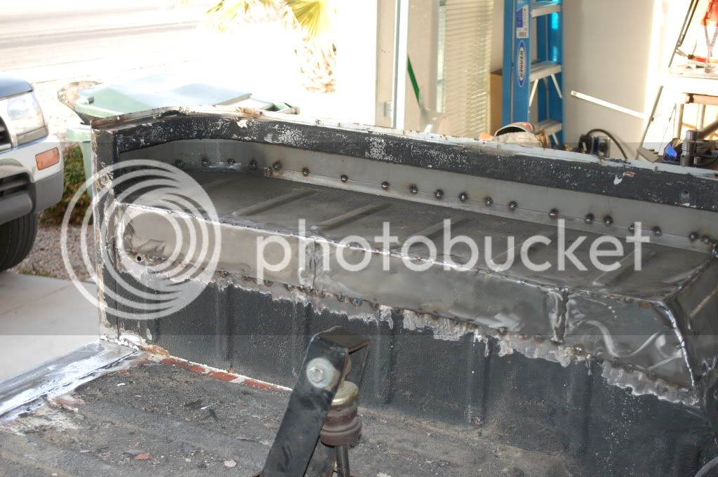

Figured why not raise the inner fender wells while I'm here
Wrapping things up
The tube is going to get bed lined again so I didn't spend too much time cleaning up the work.

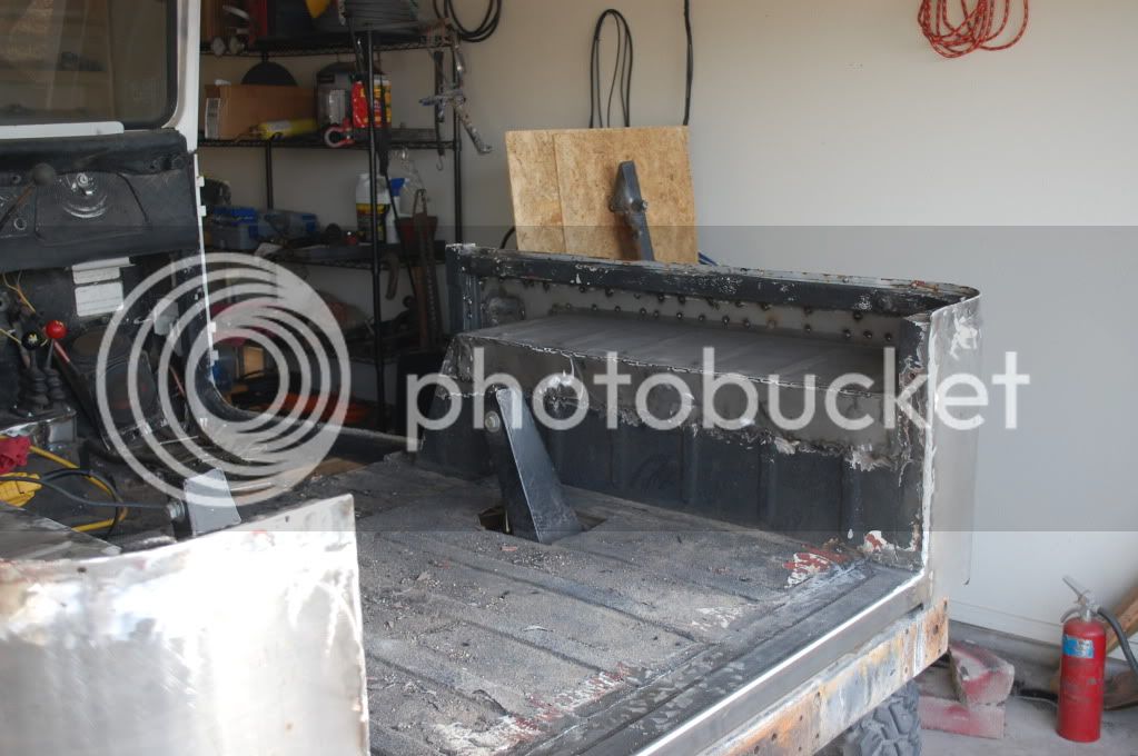

BTW, if you have back problems I suggest you have help with those 1/4 panels. If you don't have back problems, you probably will afterwards...they're beefy :cool:

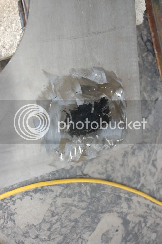

Needed some more clearance in the tranny hump after the tummy tuck. Probably going to cut it in half to make removal easier without having to pull the cage.

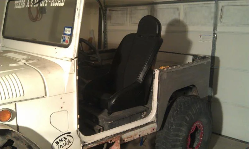

Thanks, I'm 6'4" which is the main reason the old cage/seat combo had to go. I've laid the 40 over a few times but no hard rolls, but the way it was set up before in a hard roll I'm pretty sure I would smack my head.
Picked up a set of PRP comp high backs, they're :grinpimp: Got them 2" taller and they fit me perfect. Way better than the old plastic RCI seats.

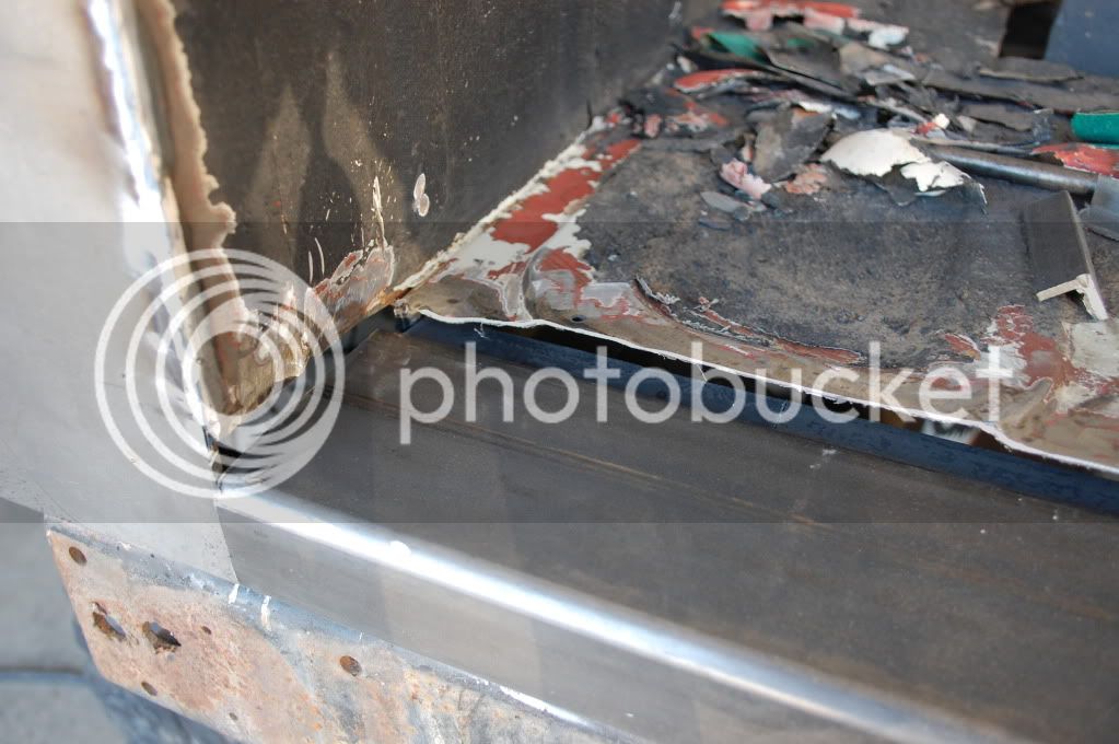

Apparently the drain hole in the bottom of the rockers was plugged and the rockers were starting to rust through. I was going to trim them anyway so I just cut them all the way out, why not

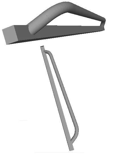

Thinking about welding in a piece of 2" square tubing then having a 1.75" tube kick out coming off that. Something like this maybe

On your sliders,
I suggest adding 2 cross braces between the 2"square, and the 1.75" tube..
I have a very similar style to what you drew, with 1 cross brace. I came down hard on a boulder, and my passenger slider is bent out of whack now.. If I had the second brace it wouldn't have happened.

On your sliders,
Cheers,
There are going to be 2 cross braces, I was just too lazy to throw those into bendtech.
I'm go to wait on building the kickouts till I get around to doing the tube fenders so I can get them the same width.

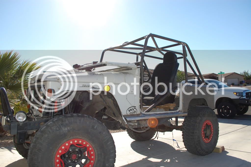

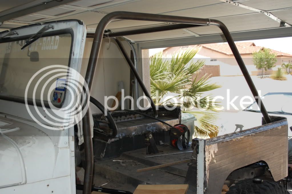

Going to start the on the cage next week. The A pillar will tie into the rocker and frame and then I'll ditch the front body mount since it won't be doing anything but getting in the way. The rocker will be braced to the frame and I'm thinking about skinning it with UHMW.

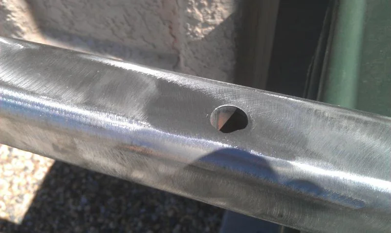

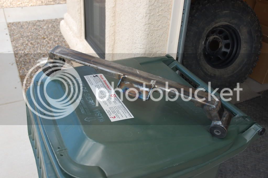

Drilled and welded in a piece of 1/2" tube on each end for a drain. Hopefully keep the rockers from rusting from the inside out again :rolleyes:
Starting to look like a cage. And I've only screwed up one piece Should be able to get a spreader and a gusset or two out of it tho.
