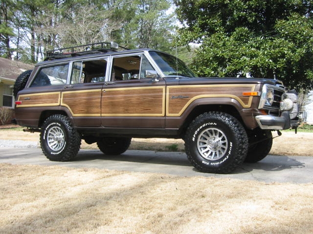

I put an 8274 on a Grand Wagoneer - slotted the factory aluminum bumper to fit over a "sub-bumper" to keep a factory look. It worked on that truck - the scale was right.
