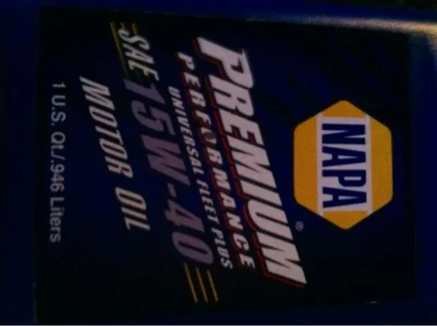

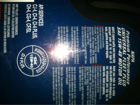

I picked this stuff up at napa a couple of weeks ago. The tech referred to it as the "old formula valvoline diesel oil". If I remember right, two gallons plus a quart cost me around $35.

That's the stuff! But when I was in NAPA a few months ago, the counter dope told me they couldn't get that in Kalifornia - I took him at his word, but the guys at my local NAPA couldn't find an itchy a****** with 12 fingers... But on NAPAs website, I do see two listings for that stuff, one for Kalifornia, so again, I dunno.
Do you happen to have the part # on the receipt - maybe I could get it that way...
I still may have the receipt although I'm out of town until Sunday. If not, I can stop at napa and get the numbers.
Yeah, it would help because they've got a dozen flavors of the "premium blue" one the website and I know the counter guys will be useless, so it'll help to have the info when I go in... . That stuff should be rebranded Valvoline premium Blue Classic oil.

That part # is for the 5 gal buckets, the smallest they sell. That pic is of a gallon jug, yes? That might be some old stock valvoline fleet stuff. :meh:

Spike, is the NAPA oil above only available from NAPA, or is it also available in a Valvoline bottle?
Or just in a 5 gal bucket from Valvoline?
According to Valvoline's site, Valvoline branded only comes in 5 gal bucket or 55 gal drum...
NAPA branded has Quarts and Gallons... Looking at the MSDS for the two oils, from Ashland, they're not exact, but very close. Both would work just fine, I think. The difference could be that either MSDS is be outdated. Hell, I've been know to lapse occasionally on the MSDS's I'm paid to keep up to date :D
Btw, those gallons that Zambo shows are only $9.98/gal on Napa's site. The 5 Gal bucket of Valvoline branded is around $90.
