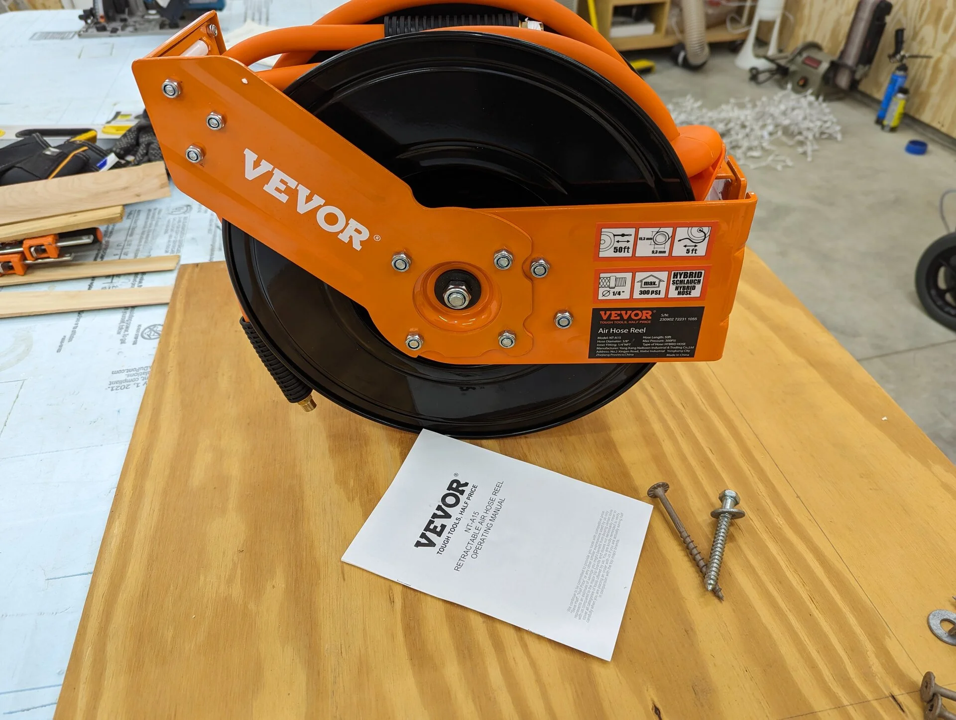

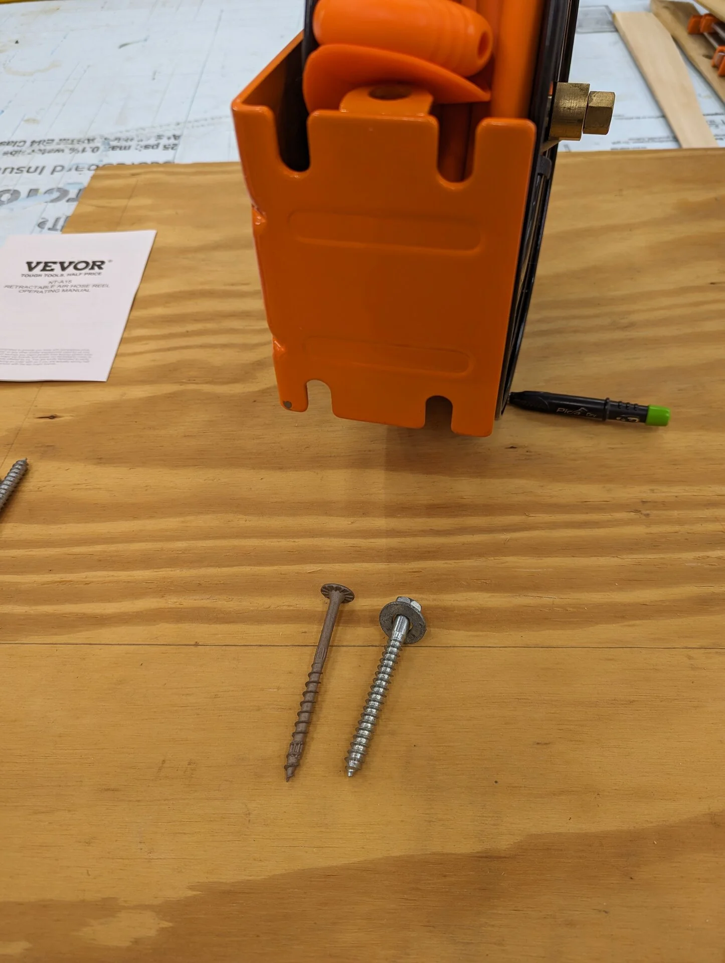

I need to hang a new Vevor air hose reel on the wall in my shop, not sure which type of fastener to use. I have 3/8" x 3-1/2" lag screws with washers, or these new Simpson WS22 x 4” Timber Screws. I have plenty of both. Reel weights 23 lbs but is also subject to being tugged on to deploy the hose. They are going directly into the 2x4 studs.
Not sure which is stronger? WWYD?
classic answer would be the lag bolts, I imagine. Seems like it would have more holding power given the denser and longer thread.

I am using those Simpson flange head screws to hang the birch plywood panels in my shop and I've been very impressed with them. I'm guessing the lag screws are inherently stronger but that doesn't mean they will hold better in the stud. I would try the Simpsons first. If for some reason they don't work you can always throw the lag screw in. Given the relative diameters, I don't think you can sequence that trial the other way around.
FWIW I am only using them because I wanted the look of the exposed shoulder and I am counter-boring the plywood so that the head sits flush. They are definitely pretty strong though.
It looks like you might need larger washer(s) to use either one. In fact, how do you screw those in? Does the reel come apart or is it more accessible than it appears? Maybe you need lag screw studs so that you can use a washer and a nut to attach the reel?
Edit: 4 of either of those will hold way more than that hose reel.
curious about the spacing of those notches in the bracket, that looks like more than 1". Will all the screws fit in one stud? Of course, you can bridge between 2 studs with a board or Unitstrut, and then it does not matter. You could also make a rack with all your air accessories next to the reel, then.

If it's like other reels, the hole/slot is too wide for stud mounting. Maybe 2 or 3 but not 1. The ones I've mounted have gone on steel beams. If going on single studs, install a 2x6 or similar across at least 2 studs to mount on.

The reel can be removed from the mounting bracket for easier installation.

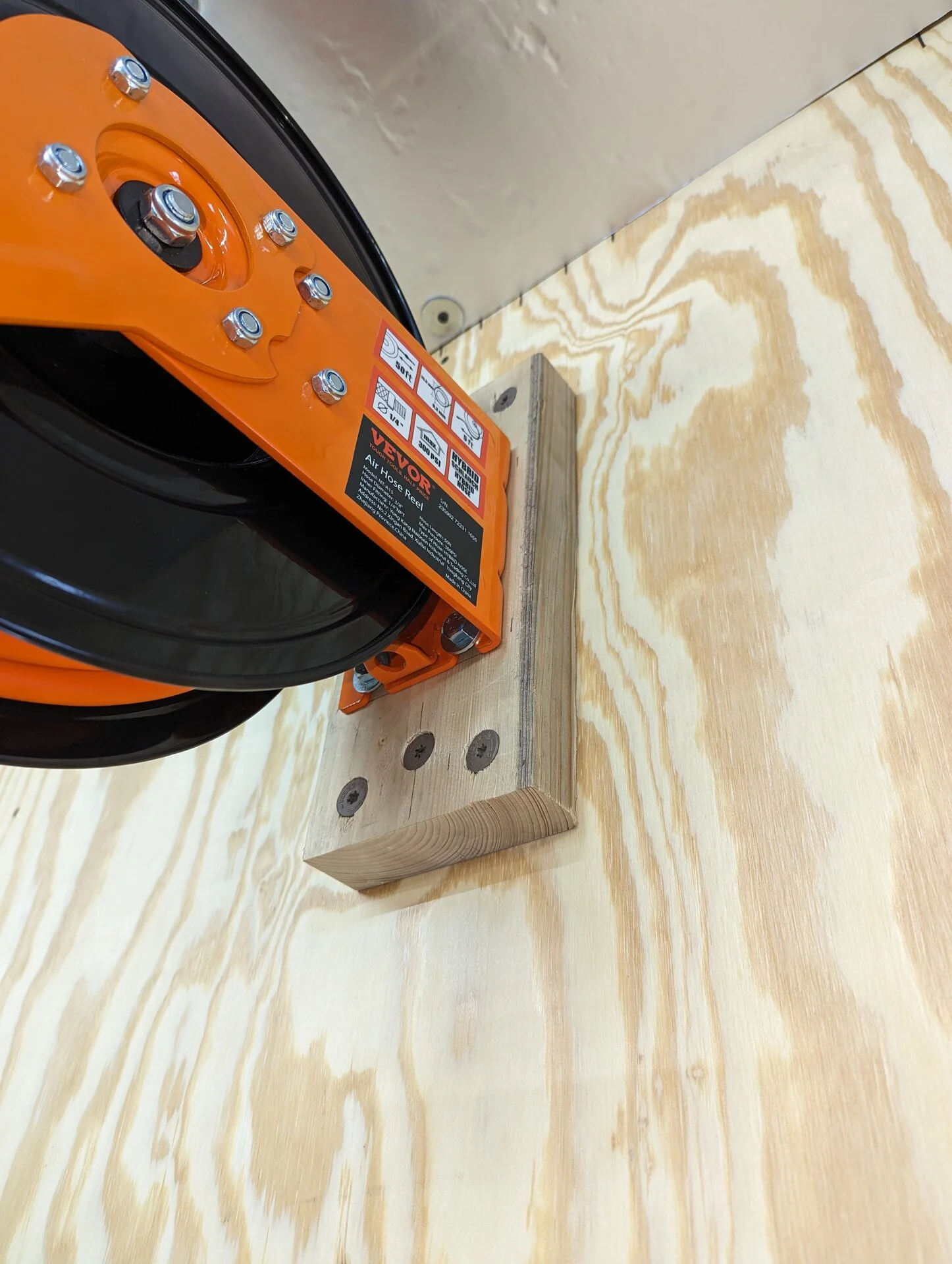

Been meaning to update with what I decided to do, here's what I came up with.
Bolted the base to a scrap of 2x6, using 7/16" bolts and nylon locknuts sunk into the back side. Then I used 5" Simpson SDWS screws to attach this across 3 of the 5 studs in the framing at that spot. Had to use a long extension with the T30 bit to reach them. Yeah, it's not going anywhere. I could probably hang my truck from that thing.
