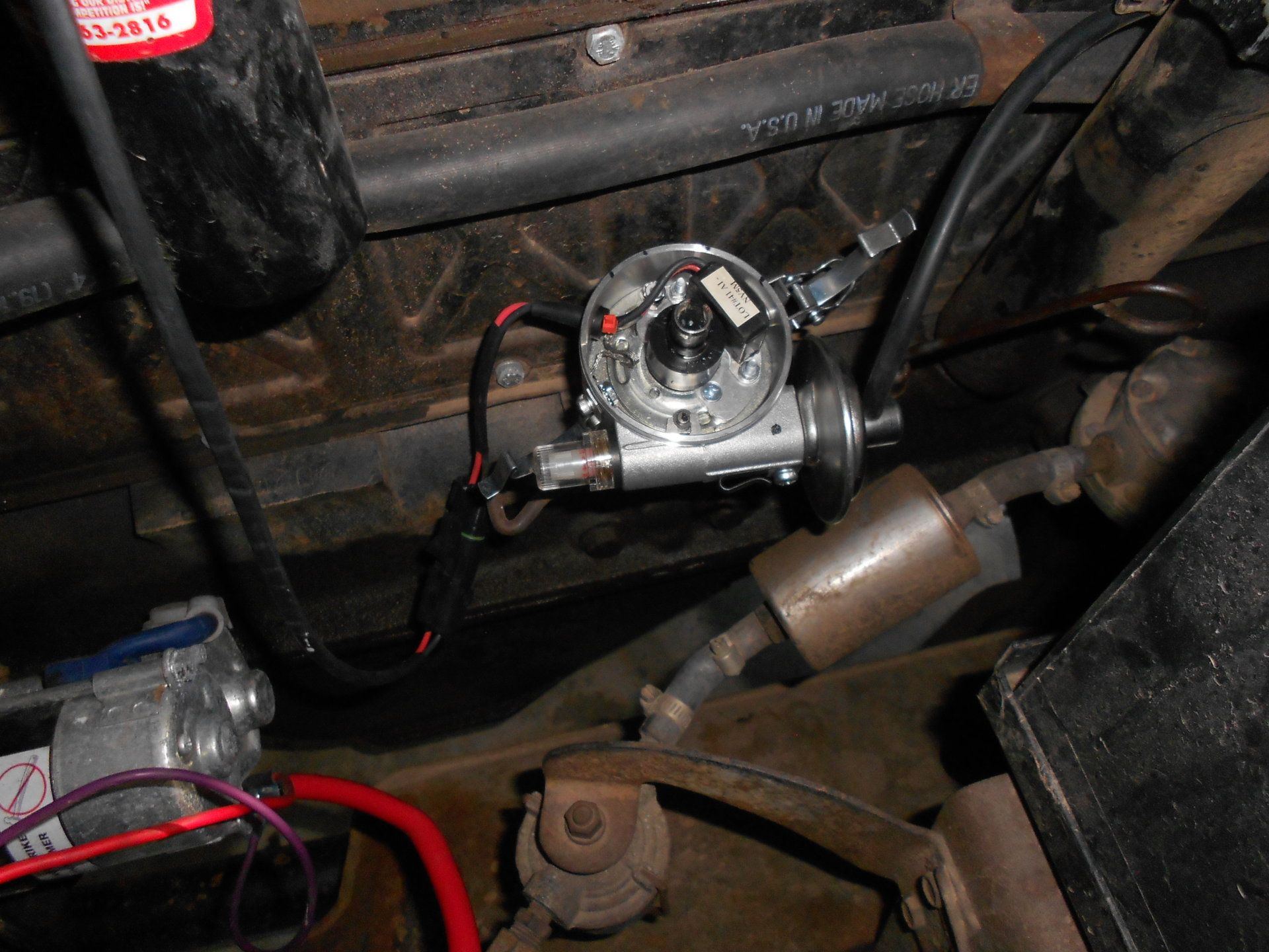

Purchased my dist and electronic ignition from JTO. (I can drive to their shop in about 45 minutes) The dist is a non-USA unit and I am not sure what the electronics are. I had to do some alteration and had Mel's Ignition in Salisbury, NC set it up properly. Cranks easily and none of the points hassle.
