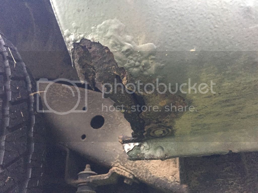

Below Drivers Side Rear Door. Runner Board was covering most of it.

Look at the fuel and brake lines underneath....pass unless you have a lot of patience to replace, or don't mind paying.

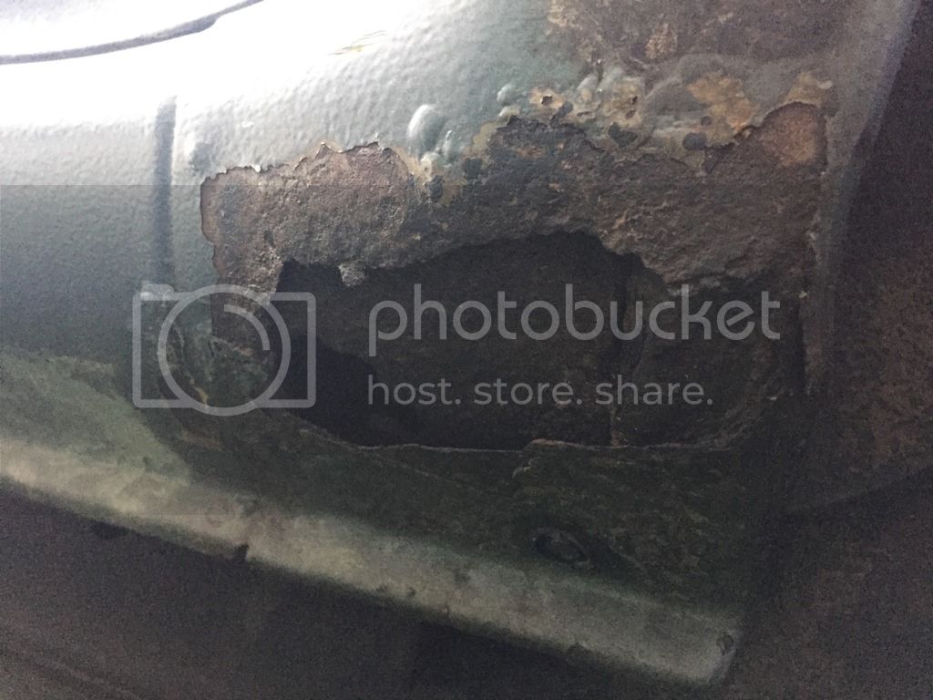

Passenger Side Below Back Door Look how clean frame is, truck lived it's life in NC.
I'm sure this spot trapped salt as truck is mostly rust free elsewhere.
