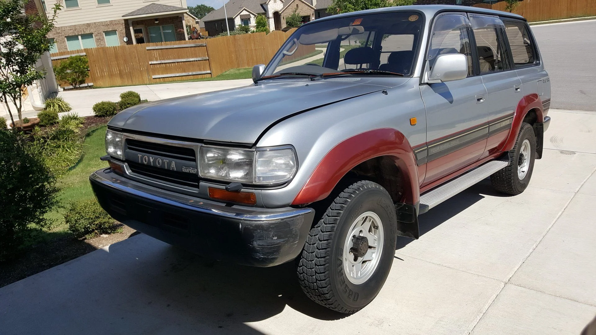

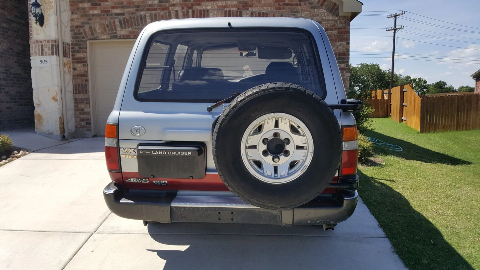

Here it is in basically the condition it arrived straight from off the boat from Japan. Dealing now with a key that wouldn't turn in the ignition so I didn't put up a picture of the inside as the dash is all apart.
