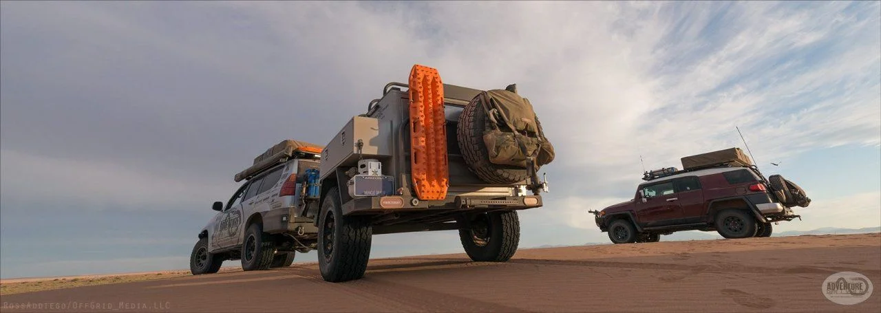

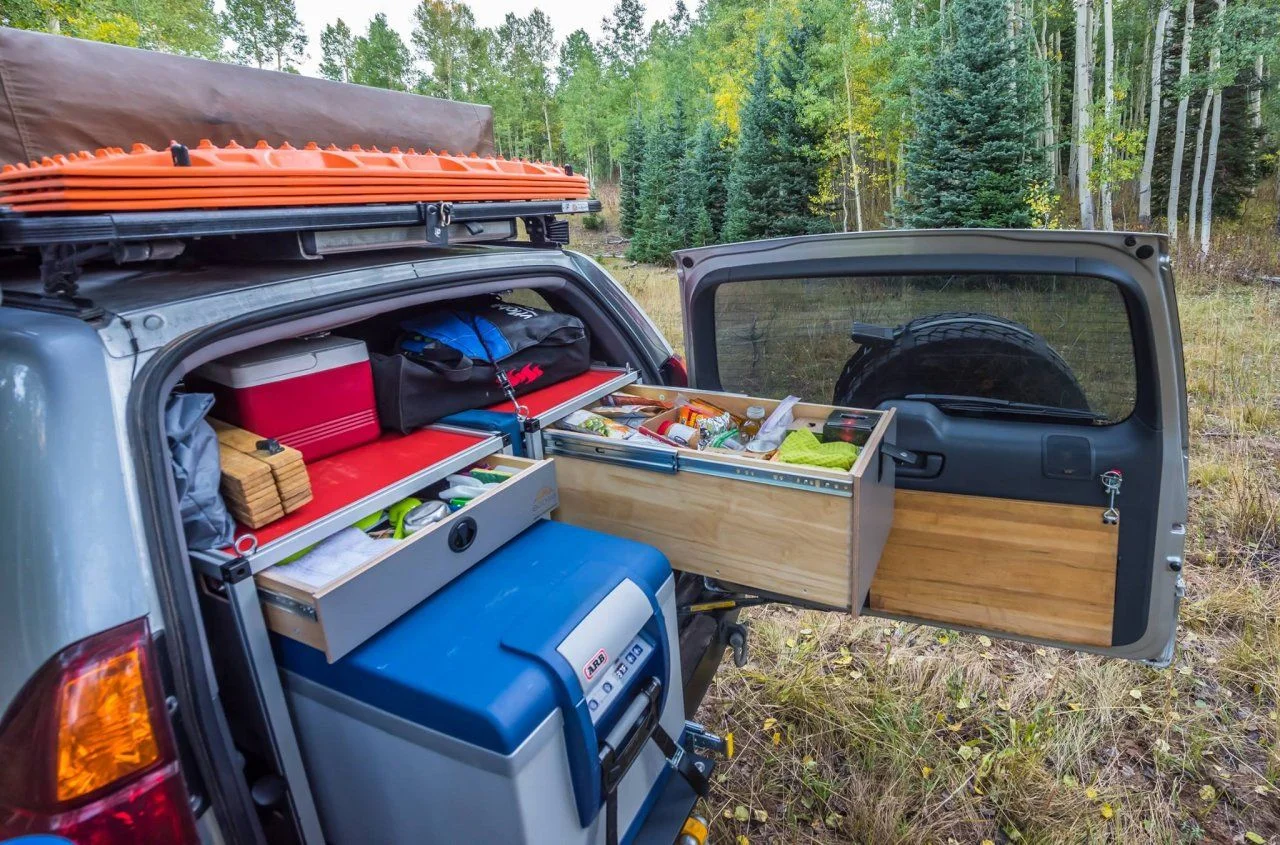

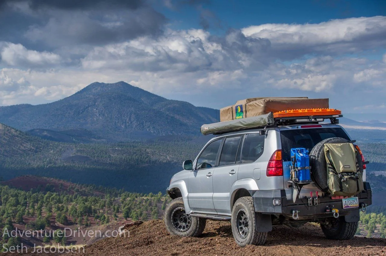

View attachment 1180354 View attachment 1180355 View attachment 1180356
Sorry I just found this post, yea we are very heavy, I don't want to say in print what we weigh :( Lexy does not seam to notice really, we always keep the 20 gallon water tank full where the spare tire used to be and the 5 gallon jerry on back full of fuel. We have HD ARB rear springs and good tires. Our ICON suspension is valved for our weight, we have the I OMEGA by pass all the way around. I installed the ICON pneumatic rear bump stops in rear coils. We also have Nitro gears =4:46 with ARB Air Lockers, I know thats a lot of stuff added but Lexy will motor over 15" rollers at 60 MPH and not get upset. At this point we need a roll cage because she always wants to go faster and bigger, of course we don't always drive like that. :) The brakes are very strong even with our weight, power is great with the new gears. No complaints really. Tuff little Prado 120 :)

Thanks Seth ... point being people shouldn't worry so much about weight
We get 14MPG all loaded up in expo mode
