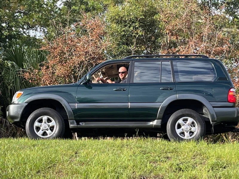

Thanks in advance for responding. I am wanting to upgrade to some aftermarket rims and larger tires on my 02’ LC. Can anyone suggest the best offset and tire size for a LC with a 2” lift?
You can search for that on here and you'll find plenty of info to make a good decision for what works for you.
The lift does not matter, unless you're talking about a body lift. Stock is +60 offset, anywhere in the +25, +35 range is typically good. Method, Icon, and several others make options in 16,17, 18s.
