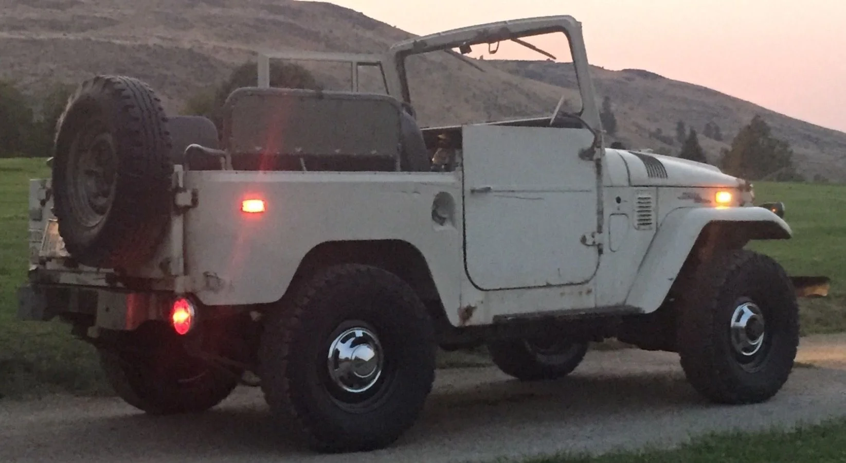

Here’s 30 9.5 R15
I think I took this picture after installing 65swb45’s extra beefy 4” shackles in the front. Still need to tackle the rear.
Guessing I need to add castor shim as Skidplate mentioned.
