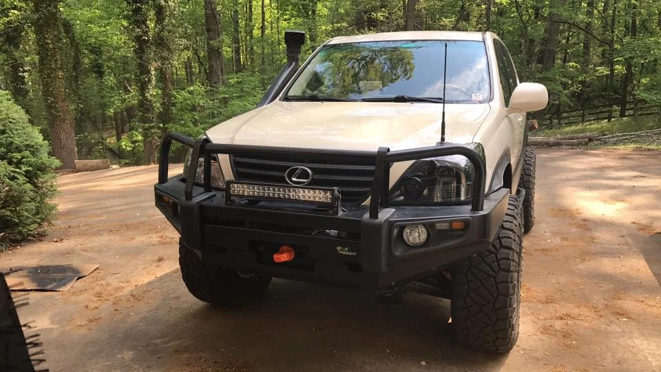

1. I have 0 offset wheels with 35x12.50R17 tires. 12.50 with that offset makes for a nice wide stance. More work to be done to make that wide a tire fit in terms of BMC, etc. 35s take a lot more :)
2. I have BPS G8 LEDs and they are white and very bright. They sell lows and highs. I also had my headlights blacked out and it stops the scatter and the beam is much better.

BTW, that stance looks great.
I bought almost all the LEDs available and tried them. There was a LOT of testing with folks on GXOR and we came up with the G8s.
I got both high and low. The bumper came with fog halogens and I like the light temp so I left them.
