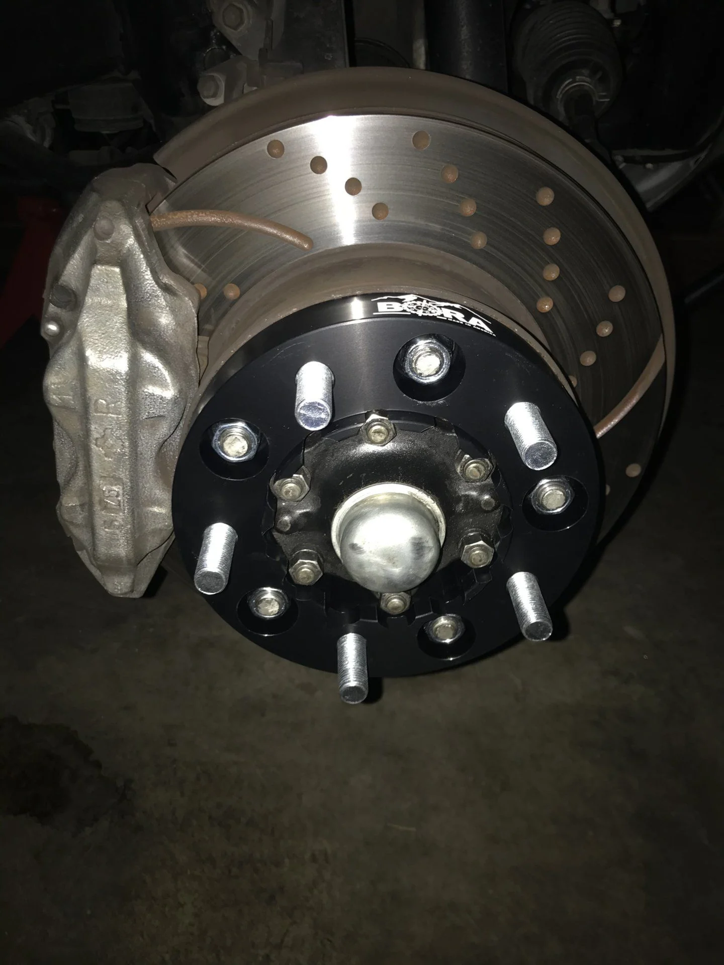

For reference, I'm running RW wheels and BORA 1" spacers without issue. The part on the wheel that mates with the hub is hollow (see link). OE studs are longer and will stick past the spacer itself, but the stud will sit in the hollow area of the wheel.
The only concern with going to a 3/4" spacer is how much clearance there is for the hub cap. The 1" spacer is pretty close, not sure if 3/4" will clear without massaging the dust cap.

I have the Slee (made by Spidertrax) 1.25" set. @geanes pic above is an accurate look at how they fit. Stick with Spidertrax or Bora spacers. This is not a mod you want to cheap out on.

You do not have to trim the lugs, factory spec is what I used at 97 ft.lbs, no locktite needed, just re-torque after 50 miles or so. The spidertrax Slee spacers are the same as the Boras as far as the machining.

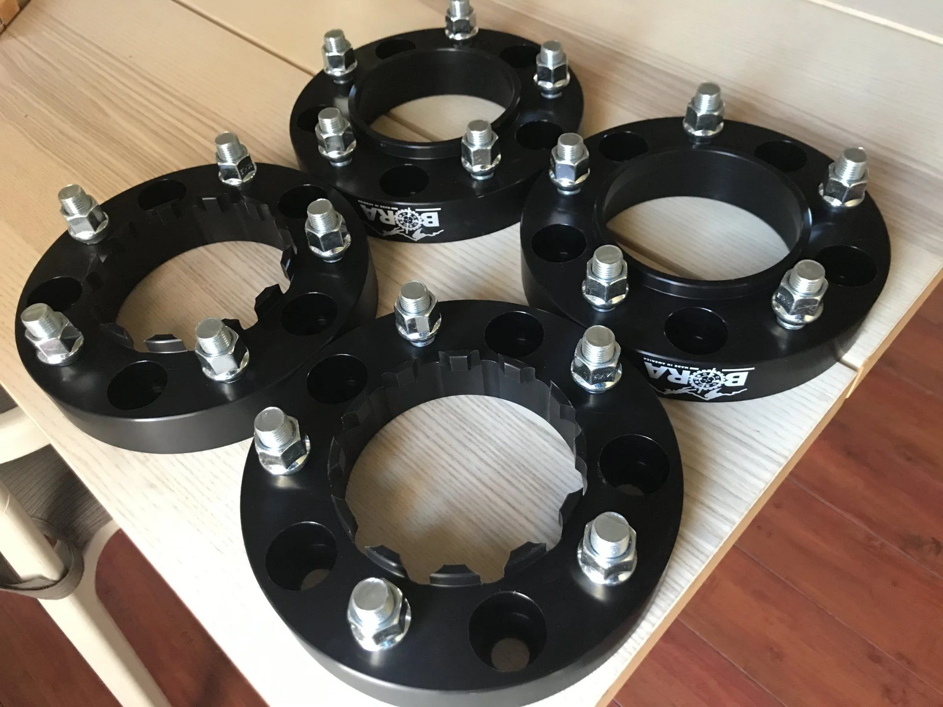

These are 1.25” BORA alum wheel spacers specific for UZJ100 or Lx470 to clear the nuts on fhe plate -yes it cleared 100%.
I still used red (permanent) loctite thread locker and was @115 lbs ft on the 1/2 torque wrench.

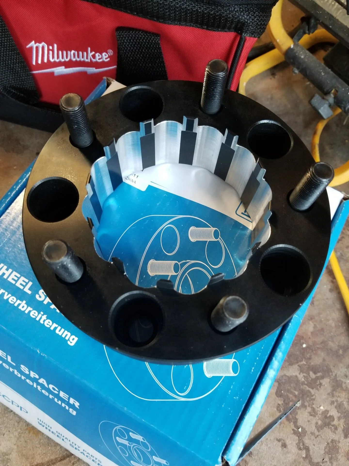

I have 2" Tundra spacers from Amazon ($100), machined out front ones to fit hub bolts. I'm a mechanical engineer so I drew it up in Solidworks and had them machined at work. You can see where the machining was done as there is no black anodize on that area. Running 35s on Tundra 20" wheels. I also ran them with the stock 16" with 33s. I have 1.5" lift, 1" body lift, front pinch weld mod (and a little more lol), dremel cut front LX470 bumper for clearance.. Took it to Baja last August no problems off roading.

I'm sure Slee is a great company, but they resell SpiderTrax, also a great company...hence the markup. I bought directly from Bora, and got exactly what I ordered, no problems...the cutouts for the front hubs are a nice piece of machining. For the front, I spent the higher price for 1.25" spacers, but the rear are same as a Tundra, and I'm running Tundra wheels, and just picked up some black aluminums elsewhere. Haven't put the rears on yet.
