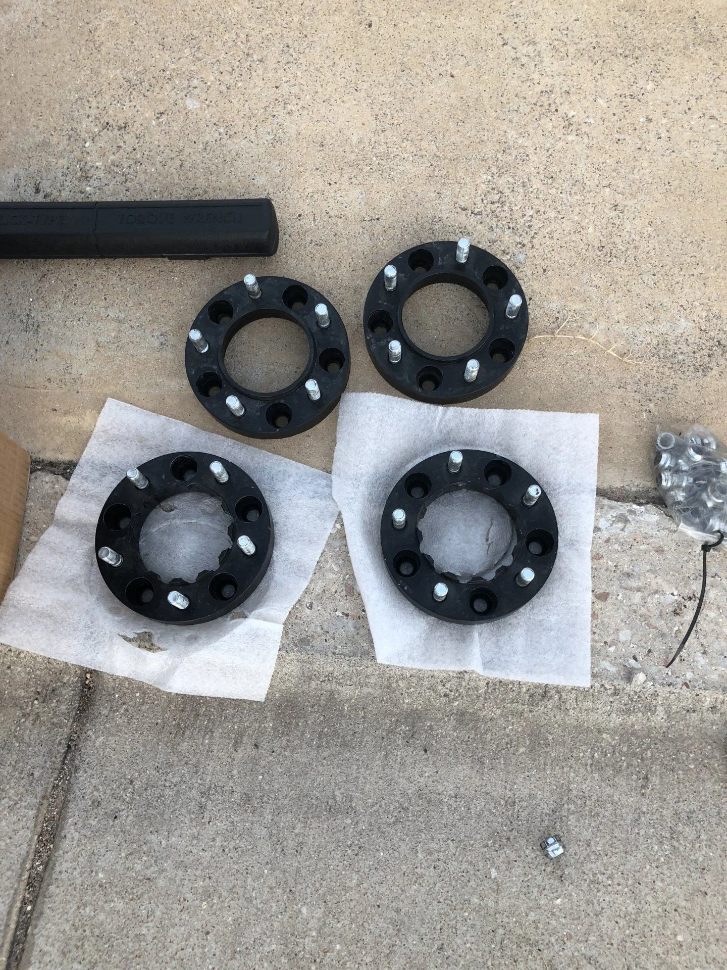

Those don't look right. They look like rear spacers. The front spacers have "teeth" or indents to allow for the hub bolts. Front spacers can only be oriented one way. Get them from the source......Wheel Adapters, Wheel Spacers, Hub Rings for your car! | Motorsport Tech
If you look closely at the attached image, you'll notice that the spacers on the right (front spacers) have indents/teeth. These are my BORA spacers btw. Already spoken for though.

You're very welcome. The BORA spacers are top-notch. Super quality construction. You have to be deliberate and careful when mounting the front wheels as it's easy to pinch one of the teeth off if you get to quick. Take your time and tighten each lug slowly and go through the cross-rotation multiple times and you'll be fine.
If you look closely at the attached image, you'll notice that the spacers on the bottom (front spacers) have indents/teeth. These are my BORA spacers btw. Already spoken for though.

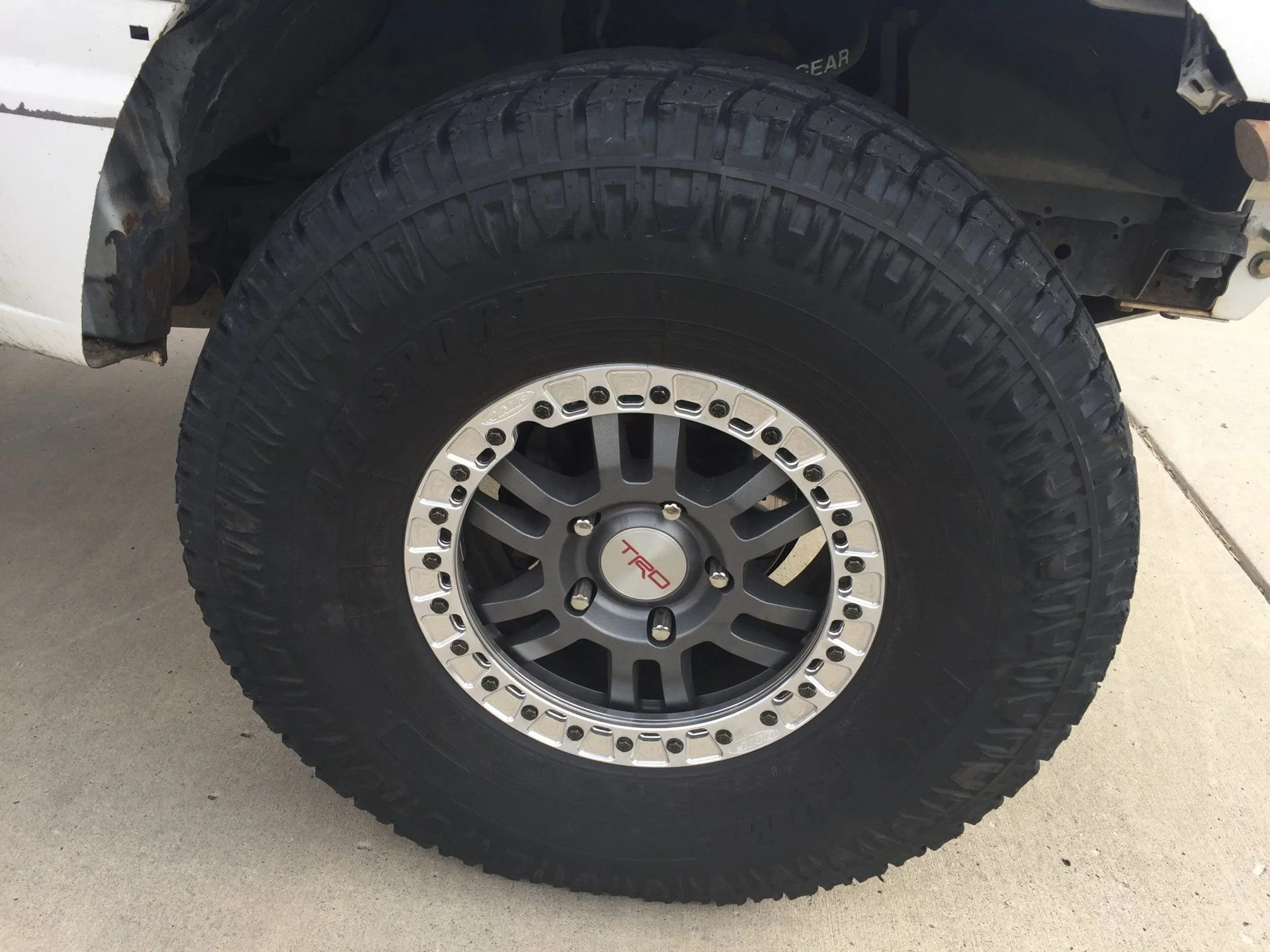

As far as a functional advantage, I was always felt the least amount of spacer meant the least amount of scrub steer and increased swing of the outer edge of the tire into conflicting sheet metal. I haven't made the spacer choice on looks but rather function for myself.
When I bumped up to the 37's on my RW wheels, the 3/4" fit fine still. Although, now I want 40's so :hmm:.
I never put a center cap on but...
...I just ran out and tried putting a cap on one front wheel and it fits fine. It did make make a little plastic snapping sound when I put it on so there may be a tab broken in there now but its secure and I can flex the center in just a little so I know it's not bottomed out on the hub cap thing.
...and I'm not sure how to get it off now without removing the wheel :confused:
@MTKID I LOVE those OMF rings! Did you have to send the wheel in to get those fitted, or were they bolt on since the Rock Warrior ring is removable?
Thanks for confirming the 3/4" spacer fits with the caps. I may just run down to Vato Zone and pick up some 10mm spacers and run the wheels without caps while I order a set of BORAs in 3/4".
