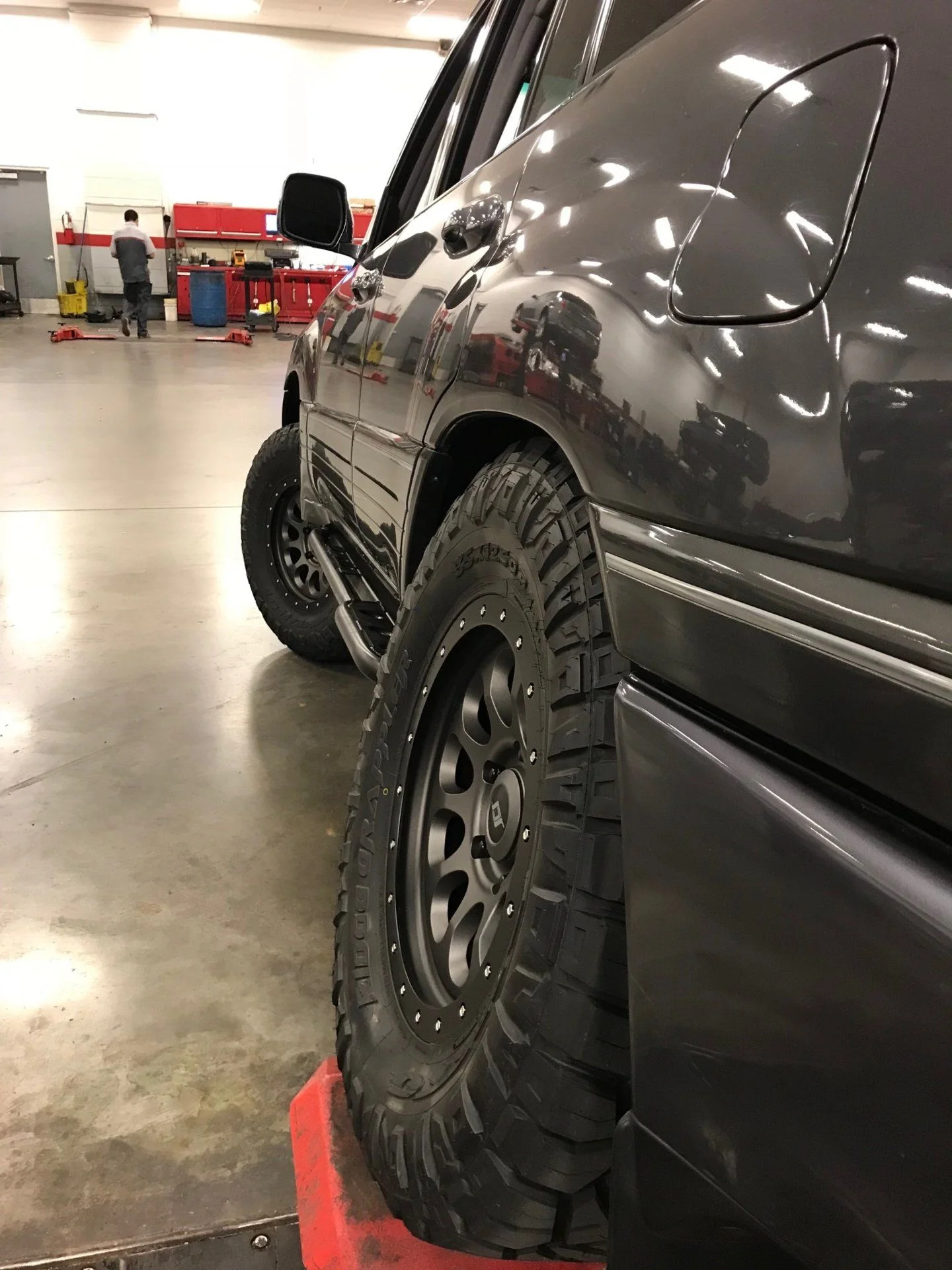

I just finished fitting these. 18x9 SCS Ray10's wrapped in 35x12.5 Nitto Ridge Grapplers. The wheels where not a bolt on go type install. The fronts required some minor modification so they sat flush again the hub. The body, sliders, and shock reservoir mounts took a bit more work to keep it from rubbing under flex. I still need to modify the front center caps but overall I'm happy with the look.

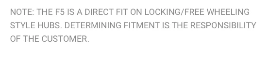

SCS claims all of their wheels but the F5 will not fit on a LC or locking hubs.
Disclaimer on BR6, RAY10, STEALTH6, SR8
Disclaimer for F5

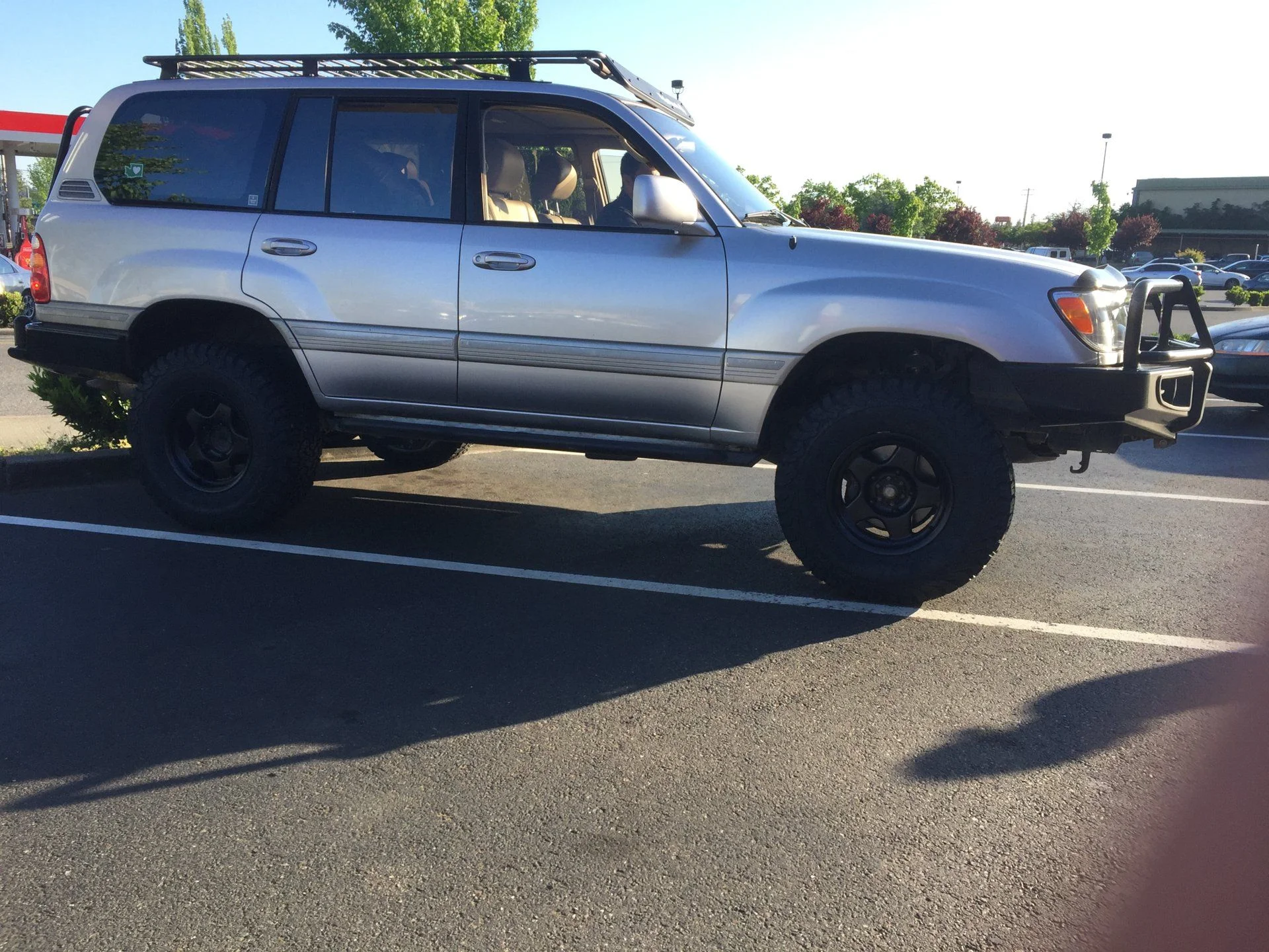

What size F5's? What size/dimension KO2's? Lift height?
In the past F5s only came in 16 - there are talks of 17 and 18s in the future but right now all 5x150 F5s are 16”
Tires are 295/75r16
Lift at the time was OME 865 about 1.5”

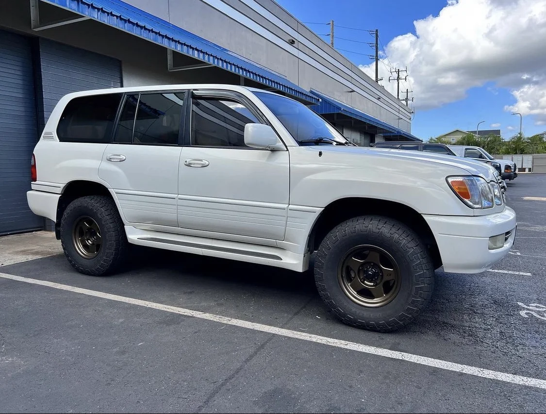

Really like these. What brand are they?
I just saw a SCS wheel drop posted on Tacoma World. If someone is interested in SCS F5 wheels, this would be a good time to check.
Appreciate it!
Alpha Equipt Wheels
