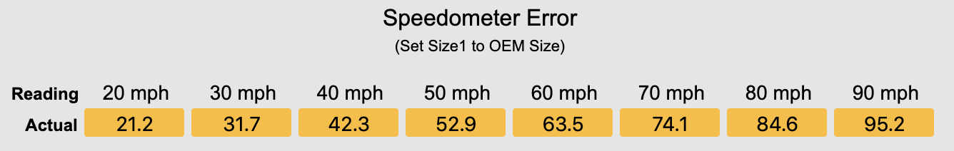

I wonder how much that affects your mpg. Going from a 275/60/18 to a 285/75/16 results in this change using tiresizecalculator.com:

yes Mine dropped . I am getting an average of 11.5 Now,, before I Think I got like 13
Compared to stock wheels and stock tires size? I’ve lost 1-2 mpg
