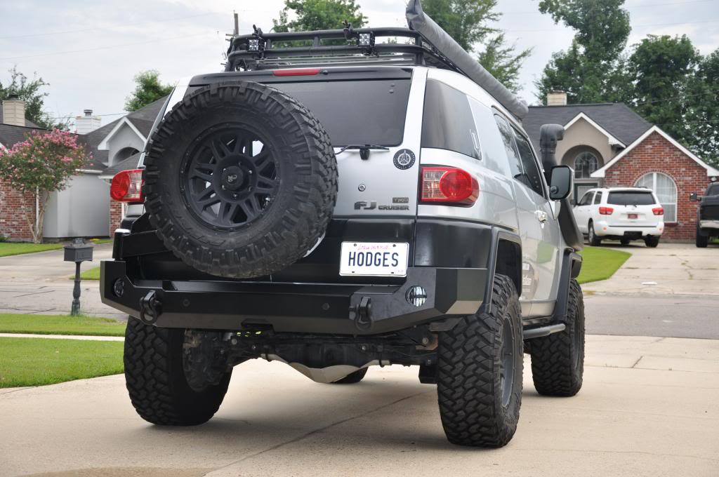

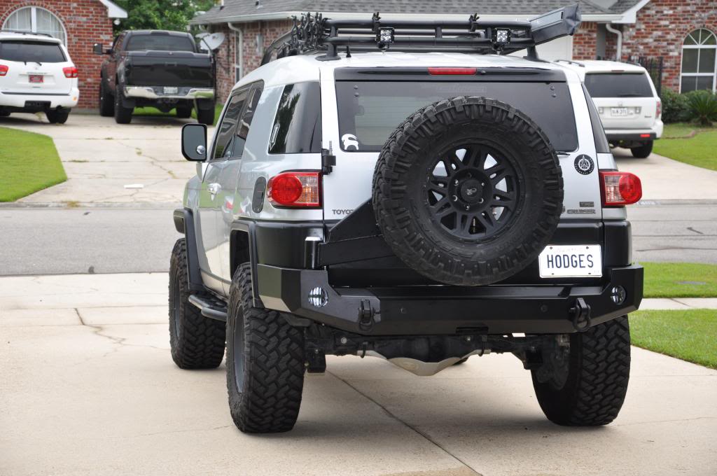

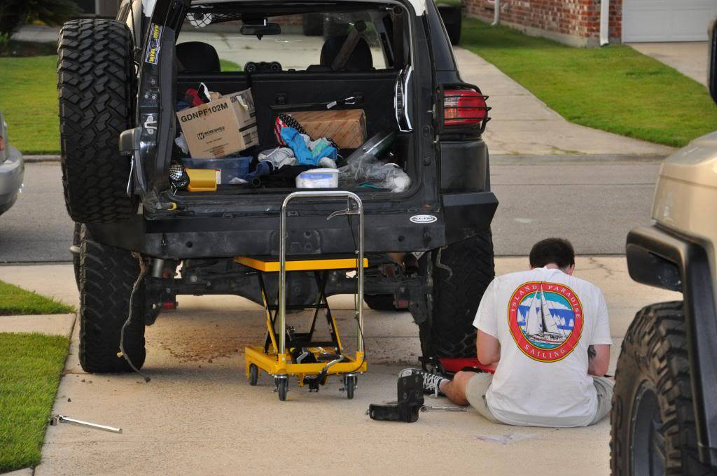

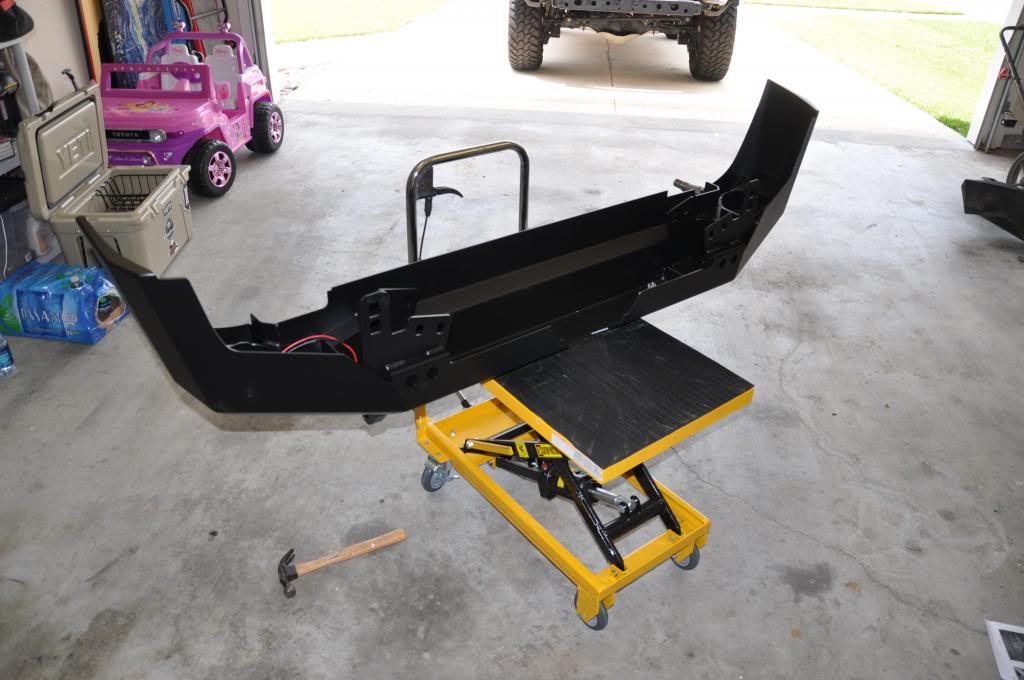

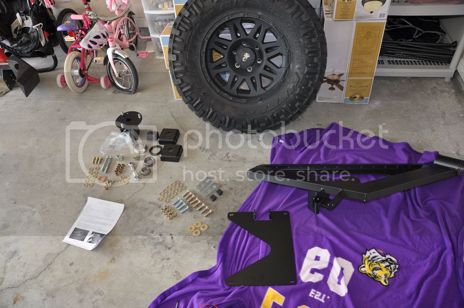

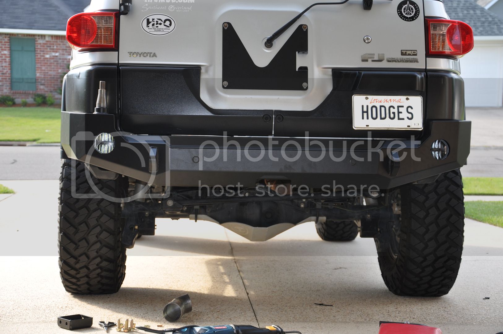

replaced my ALL PRO rear with the Expedition One swing-out. Installed everything yesterday including putting the all pro on Brad's rig. Putting the Lights in the bumper was PITA (it took us 4 hours to figure out how to mount 2 lights) but we made a bracket that works perfectly. the lights in the bumper are Hella Optilux LEDs. I had to saw off a foot or so from my all pro high clearance exhaust to make it work with the ex one bumper mounts, and i bought a turn-down exhaust tip that i put on the end after i sawed it off. the bumper/swing-out were extremely easy to mount. i think the bumper took and hour to mount, and the swing out was around an hour too. i really love the quality of this bumper and how well it fits on the FJ. much better than the ALL PRO. and i have beefy shackle mounts finally. also ordered an L-bracket, another 2 gal gas container, and a locking extension from Rotopax that will be mounted to the swingout arm.
Brad working on the all pro
Looks great Jason. Now you don't have to worry about those side pulls on the rear shackles any longer......:lol:
And 4 hours to mount 2 lights?? Did ya'll ever get to that :doh: moment where it all just came together?
yes we did. we tried about 10 different mounting options, none of them worked (we thought) we ended up trying option #2 again after 4 hours, and it worked perfectly. :doh:

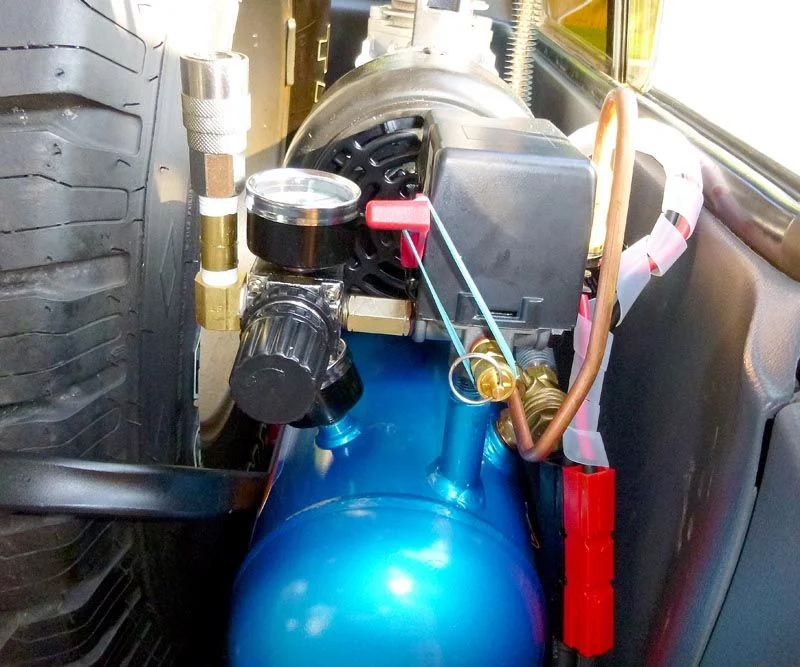

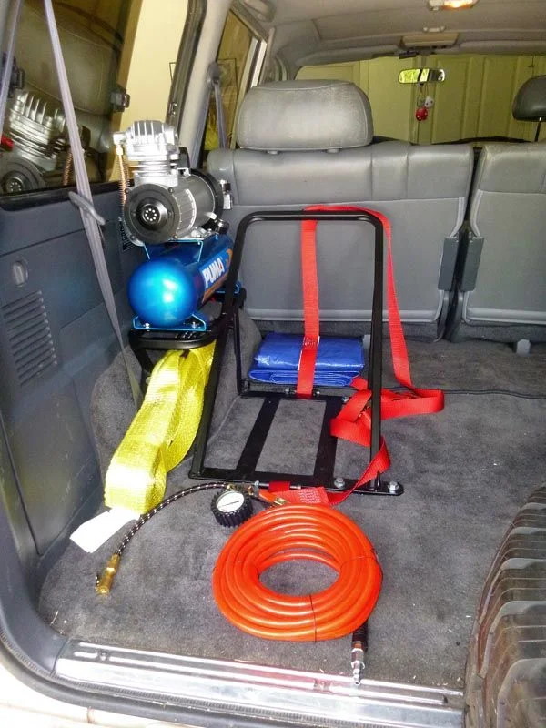

So, while Claudia is away, a little progress on the '80...
Waiting for a 90° fitting to mount the air chuck for access thru the rear sliding window.
Nice setup
It's the tire carrier / compressor mount made by ToolsRUs in AZ. Power is from a 6g cable fused with 60A near the battery. I'm mulling over whether I want (need?) a rack for one water and one fuel can, rather than just using the mounts for the 3rd row seats.

And I got the brass fittings for the air chuck.
Plus, see my anti-autoengage device for the compressor... :)
It's easy to kick that lever over, BTDT on the K5. Nothing worse than the compressor suddenly kicking on while you're on the highway at night...
