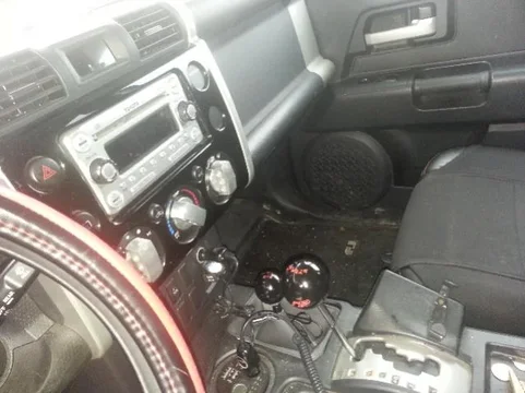

It was one of the hardest mod I've done toy fj.if I could only keep the new shifter knob from twisting!
You need a nut underneath the knob to keep it from twisting.......and you need to cut down the shifter so it doesn't look funny and have all that thread showing. They do look cool, though. :D
I got the nut, but It just twits with the knob. I my suppose to put locktite on the nut, let dry than put the knob so it stops where I want it? I'm not cutting, since I like the way it looks and its a comfort thing I just needed to stop where I want it.
remove knob install lock nut till it hits the bottom of the thread --- measure up appx 1" cut off the upper portion---clean the cut area or run the lock nut up & off it will clean the tread re install the lock nut install knob to the desired position tighten lock nut back up to the knob tu fin .
if you like the length don`t like the threads showing cut a length of stainless tubing 3/8" or 1/2" slide in on then nut & knob:)
