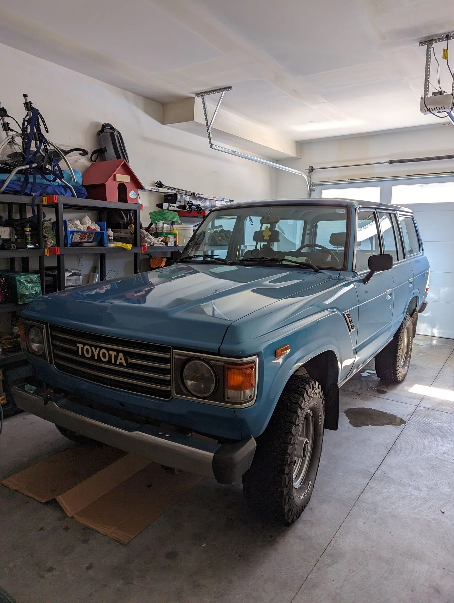

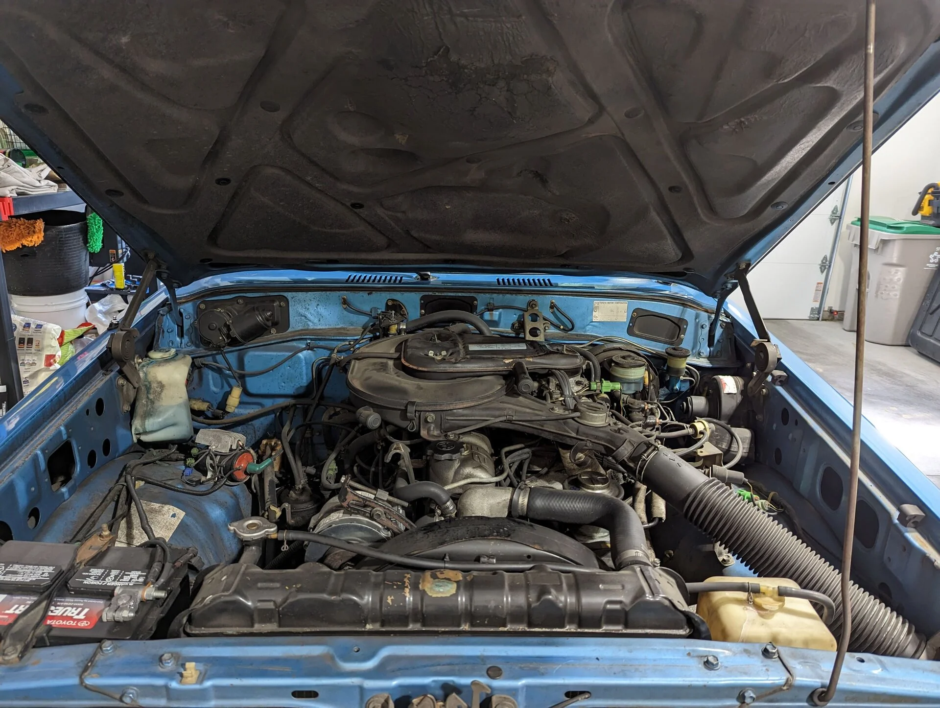

Looking good there. What's the intended use and how many miles on the engine? Oil leaks look minimal. Wheels don't look bad. Please don't ditch them for some ugly aftermarkets.
If it's healthy besides the HG, perhaps you could turn it into a 2FE using FJ62 parts. This would add a few HP while keeping it simple, mostly stock and relatively cheap.

I personally would not sink too much money into a tired 2F. You won't be gaining much from "tweaking" it. The FZ-FE swap would be sweet, but is it practical and cost effective compared to the V-8 suggestion? Not unless you can source a decent, used engine for a good price.

Thanks for all the advice! I hadn't considered the 5 speed option. I'll add that to my list to consider. I am partial to keeping the 2F. I know the matching numbers thing doesn't really matter, but I like the originality of it. It's my daily. Mostly city, occasional highway. I treat it more like a classic car than an off road vehicle. :D Plans are to keep it fairly stock, and keep fixing it up. Though I do drool over the mods I see you guys doing here.
Planning to do the work myself. Sounds like head gasket is the first order of business.
