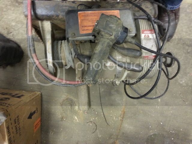

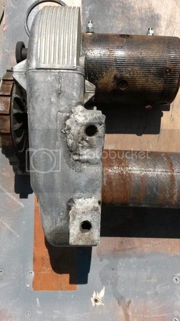

A lot really depends on how and how often you intend to use it. If you are winching yourself, or others, out of 'situations' every time you go wheeling: Go Warn or Ramsey. My preference is the 8274 (I own two of them):
NOS:
POS (being rebuilt):
