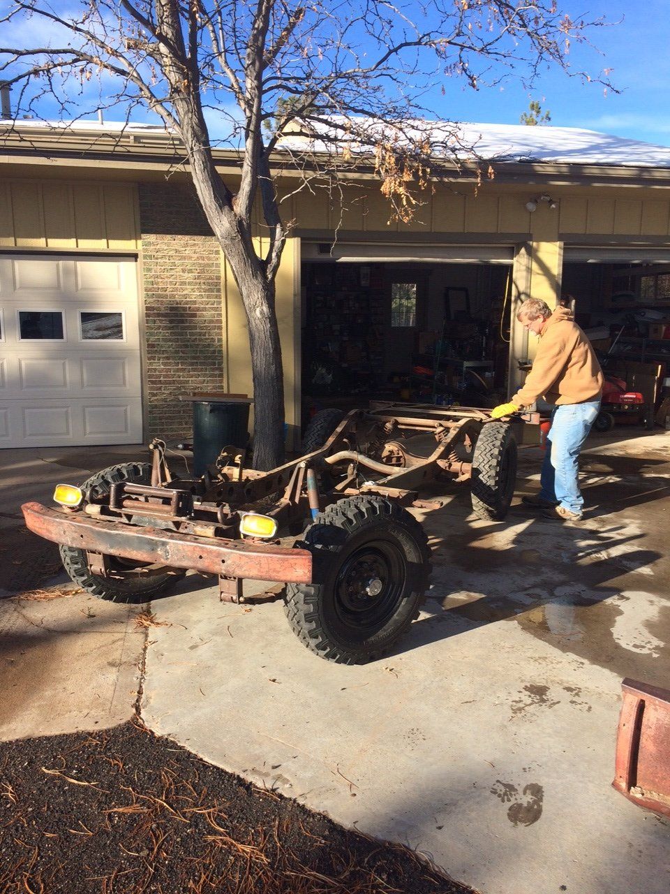

Down to the frame!
Notice the rear shock, never seen coil over "like" shocks before.
I am next going to work on getting my axles all set up. I would love to stay all stock, but the cylinders are leaky and or locked up. I have a set of F60 axles I think I will use the front discs from. I just need to find a front 40 housing, inner short side axle shaft and a good rear axle and I'll be set. Could be a while until the next update, but I hope not.
