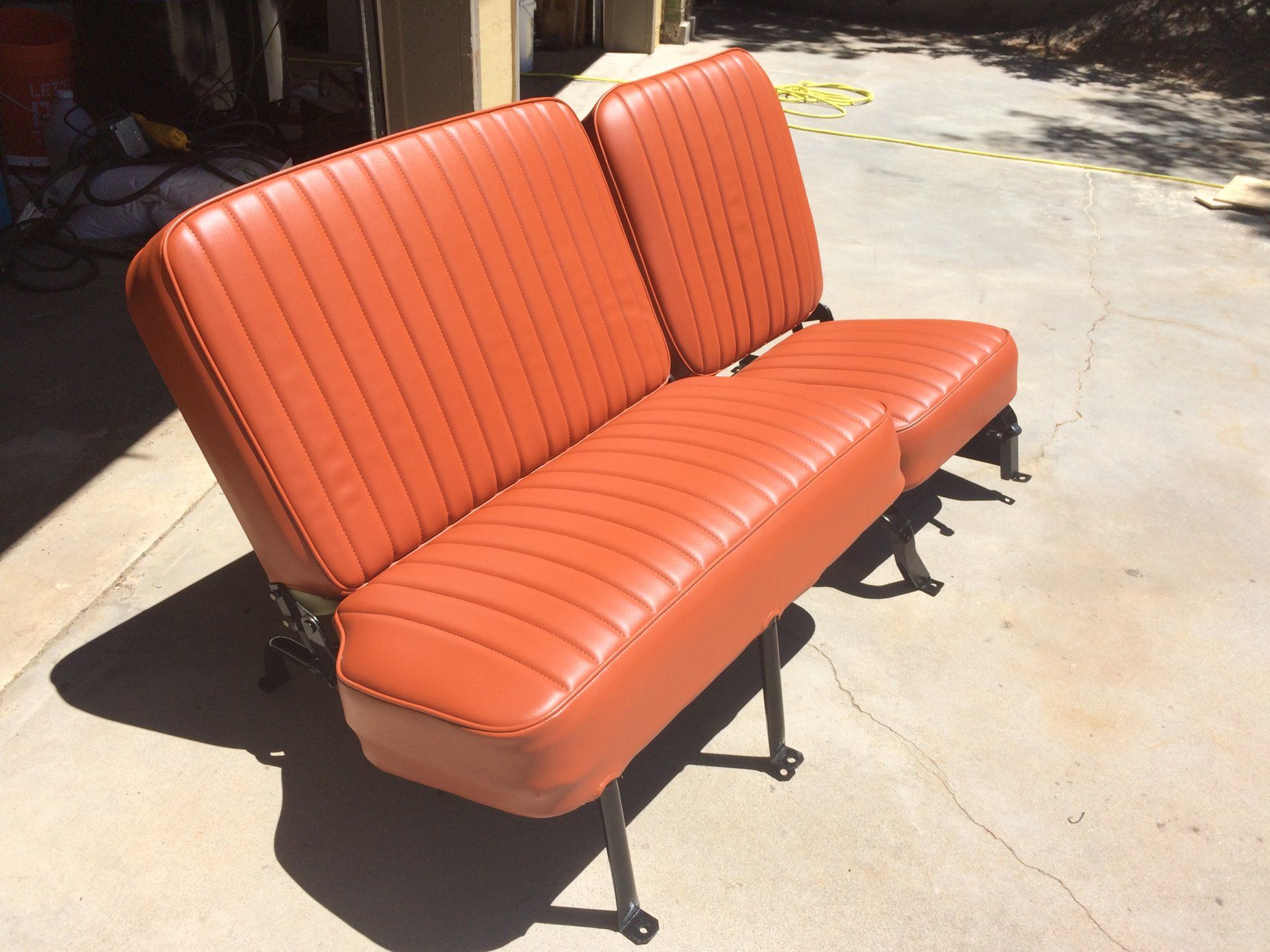

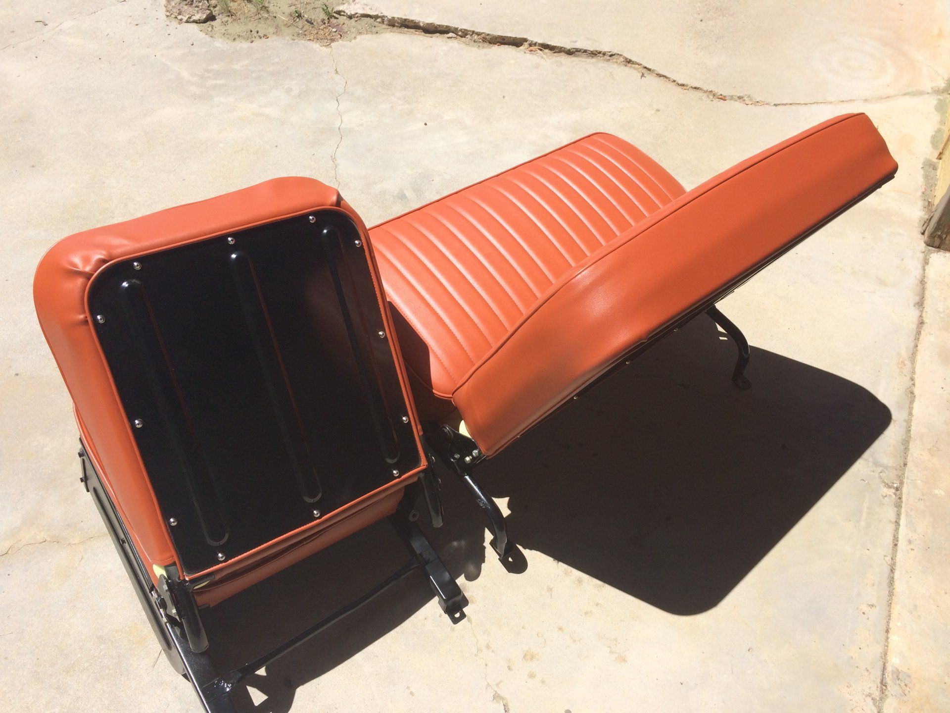

Finished redoing the seat. Very pleased with the outcome.
Hey Justin. Quick question: Where did you source the seat covers? I looked quick through the thread and didn't see anything. Sorry if I missed it.
I need a set for my RHD 45. Also hoping to find the nice metal backs. Mine have the press board.
Thx for any info,
Ken
