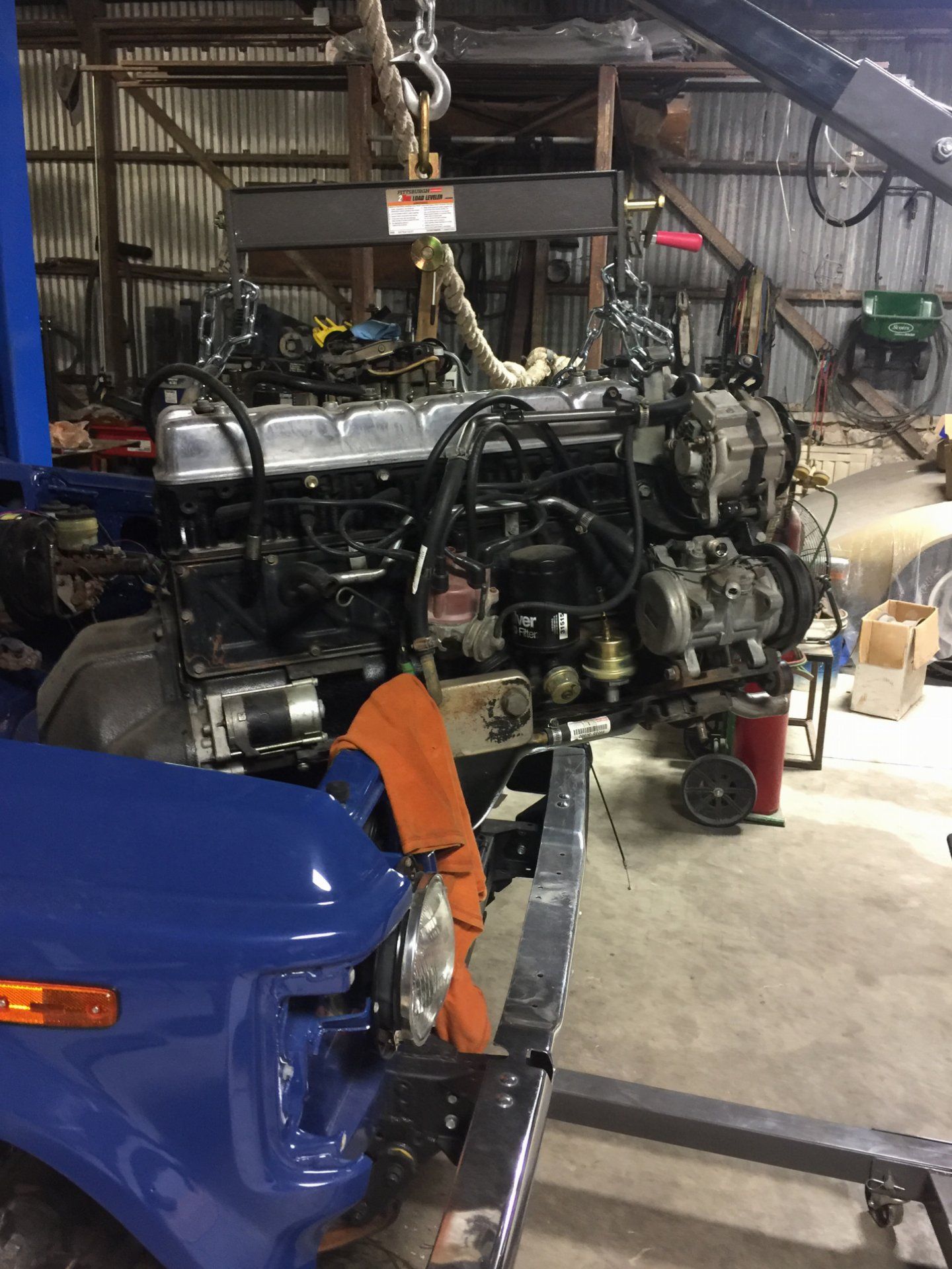

Well the last time we checked in with Jimmy's Barn, Jim was finishing up a gearbox rebuild. Tonight, he's preparing Frankenstein for a heart transplant. Swapping a 2F for a 12HT last I heard.
Out with the old... and soon, in with the new! Man that 2F looks pretty clean :)

Ryan, that 2F is going in Addisons 60. Should have it out by tomorrow and start dropping this one in. The great thing about this 2F is it's the one that came in McGuires rig when we got it from his grandfather. I used it for several years and then MJ and I rebuilt it when he was 15 and then he used it for a couple years. He pulled it when he did the 12HT swap. It has roughly 30K on it. Should serve MJ's younger brother well.

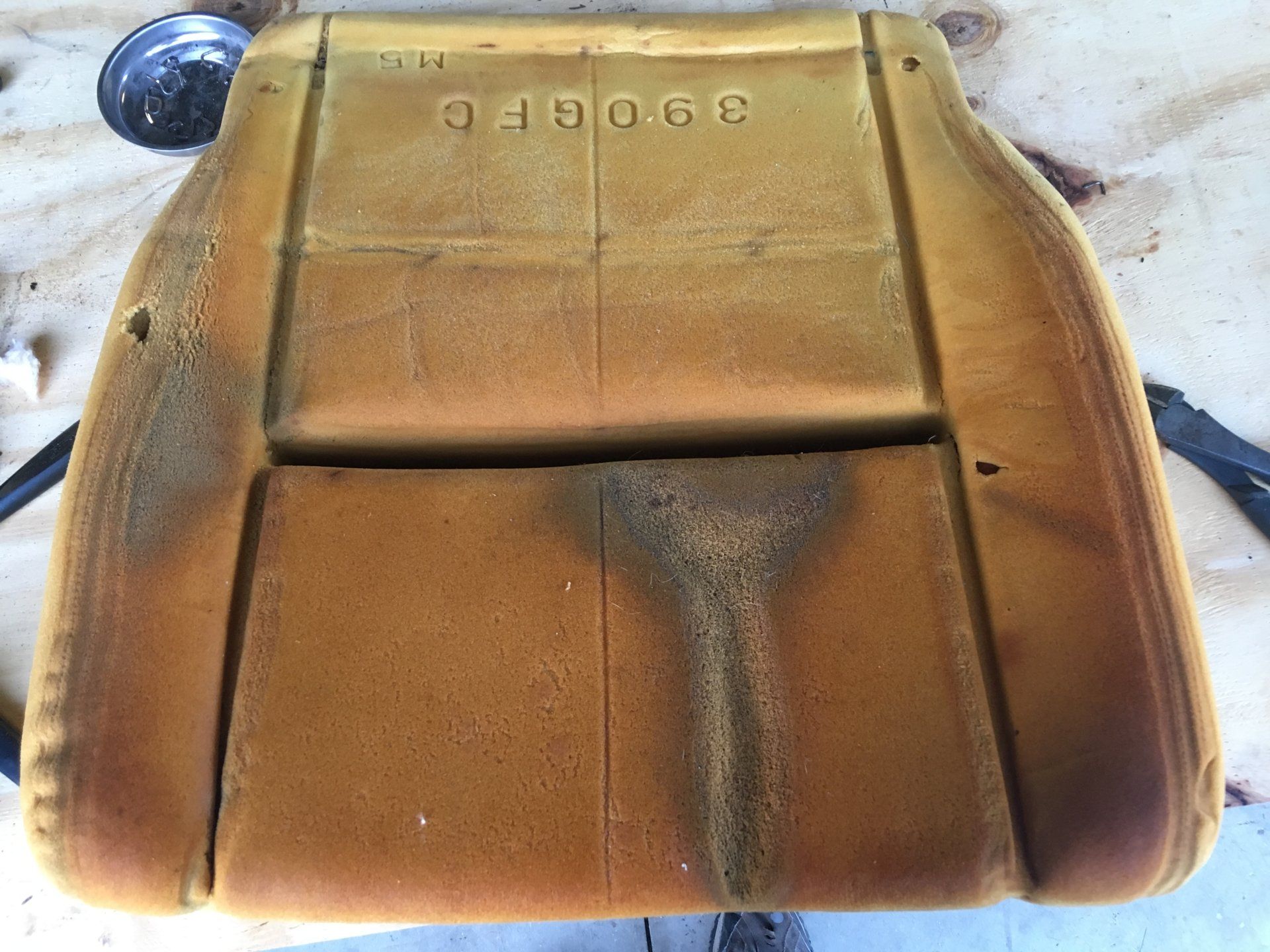

Interesting side note... after I skinned some old covers off the driver's seat, I discovered this interesting wear pattern in the foam...
Needless to say, we sourced some other foam from Jimmy's Pic n' Pull and preserved this one to Auction on eBay or sell here on Mud. Anybody interested?
Anybody?
