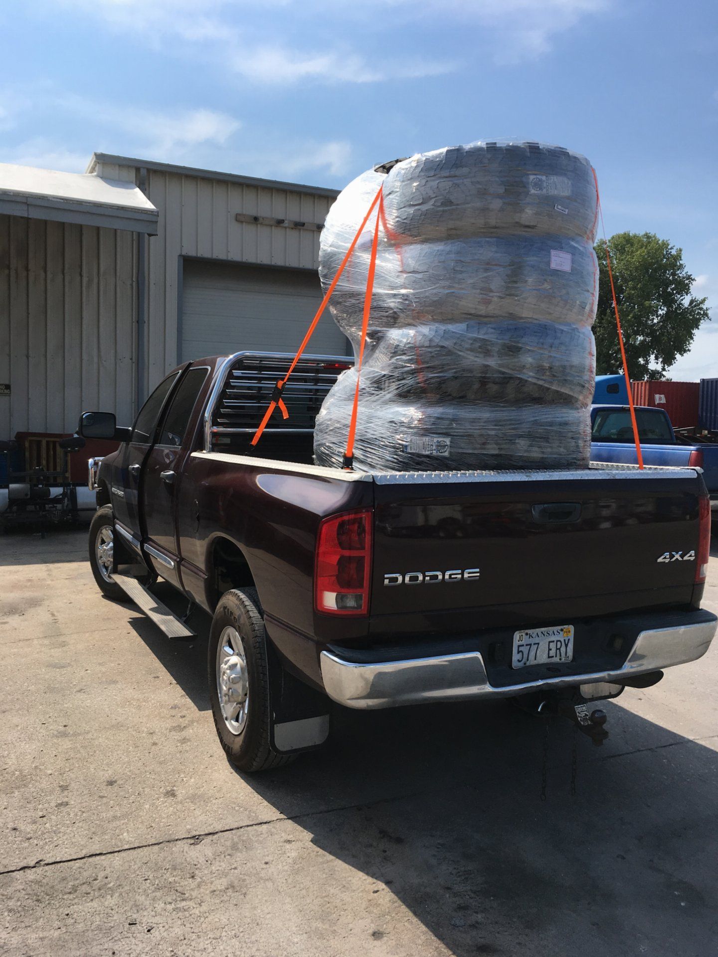

This just got real. Time to start planning the portal Install. 39.5" pit bull rockers
