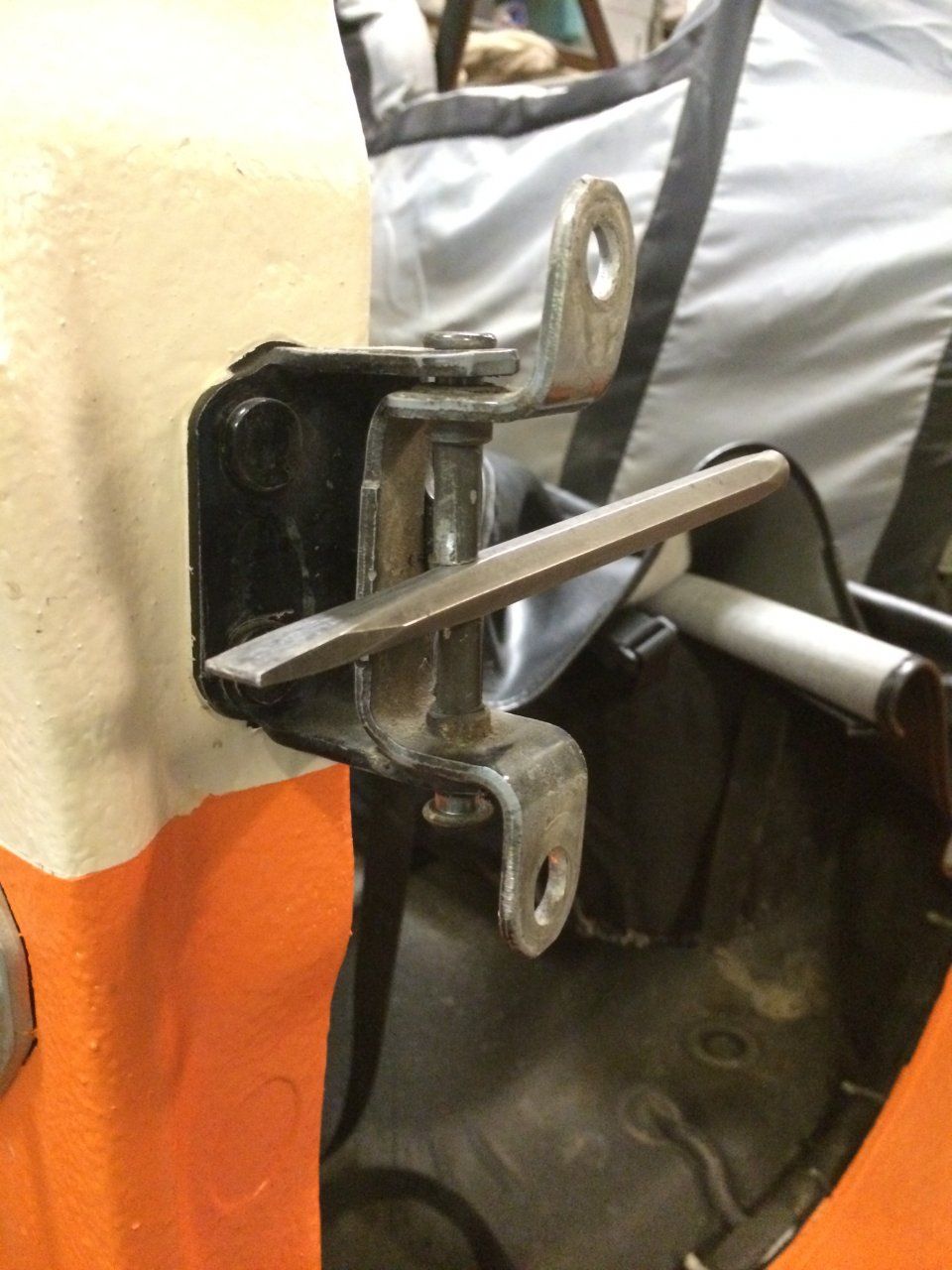

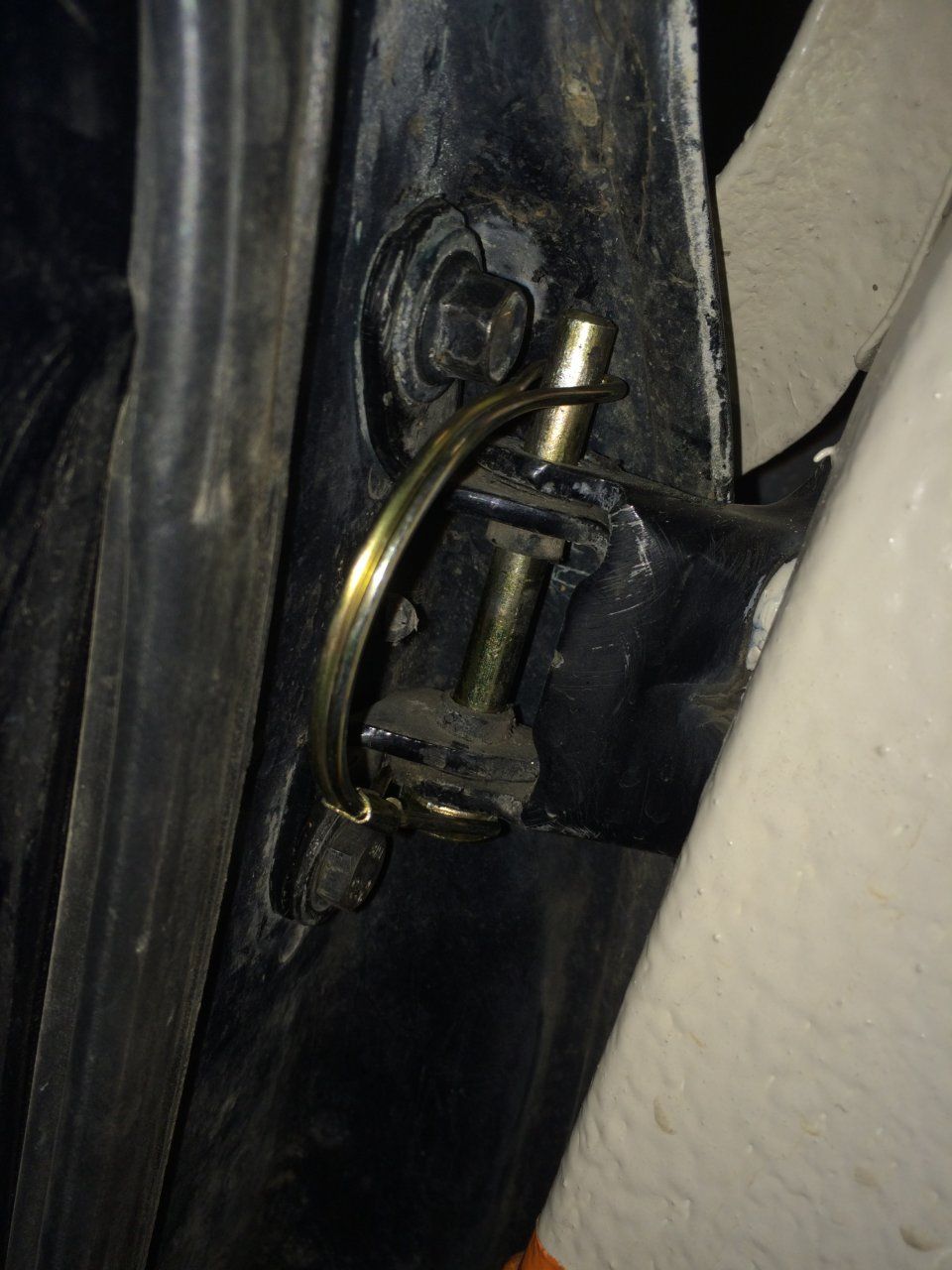

I've seen two ways to mod the hinges.
One way you cut and drive out the center pin without destroying the bushings and replace the pin with a cotter pin (or hitch pin or whatever you want to call it.
The other way is you notch the upper bolt hole on the part of the hinge that bolts to the door. This way you can just have the door bolted on with the upper bolt on each separate hinge for summer. Then put the lower bolt in once winter rolls around.
there are pictures of both floating around on google. The minitrucks have the same type of hinge.

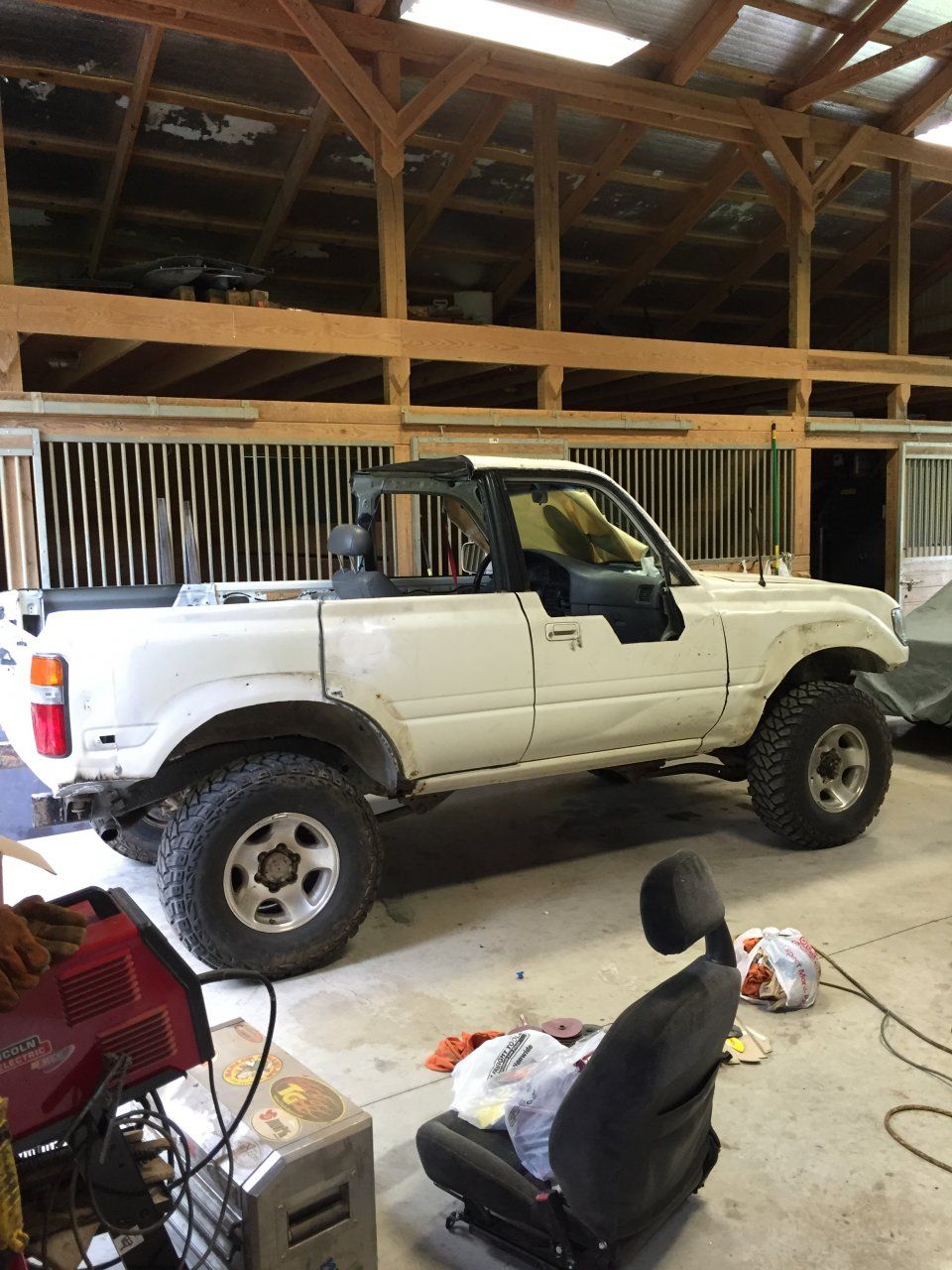

i've been kicking around the idea of building some half doors as well. My current doors have been through a roll and the window runs are pinched and crushed and I don't think they're salvageable so might as well cut them down.
Found it was easiest to cut the hinge pin in half right down the middle, file off the burrs, then use a flat punch, like a flat screwdriver between them on the cut and it punched out one side, then you can punch out the other really easy.
Went by tractor supply and for all but the rear upper hinges a 2 1/4 5/16 lock pin fits perfect. Just like the minitruck.... For the rear upper, I bought some 2 3/4 by 5/16 lock pins.

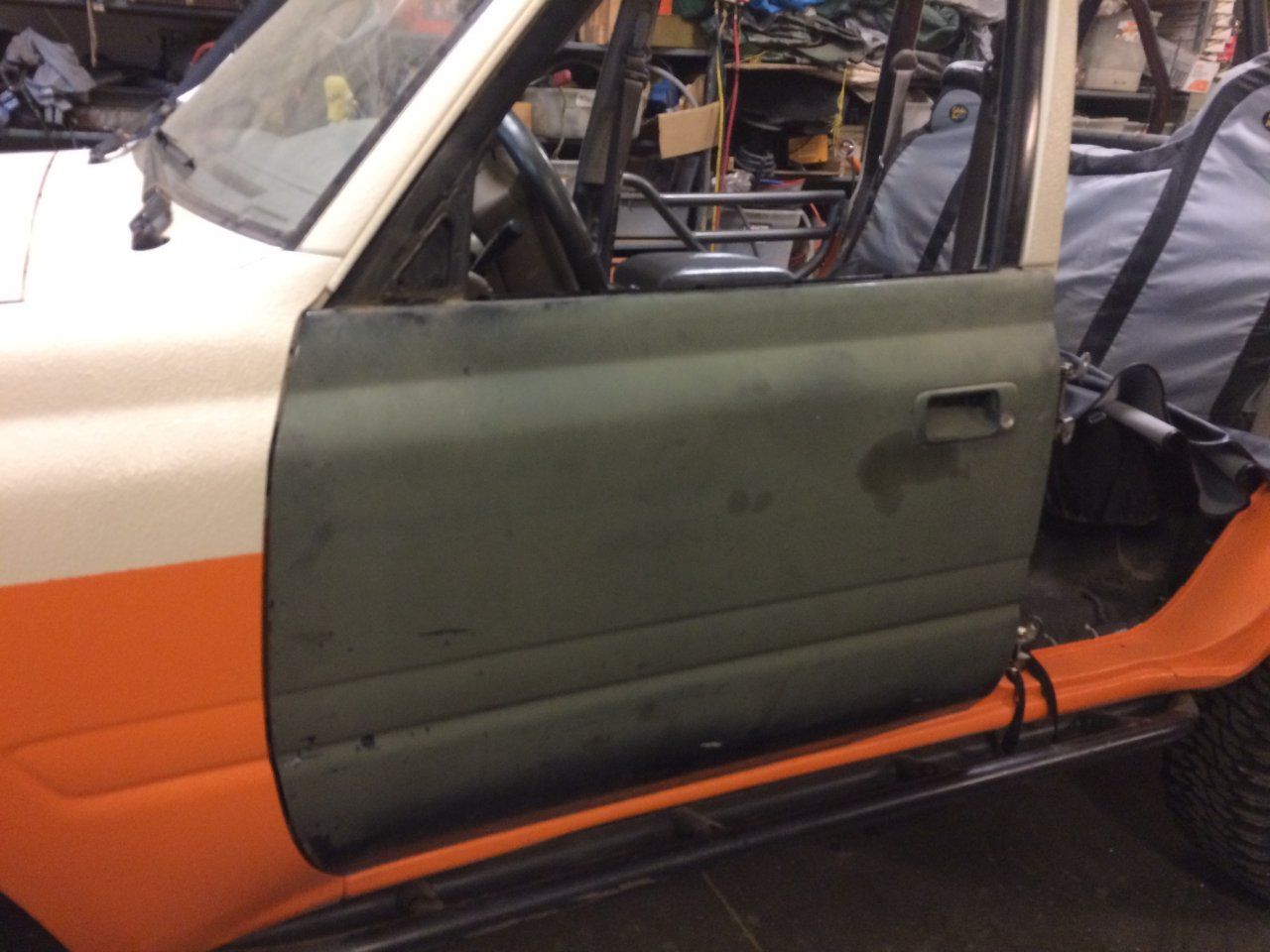

Made some progress on doors. Here are pictures how I took the hinges out, cut in with the wheel split the difference and pound them out. Upper lock pin has to go in from the bottom and I had to replace one bolt with the lower profile head To clear.

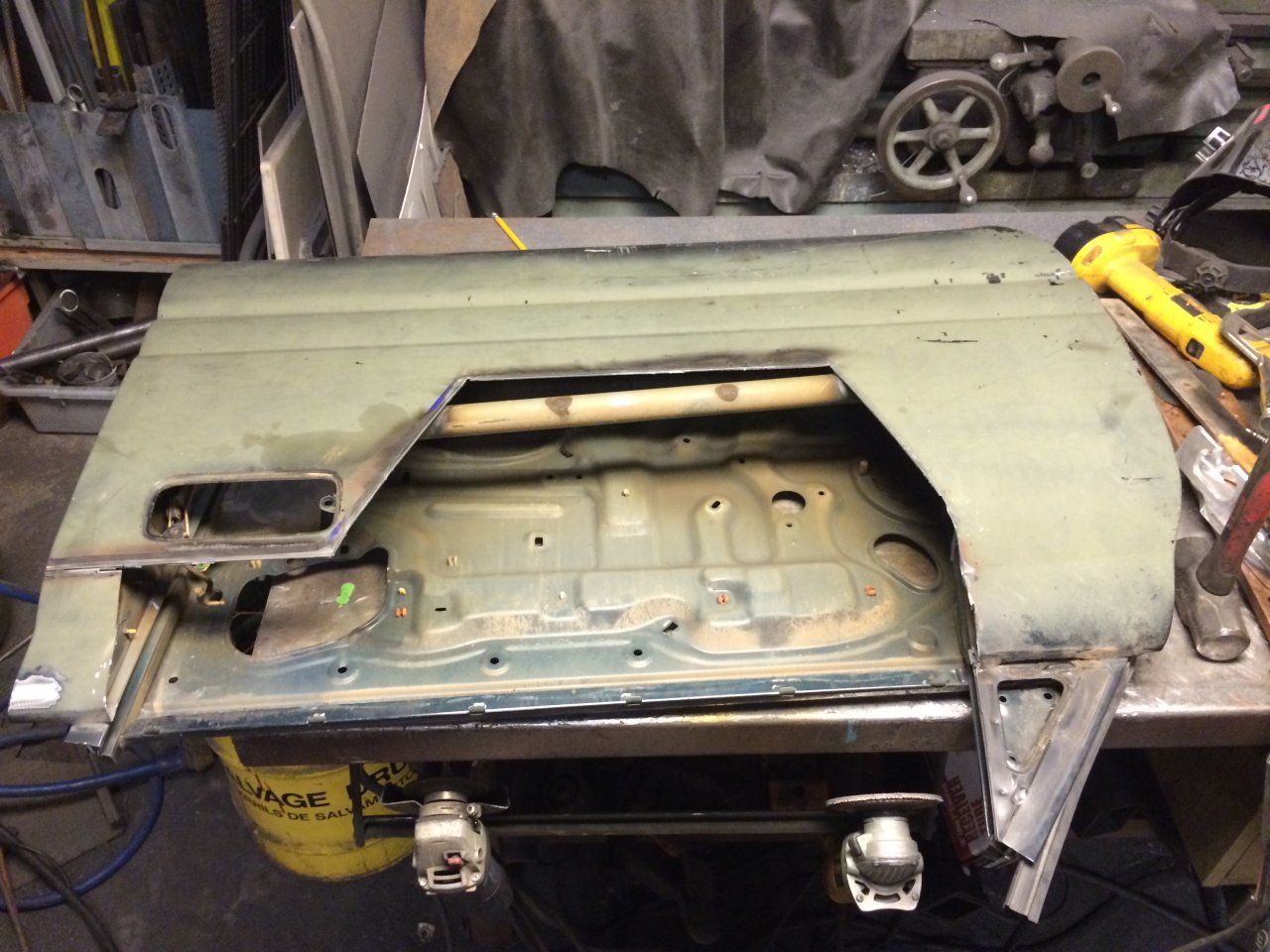

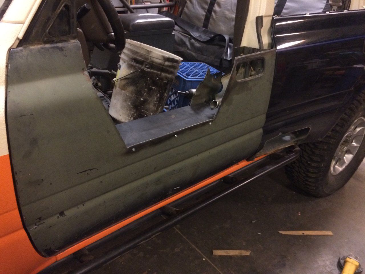

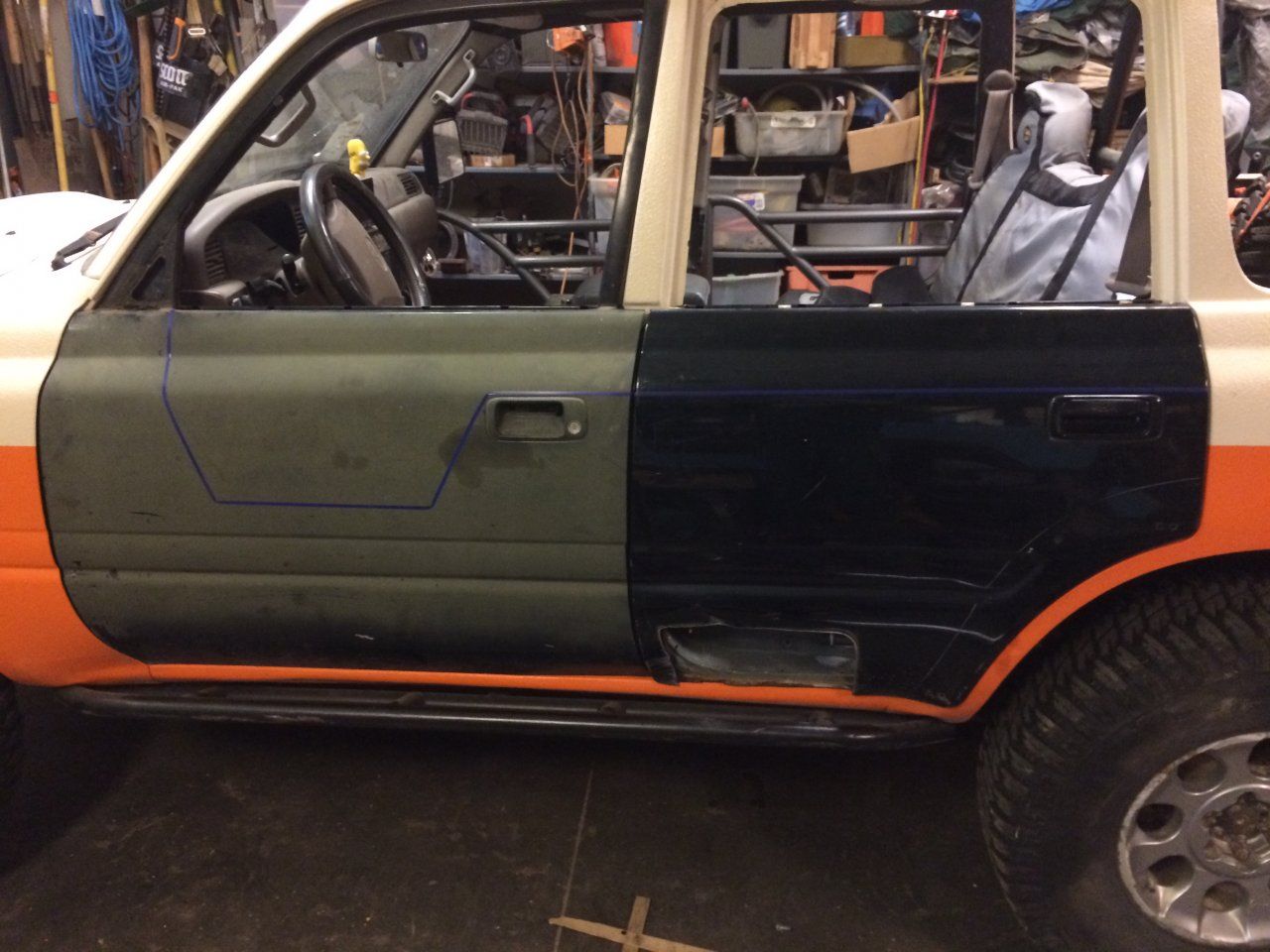

Sweet half doors. What's your plan for the inside handle? Did you cut out the bar that runs across the inside of the door?
I made my preliminary cuts tonight for my half doors. Now I just need to stare at it for two or three more hours. I'm thinking of rounding the corners to make the openings "flow" a little better with the fender lines. If I cut out much more metal I'll have to get creative with the handles.
Just so everyone knows these doors were in a roll. Glass was never going back in....
