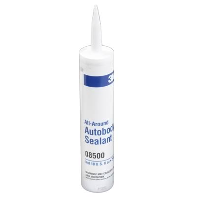

3m makes a seam sealer and all around body caulk. They also make a rain gutter sealer. most good paint and body supply shops have it in stock.

I would use the automotive "stuff"... as suggested, the 3M people seem to make all different flavors of products and their stuff is a known quality. Most body shops have been using their sfuff for a number of years now. Some products not designed for automotove use will promote rust and will not function as desired. I would only want to do the repair one time. Stay with the 3M automovtive products.
I have used this
And this...
Both can be painted on...
