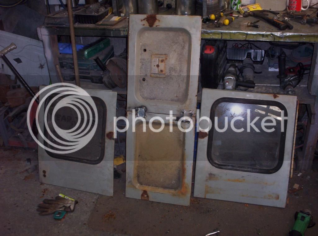

Is custom made using a pair of cut down and sectioned barn doors, part of a front door and some one off bits and pieces i had to fab.

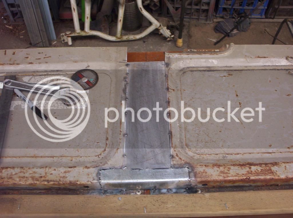

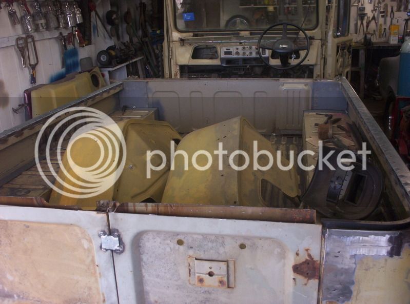

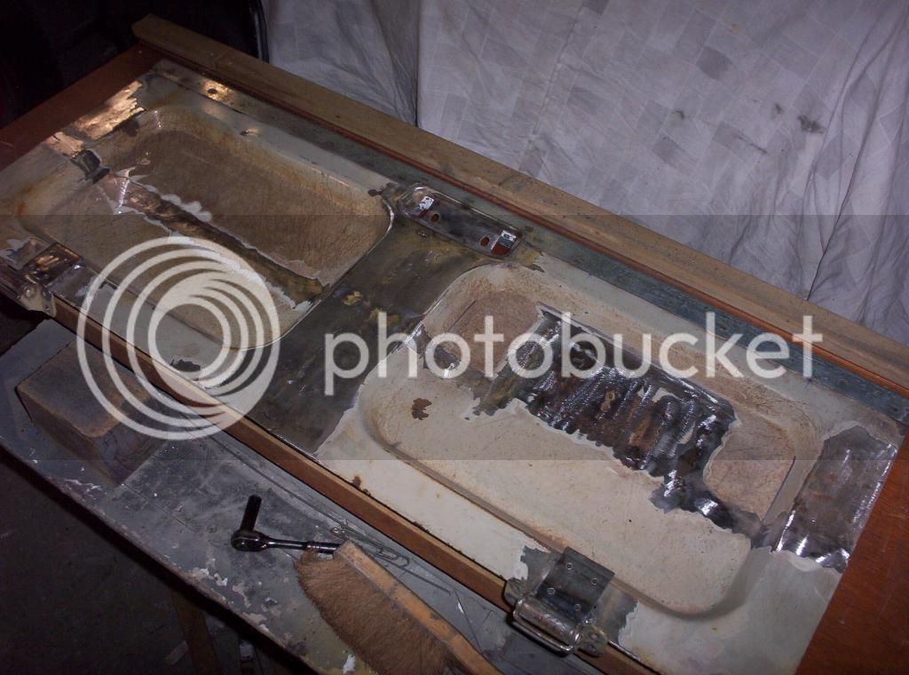

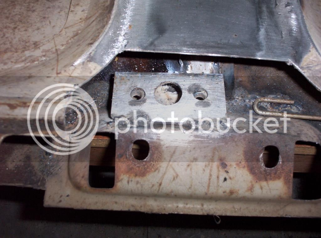

Ok here goes. Note Some pics are out of order

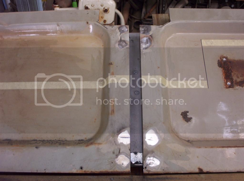

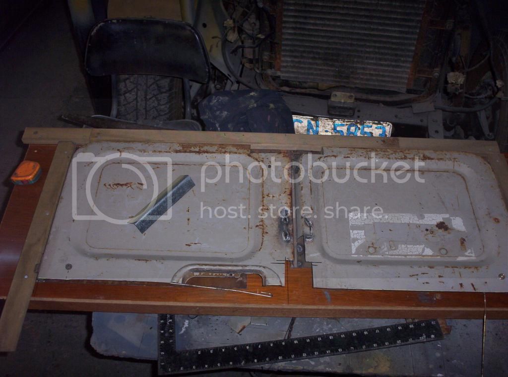

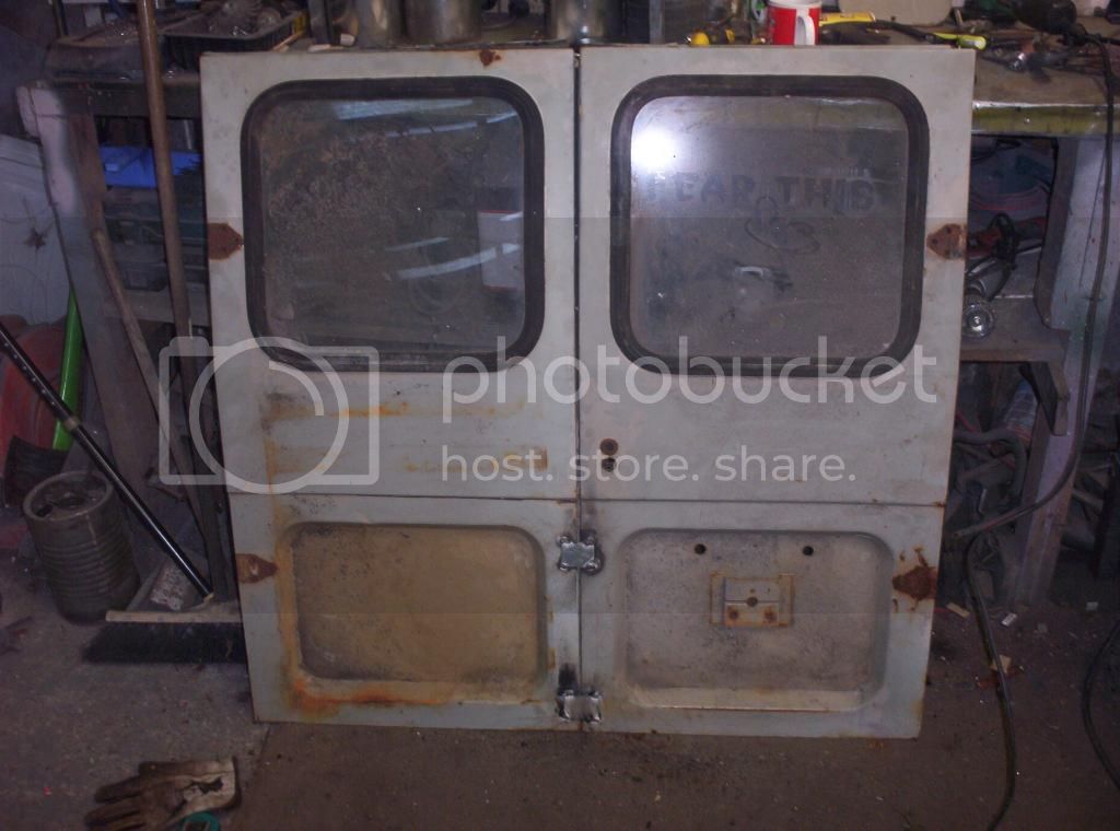

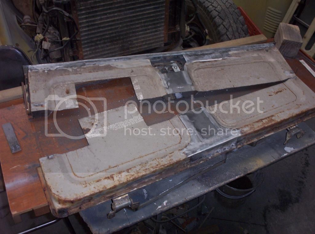

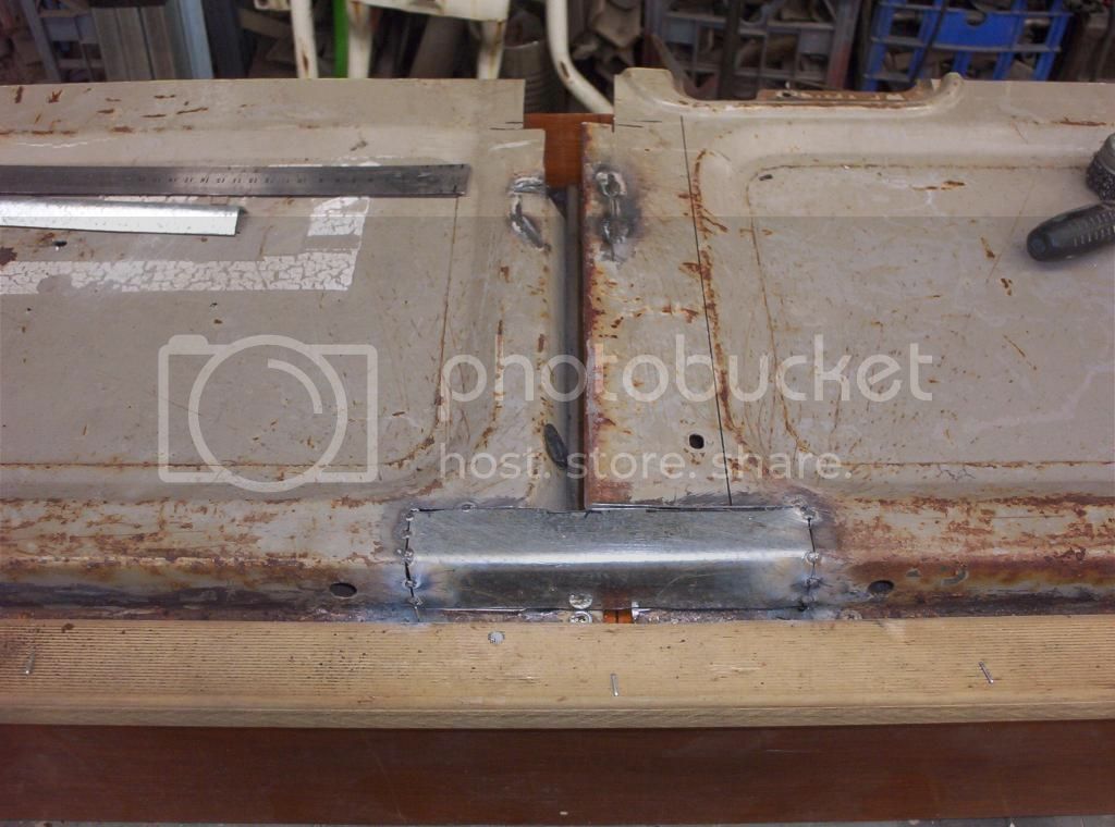

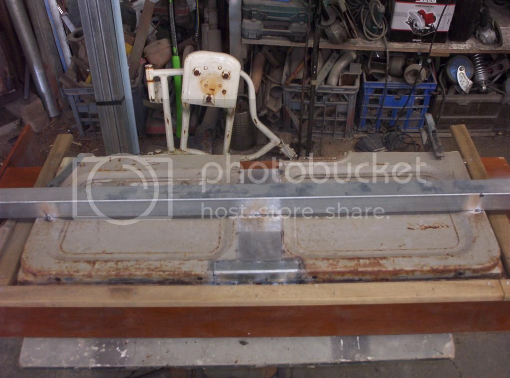

Started by measuring the opening in the body. then tacked the doors together using some off cuts allowing for the gap around the outer edge when fitted to the rear opening
then cut them in half. just under the body line on the front and a bit higher at the back
test fitted

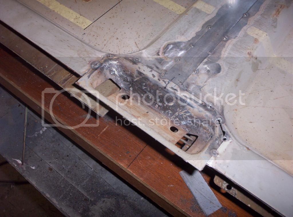

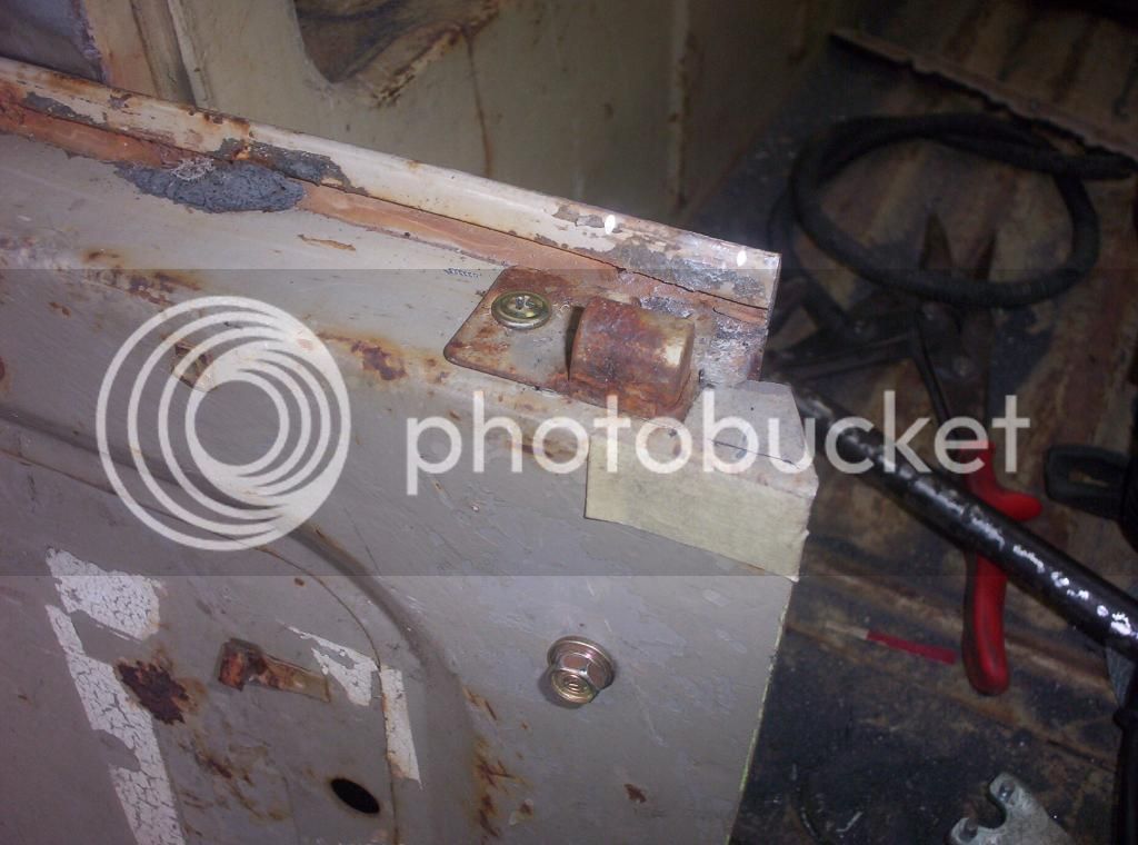

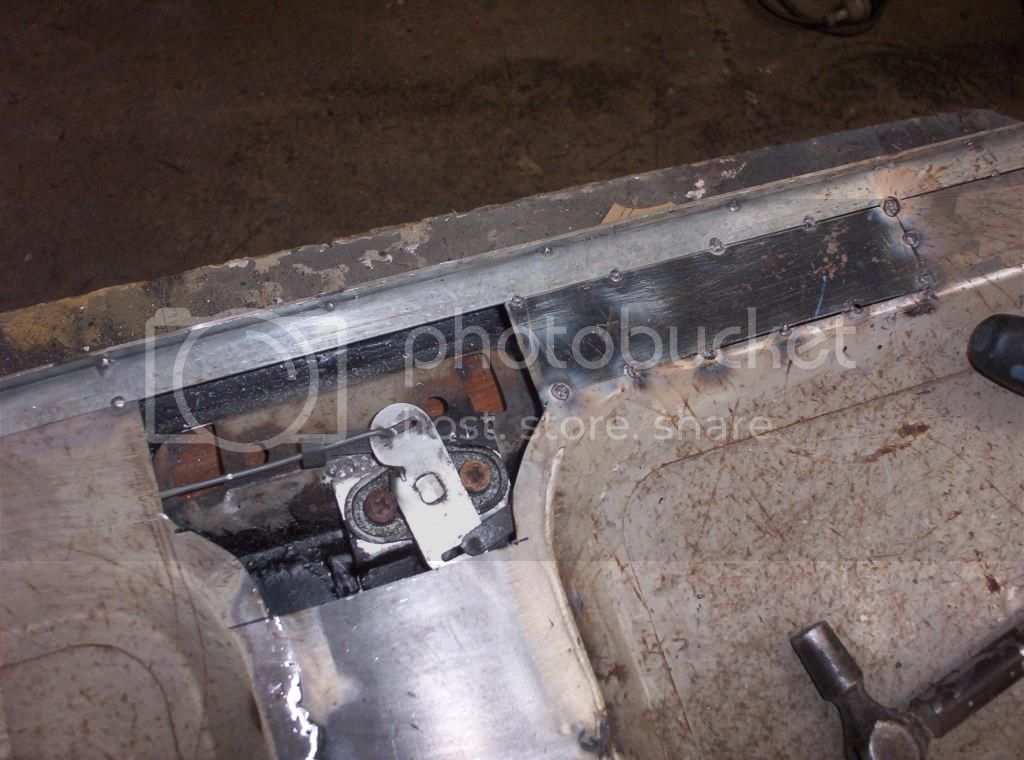

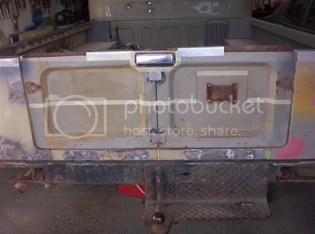

fitted original door catches into sides

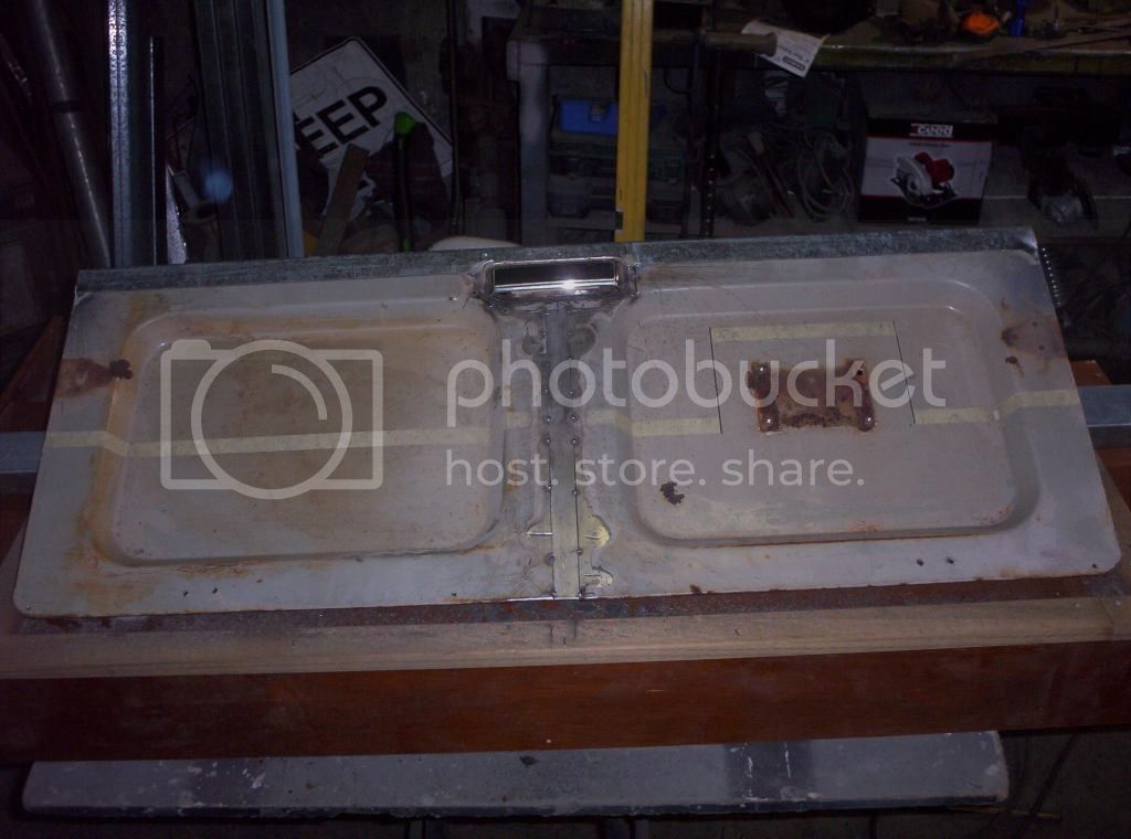

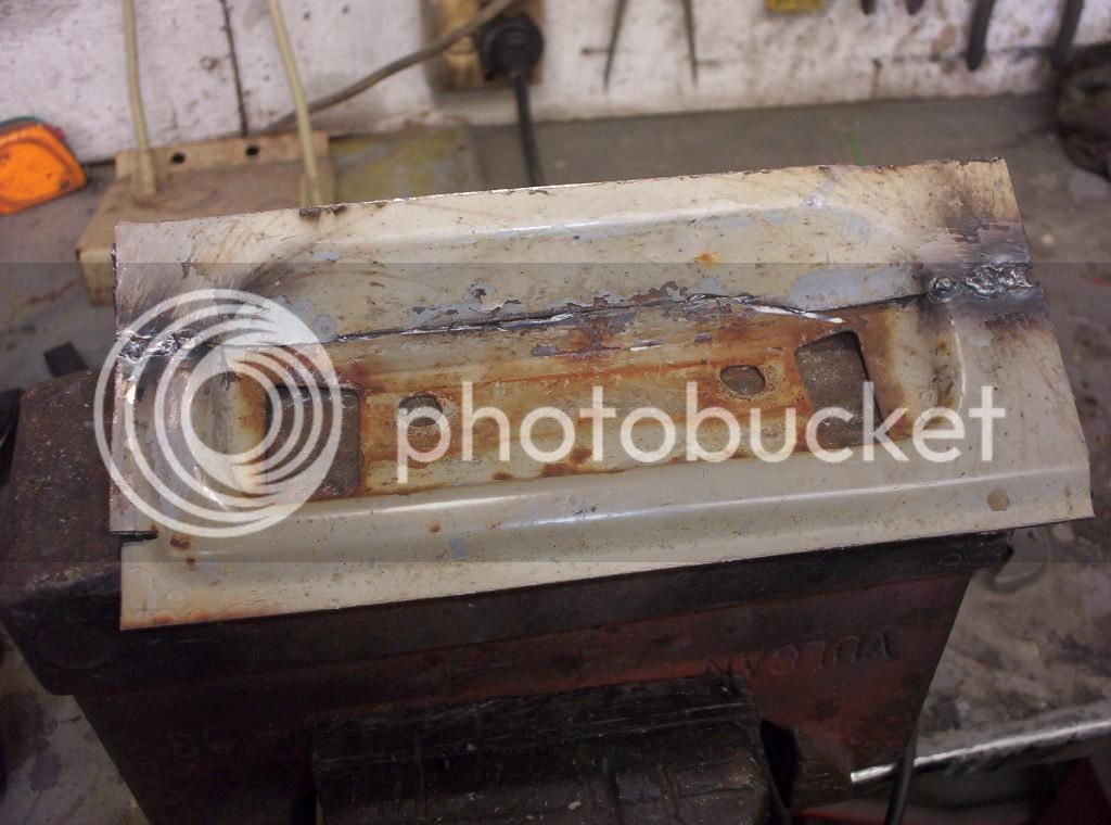

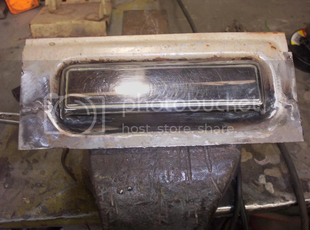

Cut the handle section out of an old front door, and then sectioned it to make it a bit small from top to bottom.
test fitting
More after:)

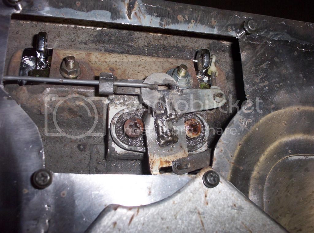

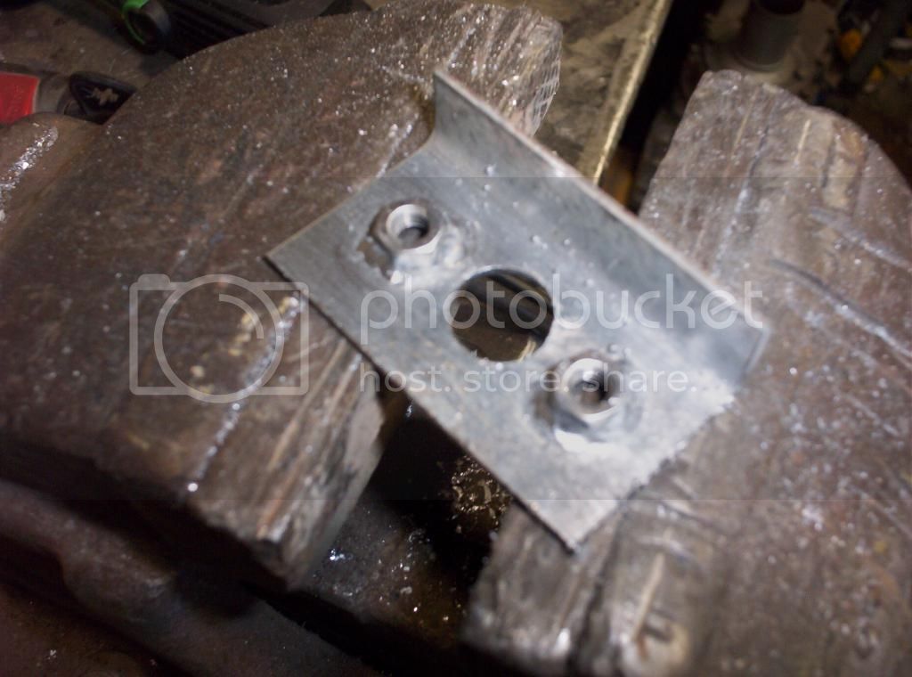

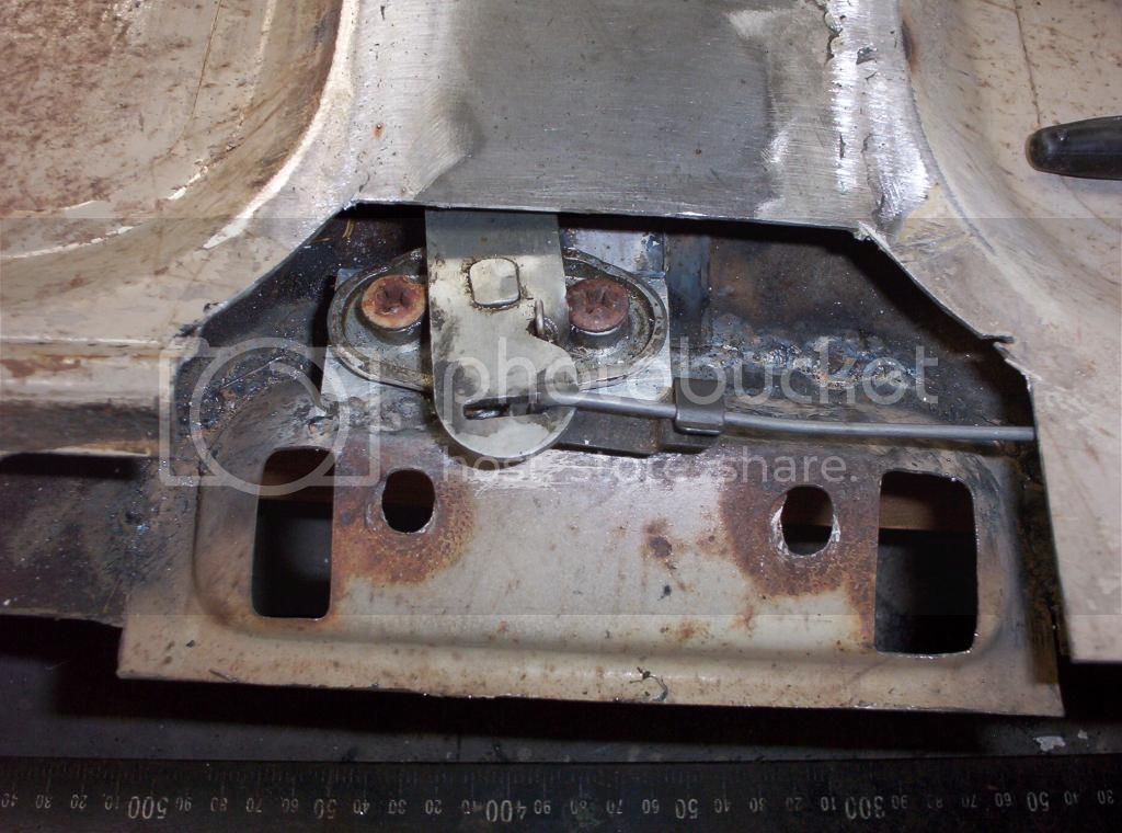

Lock mechanism And finishing of the back

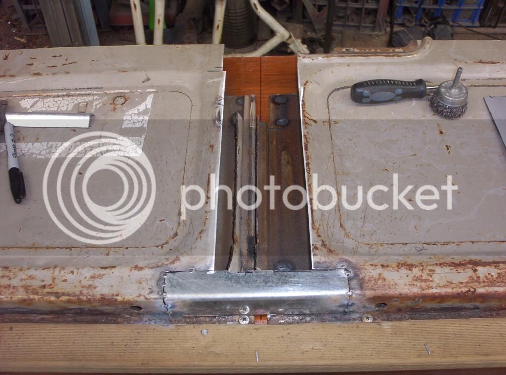

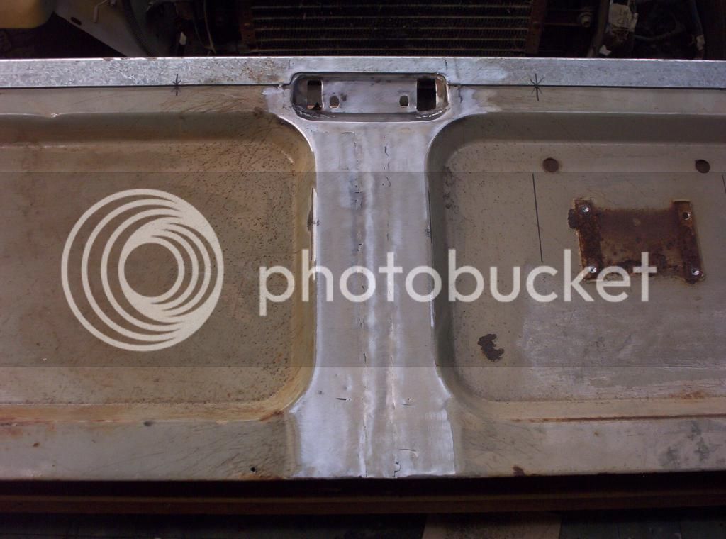

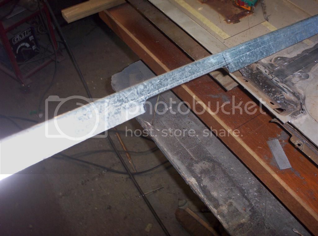

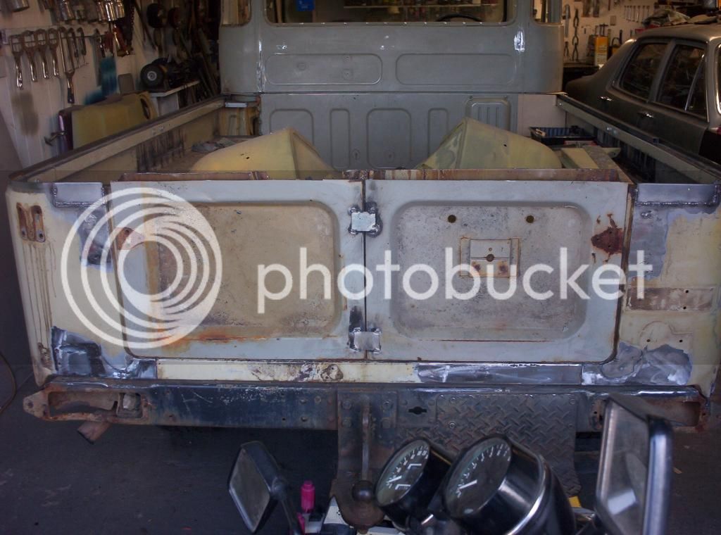

Now those with a sharp eye will have noted the the tailgate is to tall. and actually sits higher than the quarter panel. So i sectioned out an inch
Also note, modified lower barn door hinges tacked in place on bottom
More soon
