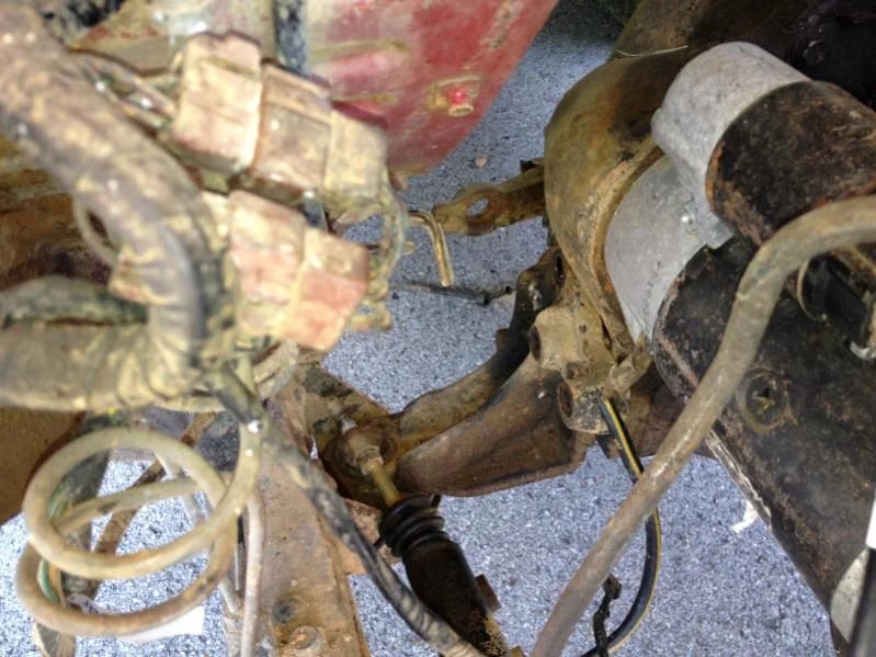

What is this? Dimond in the very ruff?
Here are pictures that show it a little better.
Maybe this engine came out of another rig?
Does anyone have any input?

Your third picture in post 140. The engine bracket looks bent to me. See the angle of the lower section then there is a bend in the outer tongue which means it is bent cause mine is straight. That said the mounts still would not be the correct angle and the other side (longer side) would not work either.
Your engine mounts (as my HJ60 ones are) appear to be offset front to back. Check your frame, are they inline? I swapped a 2H from a HJ60 into my 2F gas 40 and the 2F were inline but the 2H were offset. The 2H left was in the rear set of holes in the block and the right used the front set of holes. Also there is a cast spacer piece on the HJ60 that changes the angle from the bent steel frame bracket to the cast steel engine bracket. It goes frame->bent steel riveted frame bracket -> cast angle adapter -> rubber engine mount -> cast engine bracket -> engine block. Similar setup on both sides but the parts are all different!
What I did was make new frame mounts to sit it in place. The rubber mounts are against the cast engine brackets which replicated the OEM HJ60.
So I would say you have 2 problems. One is a bent left engine bracket and incompatible parts. But this is easily fixed with time and a welder.
I am also questioning your right engine bracket since the HJ60 one is long and the HJ47 one is shorter I believe. I can't tell which you have. Whatever you do don't bother trying to cut and weld one of the cast brackets unless you have some knowledgeable welders around. I tried and failed. Just get plate and make new parts that fit.
You've done so much, don't let this intimidate you.
Chris
Looking again at your pictures are you SURE the engine is not from a HJ60. The engine mounts look identical to what I personally pulled from a HJ60. The right hand mount was too wide to fit between the 40 frame rails so I made a new one out of plate. Do a few measurements. If you do make new engine brackets, use the transmissions and radiator fan as alignment guides. Iterate your way to final product cause the mounts squeeze down under load.
Chris that was extremely helpful! In your first pic the cast bracket between the chassis mount and the rubber mount looks very familiar. I have 2 one that is broken and one not. With that piece the angle is correct but still to wide. So that makes sense that we have an engine from a hj60.
