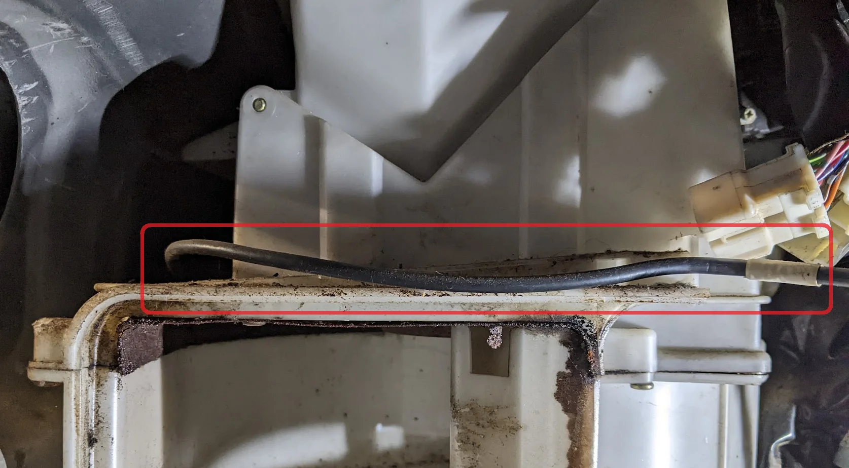

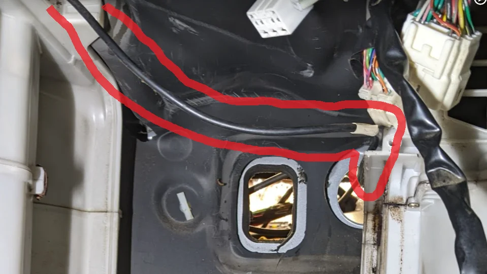

sorry for the dirt...this was before I cleaned it.
It looks like it comes through a side hole, and not the firewall. It does wrap around the hvac blower housing, to the front of the evap housing
I also seem to remember it is clipped in at various points.
The only "easy" way to do this is to attach a "fish" lead to the coax before it's pulled through what is essentially a 90 degree turn. You're on the right track . in what you're doing, but you may need something lighter and more flexible than 12 gauge, then attach the 12 gauge through it,
Basically, if you look up inside the fender at the very top of the back of this space, there is a hole that turns 90 degrees. Pretty hard to do with your fingers, but maybe you can grip the coax end with some long needle-nose pliers or a long hemostat and thread the eye of the need;e that way?

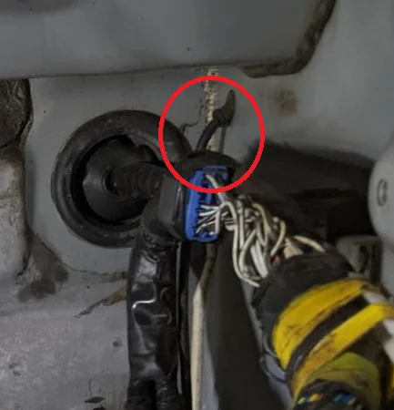

I used a stiff wire, similar to a coat hanger, and zip-tied the wire I used to pull the antenna cable through.
From the passenger side foot-well, this tool was able to get through that hole I found d earlier.
From the engine compartment, looking into the access hole where the antenna goes, I could now see the tool and the wire
I pulled that wire out and attached it to the cable and then pushed the cable into the access hole and close to the hole in the body.
I was then able to pull the cable through. Before I mounted the antenna again, I wrapped the section of cable with a plastic, cork-screw-like section of wire wrap, the kind that you would use to keep a bundle of wires together. I then wrapped that in fabric, harness wrap, to keep it in place. That section is what is hanging out in that sharp-edged hole.
