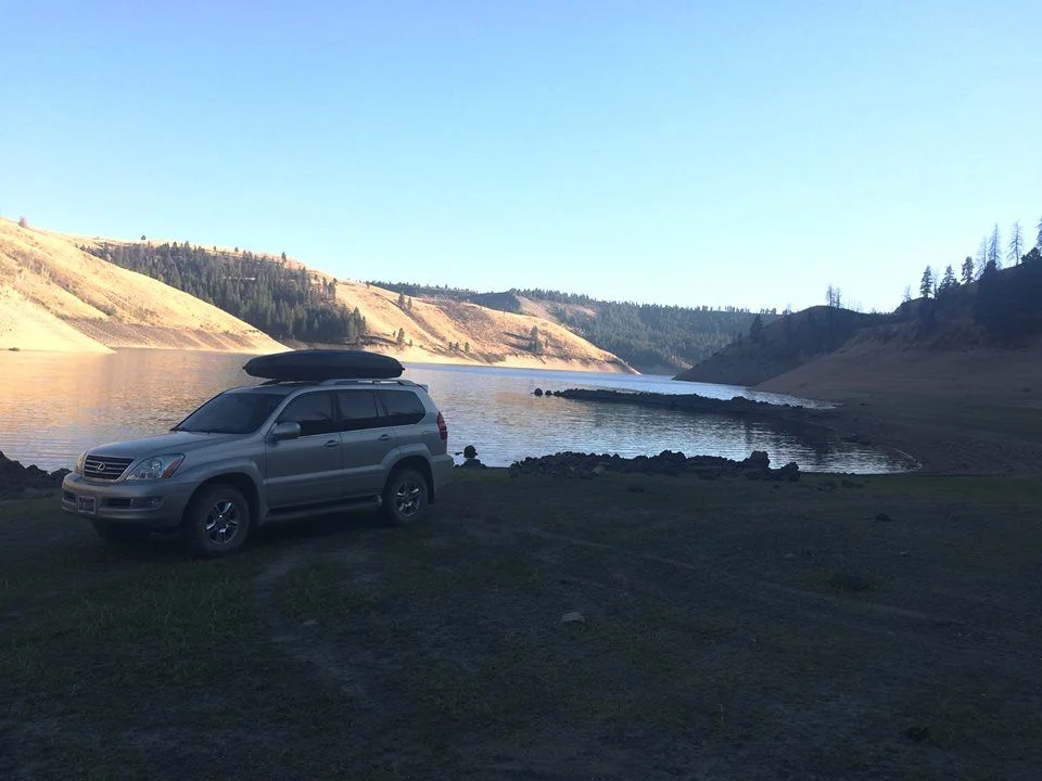

My first off road experience in the GX. I took it hunting. I killed a doe and stuffed it in the rocket box! Worked great. I just love this thing! super smooth off road sounds awesome!
Budget and GX rarely go together in the end. Get patient, save up, and do it right! Just hunting, etc you can take her stock and wont have an issue.
