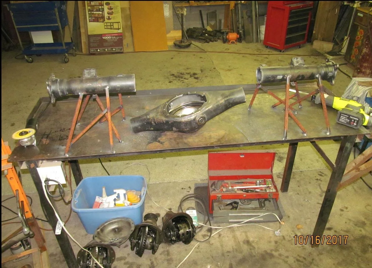

PS----I have a Landcruiser "FJ60 mod" to share :)

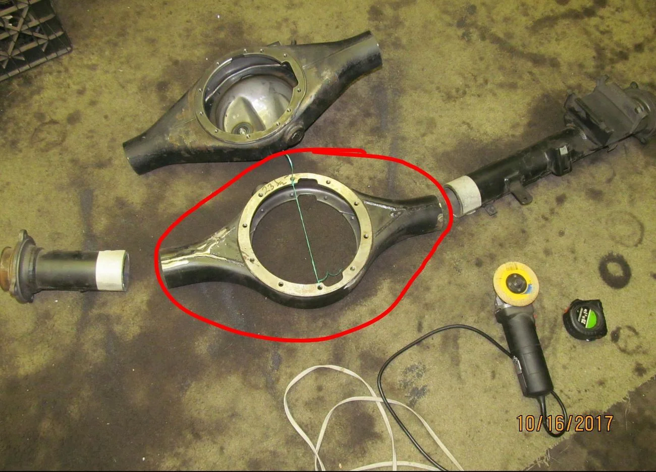

First thing I did was to cut out the juicy part of the passenger offset FJ60 REAR 3rd
full
Then strip down the 2001 Tacoma factory elocker rearend.......
full

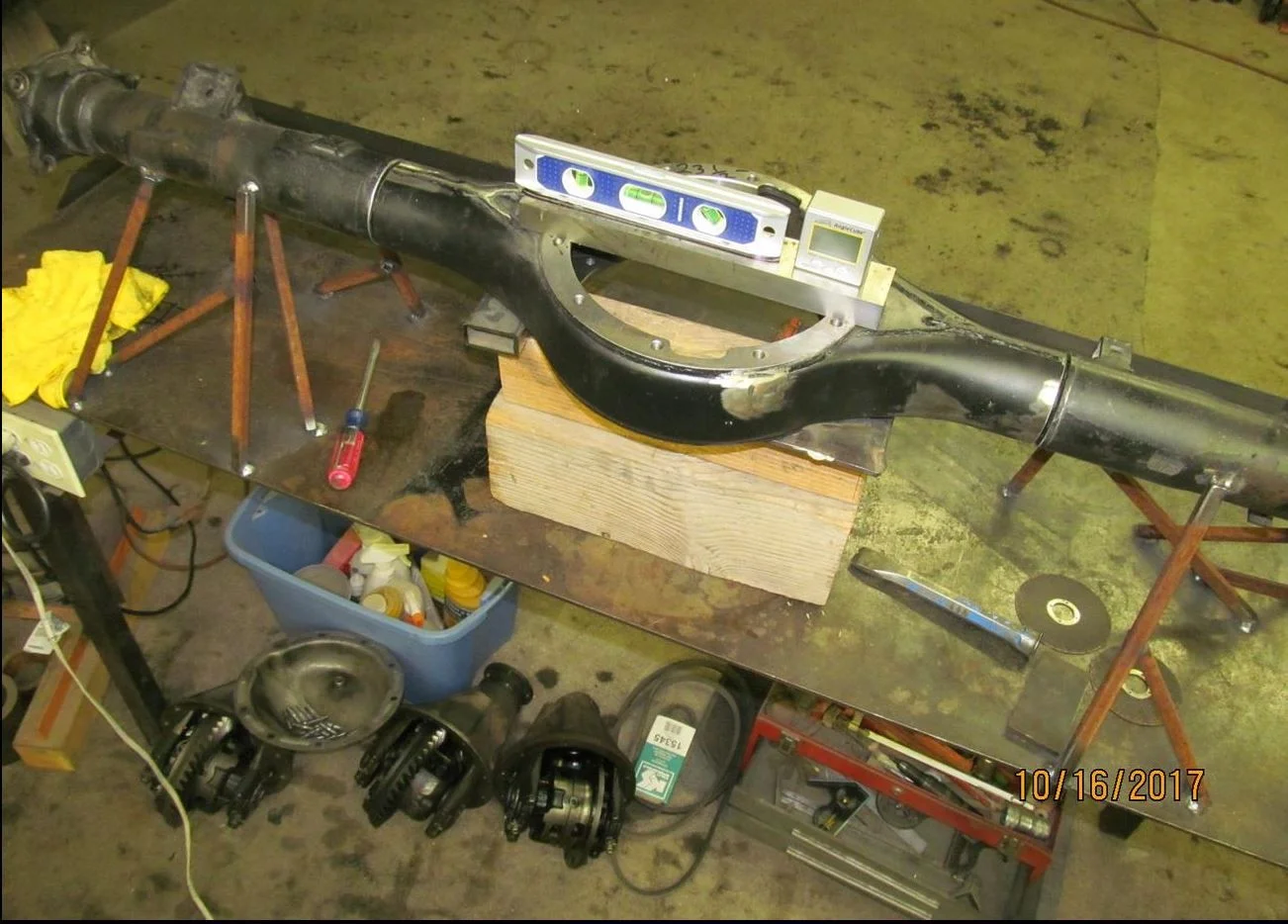

....and mount the 8" housing securely(and very much level) on the steel bench. The FJ60 housing is shown on the floor before the hole was cut out.
full

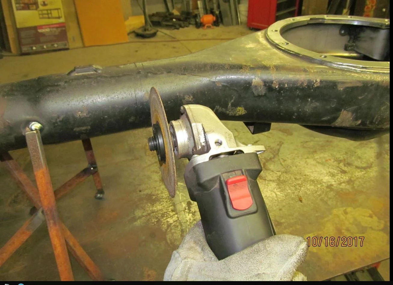

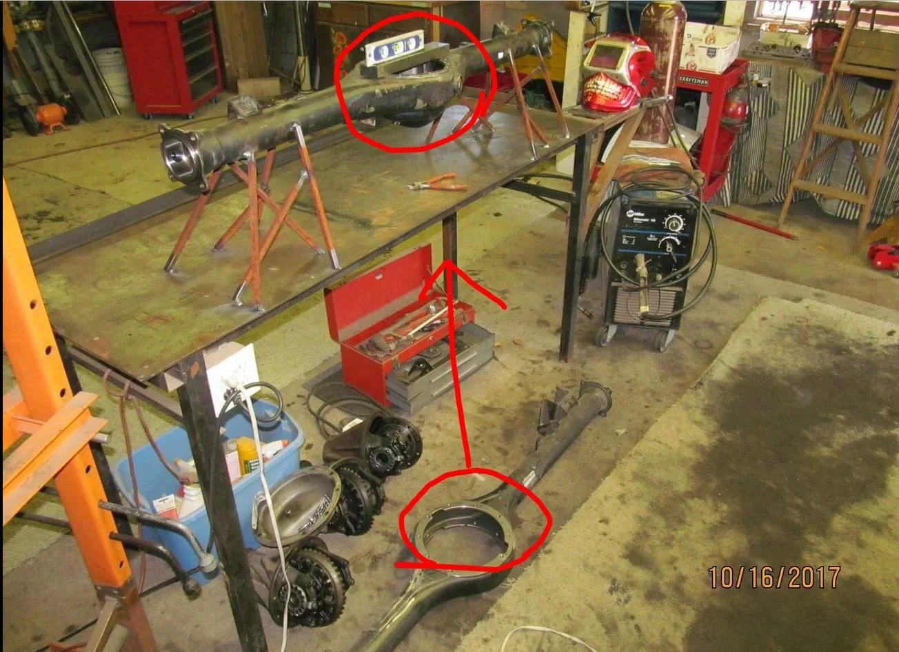

Measure twice and cut once.
full
I'm committed now......
full

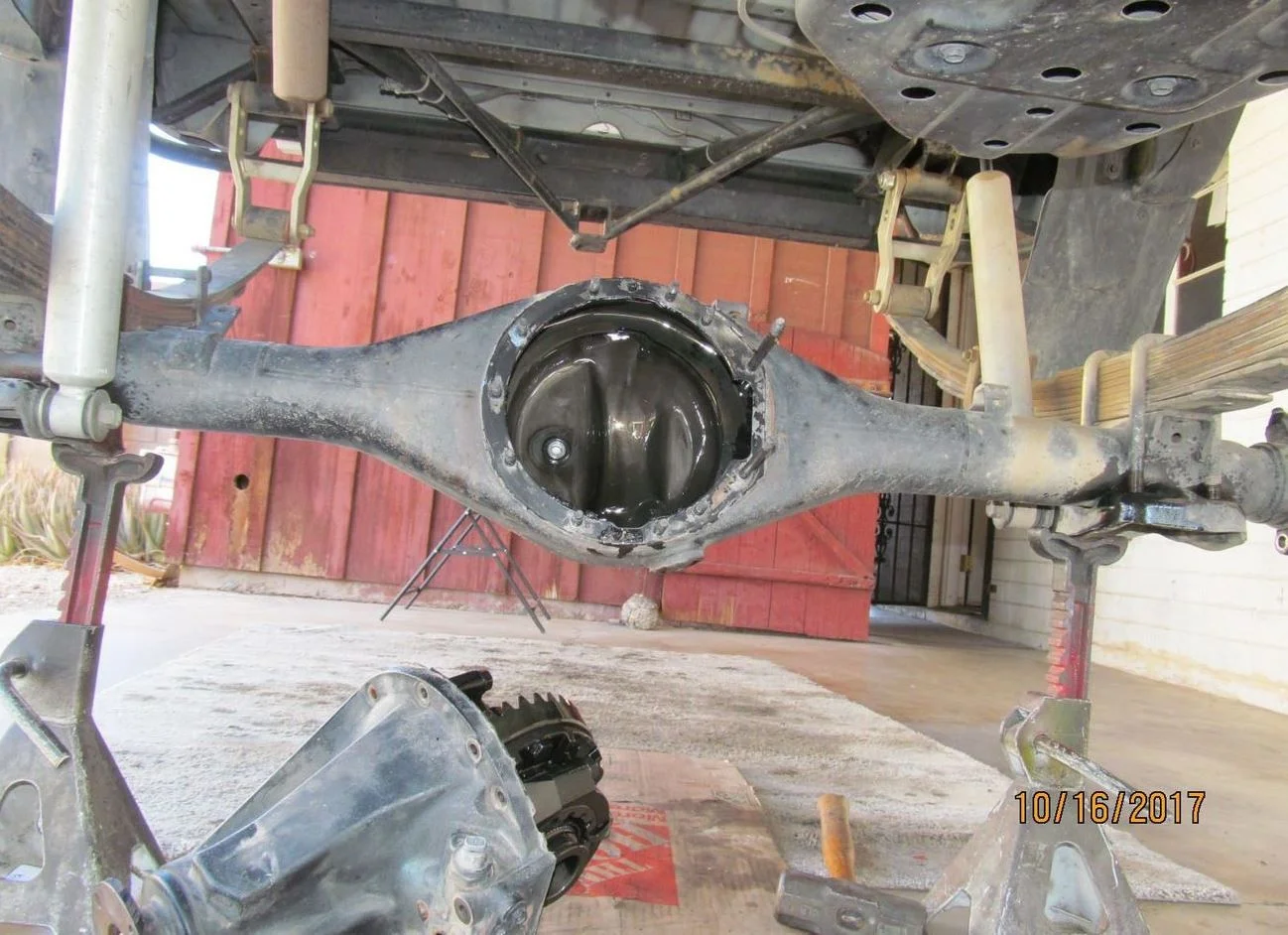

12" from the centerline of the hole.....cuts made on both tubes. Symmetry was maintained.
full

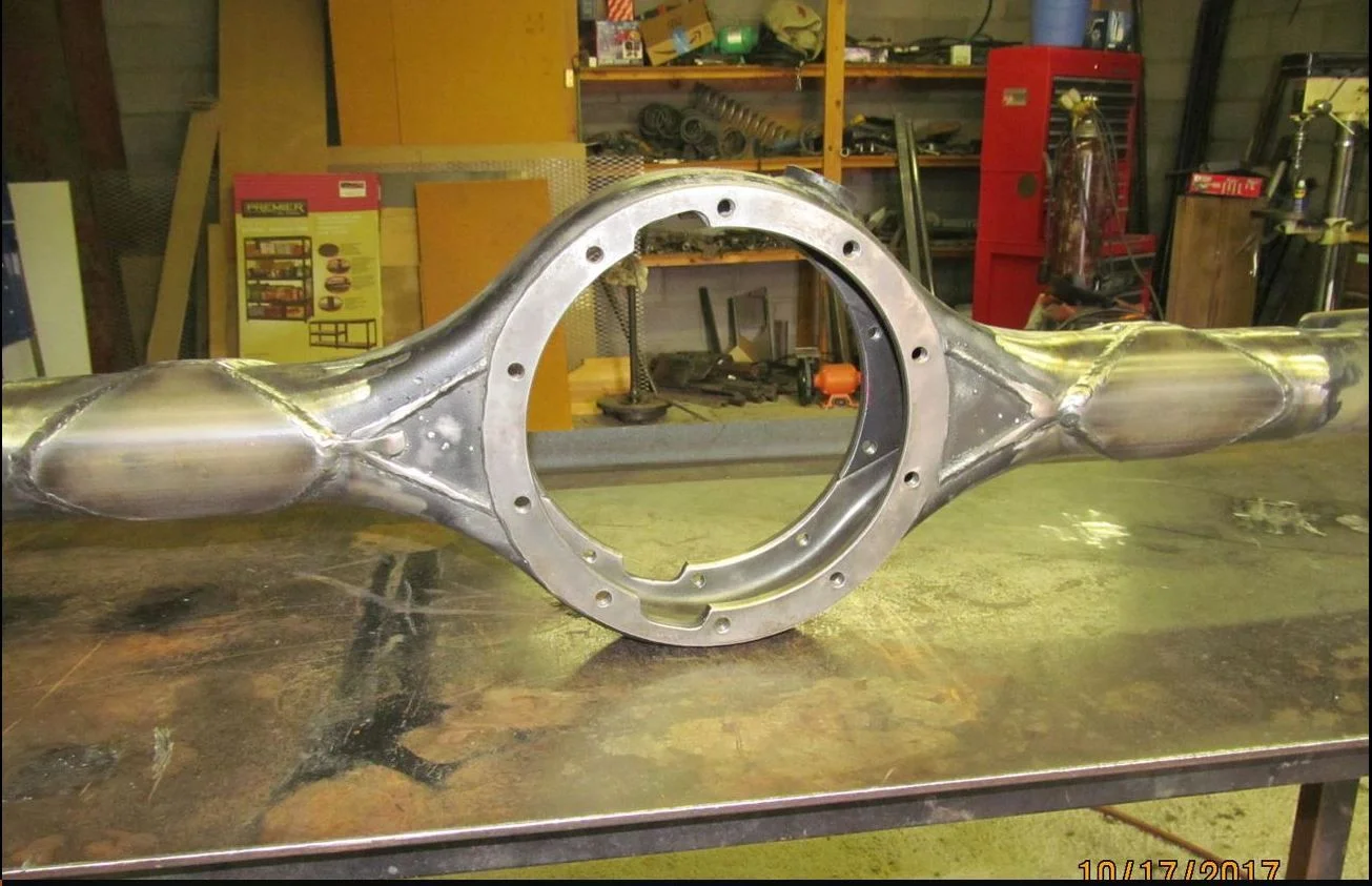

Studs were of course removed and surfaces filed smooth to allow the bubble to do its thing.
full

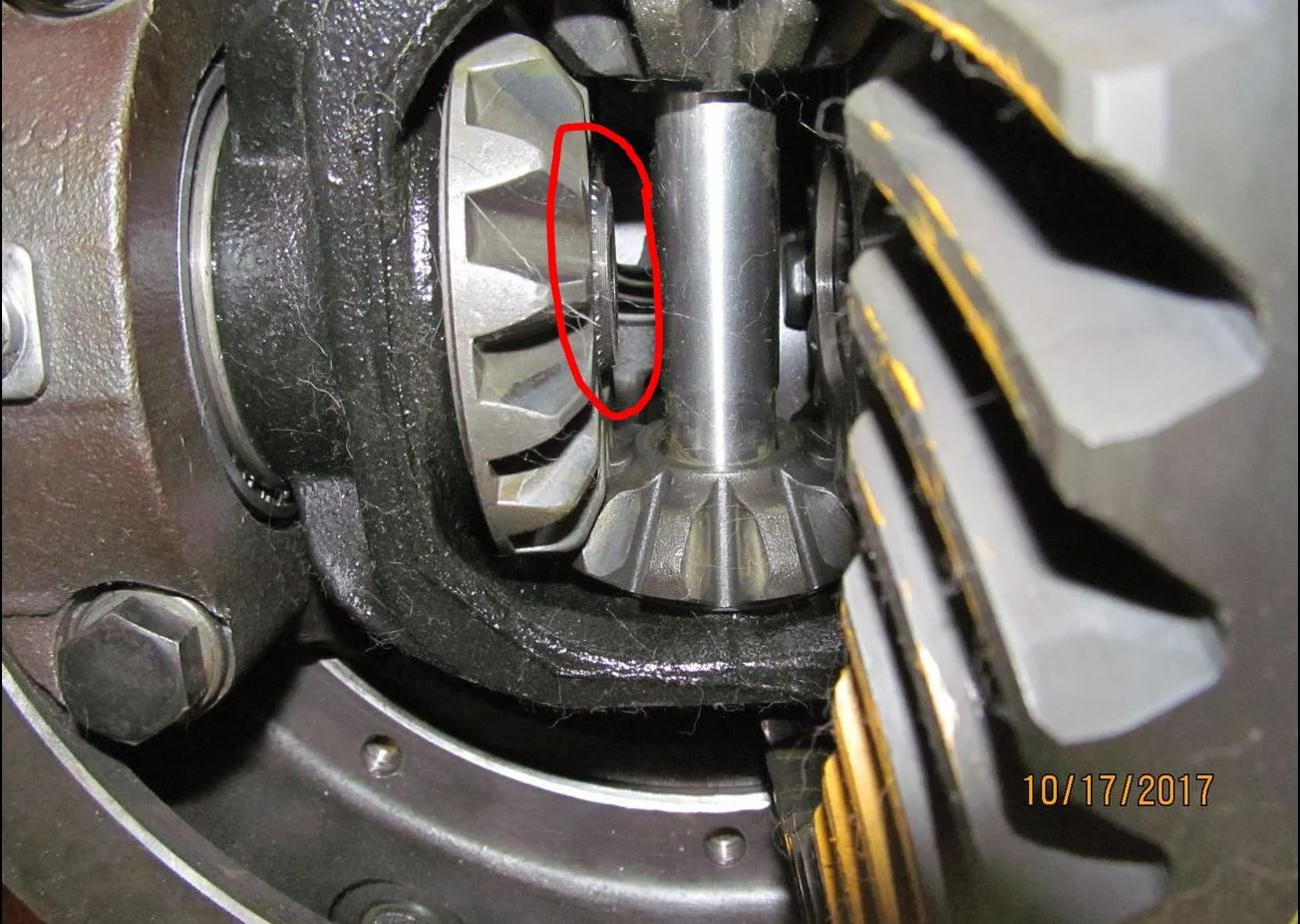

9.5" Center was tack welded. FJ60 3rd dropped in place. The factory 30 spline Tacoma axle was then inserted.
full
Then I could eyeball how far in the axle was with the "openess" of the 2 pinion open diff. Perfect....the axle is fully engaged in the sidegear splines.
full

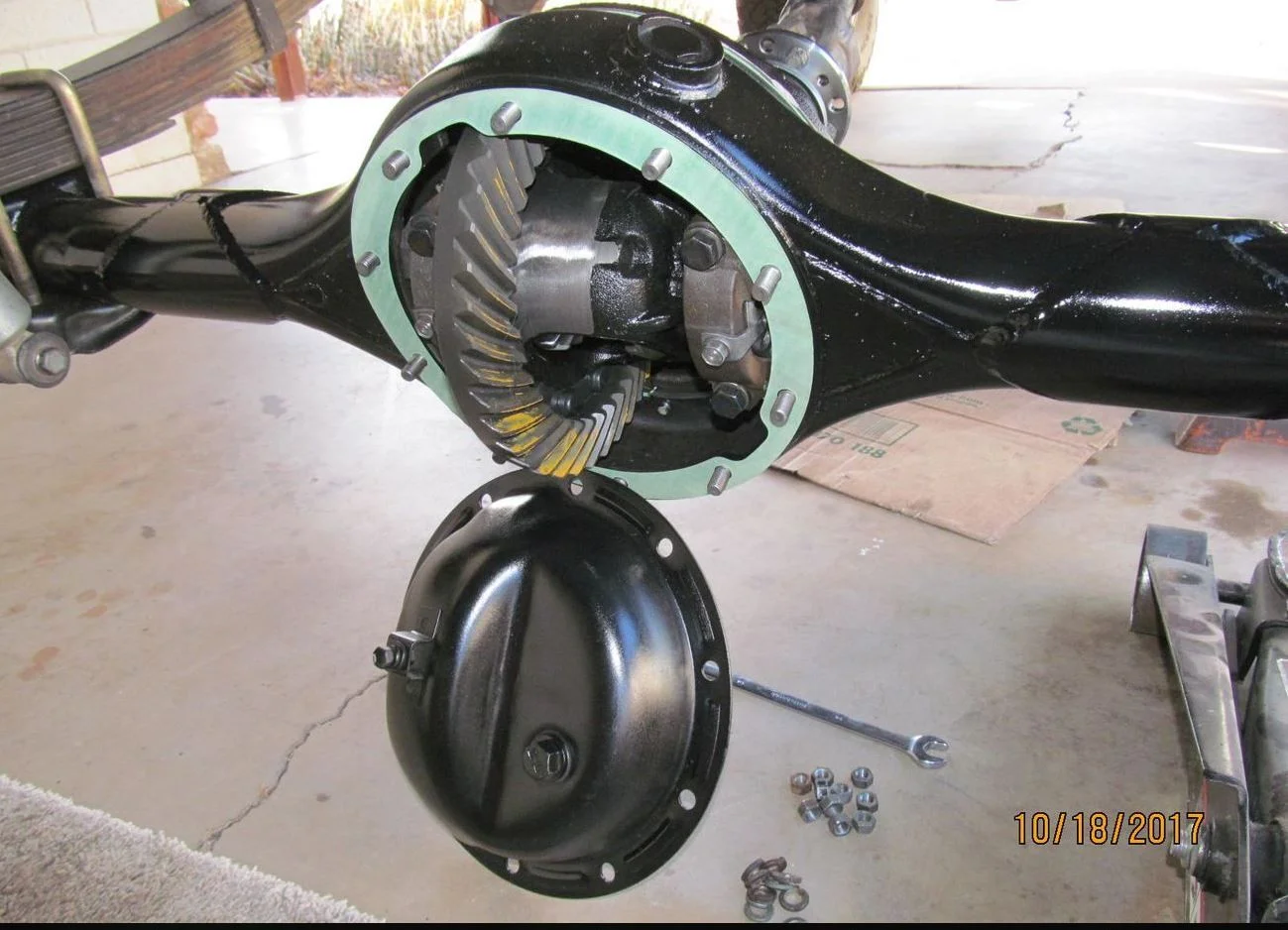

Then it is welded and braced up.....that is .188 DOM wall thickness brace material there. It started life as a DOM tube but with much cutting and a flapper wheel, it was turned into 4 nicely curved brace plates.
full

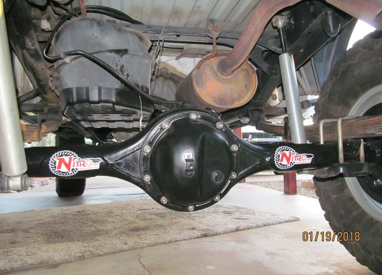

mounted up and painted. I now have a fill plug. Love having a rear service cover with the stoutness of the 9.5" ring gear :)
full

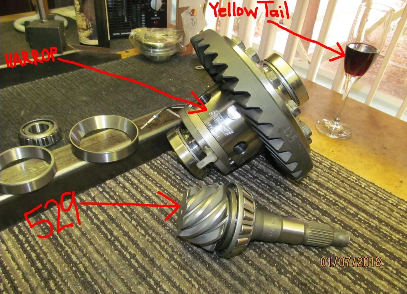

One more addition to make before calling it good.....529 Nitro Gears and a Harrop elocker. Yellow Tail wine from Australia. The vineyards (Yenda,Australia) are only 350 miles north of Melbourne which is where the Harrops come from. Wine to be enjoyed AFTER the technical part of the gear install....not during. ;)
full
No leaks....no pulling or crabbing....just rides nice and quiet now :)
full
