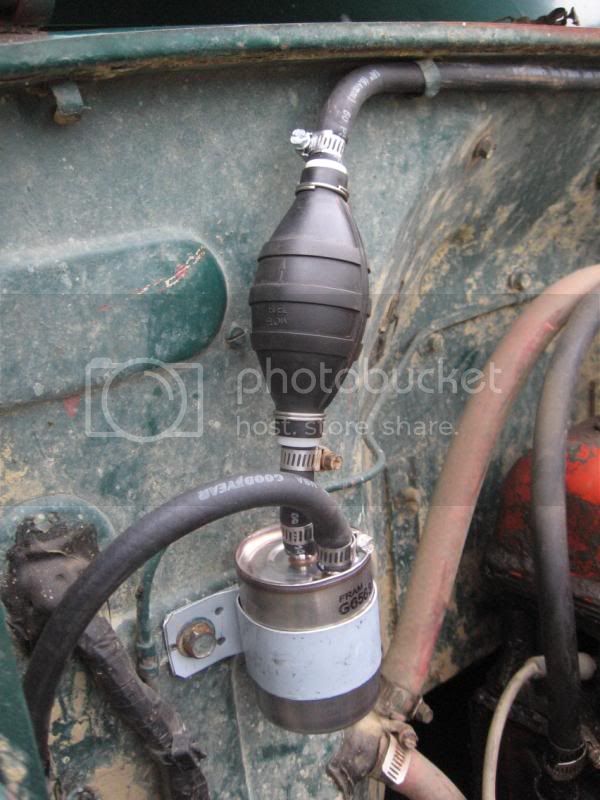

Just did some work with the fuel lines and filter yesterday. It ain't fancy, but it works and is WAY better than what I had before.

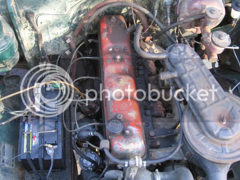

Before: Notice the line in front of the engine and equipped with a sad lawnmower filter

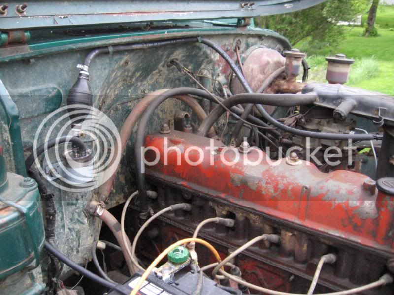

After: The line now up to the fire wall, new properly sized filter and the primer mounted just above.

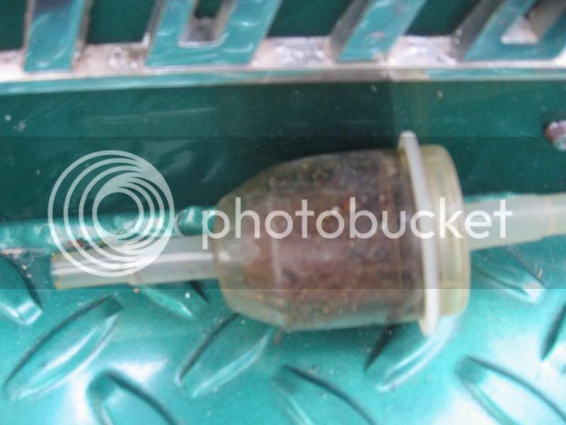

I thought the little filter it had was still somewhat clean, but when I removed it and gave it a little shake, it showed that it was actually quite compacted with sand!
Since the filter was so dirty, I checked to see if there was a pre- pump filter which there was not. So I plan to buy another filter, instal it before the pump, replace the pump and lines, properly install hard lines, and the current carburetor is going to have to be rebuilt. The carburetor I want is on back order till mid July. Hopefully this fixes the hesitation and low power problems.
