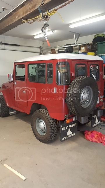

Finally got a friend to come by so i could put the top back on!!! It is Dec and there is 8" of new snow on the ground Hahahaha. (Snow pics coming soon) Haha kinda sucks having no gearhead buddies around.
