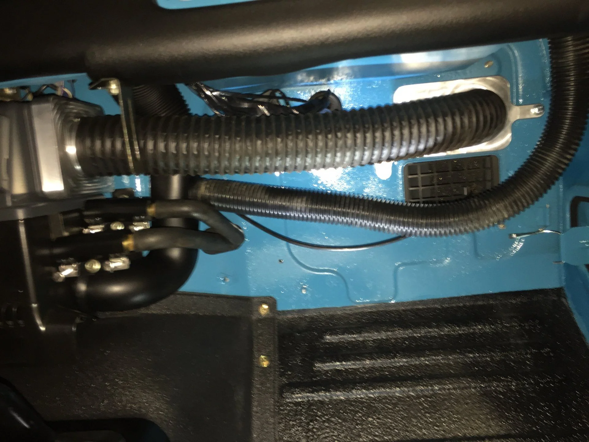

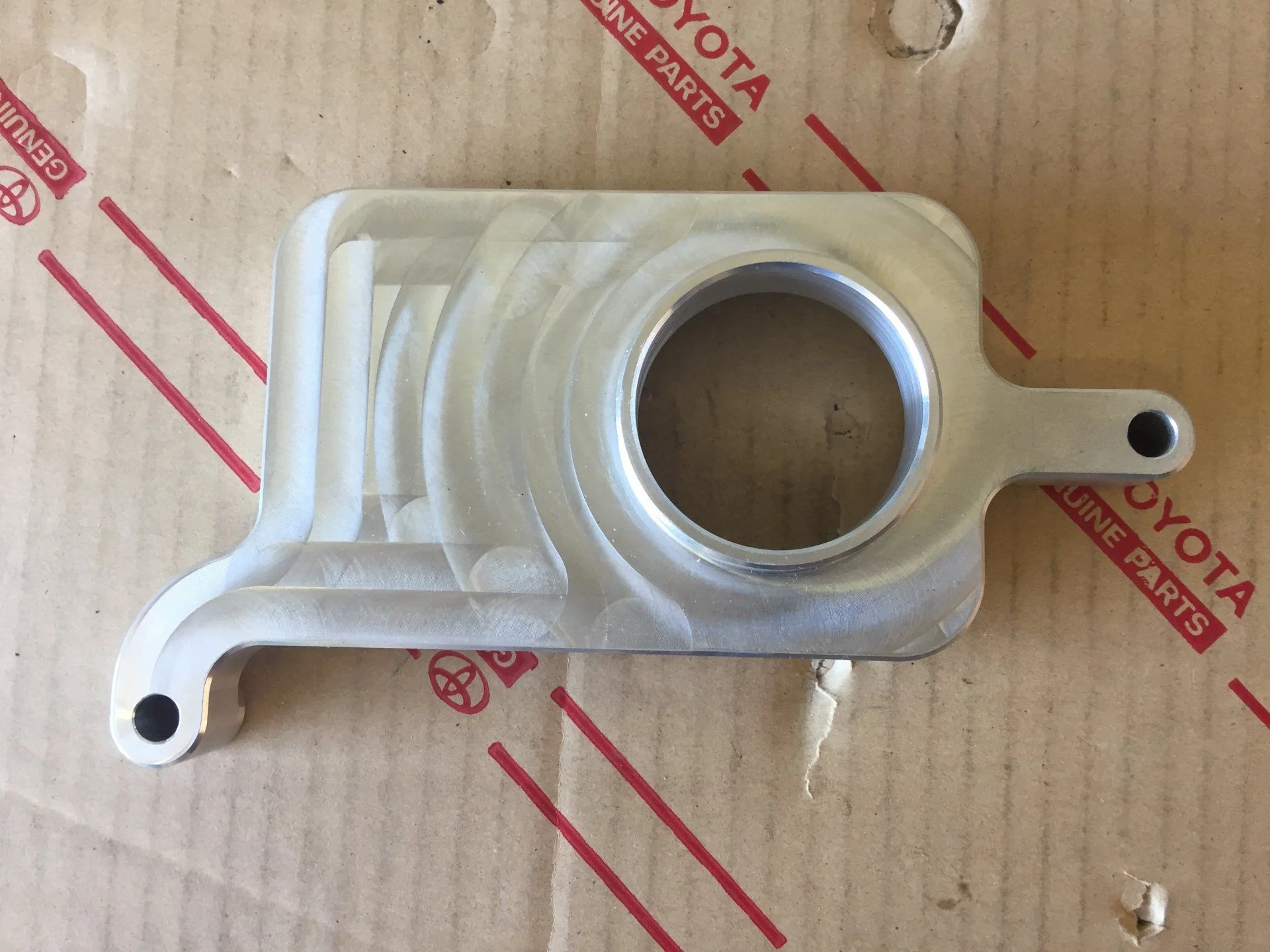

I had a friend make this setup to replace the heater duct. It will allow the AC unit to rotate up higher in the back for more clearance in the passenger foot well. BTW these will be commercially available soon.

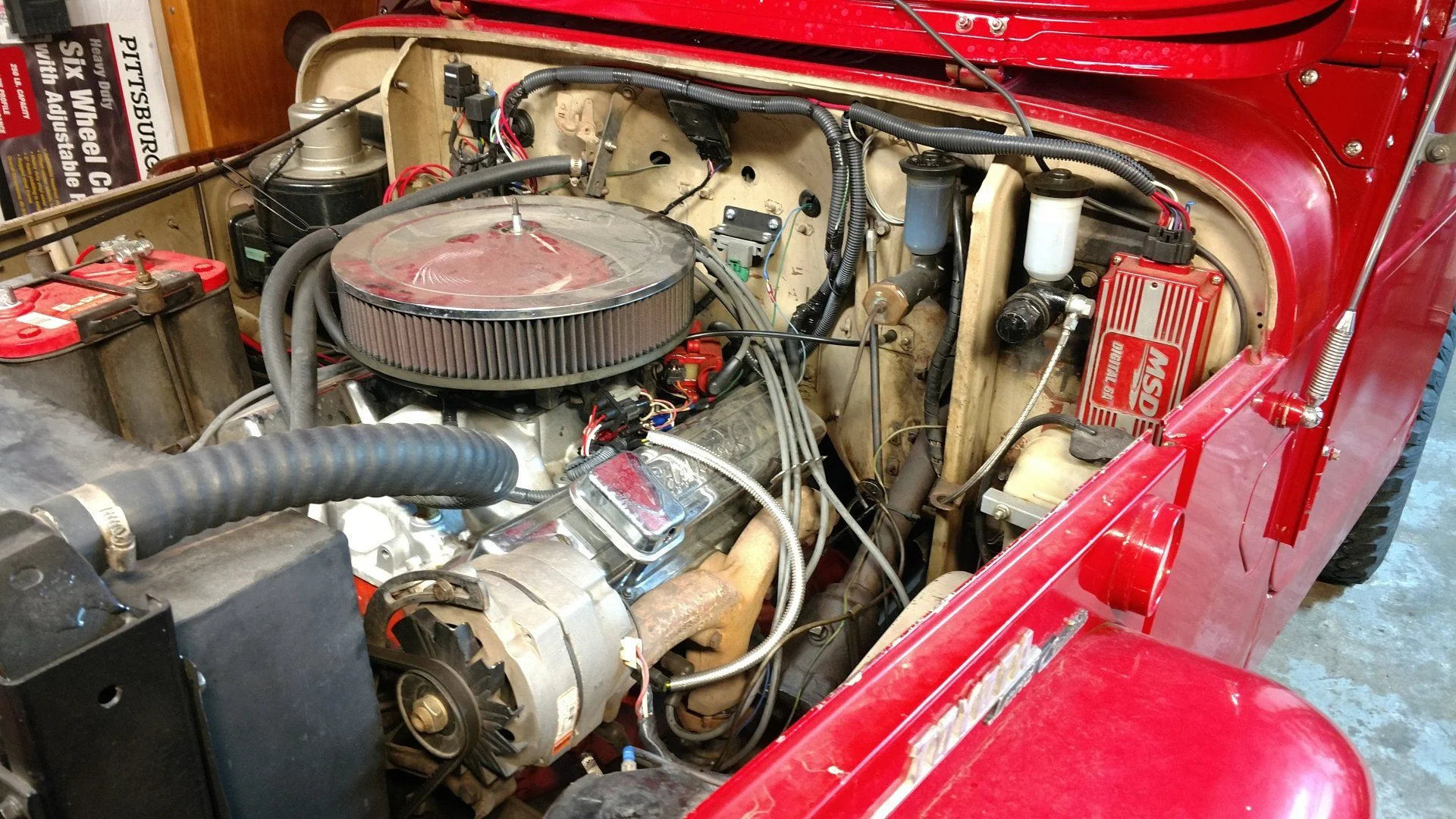

Got time to dive in to my TBI issues on the 350. Seems like the one part I didn't buy brand new when I installed the TBI is the part that's kicking me! :doh: Stupid electronic spark control module.
I will get that ordered/installed and see how it goes from there.
Also hooked my MSD ignition controller back up. I disconnected it after the check engine light came on and it went into limp home mode. My idle quality, idle rpm, and throttle responsiveness have all improved significantly with it hooked back up. Maybe I don't hate this engine after all....
