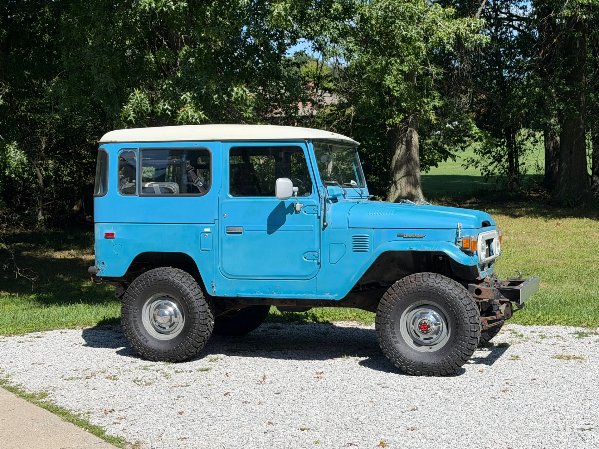

Did a quick walk around to get acquainted. @mossman40

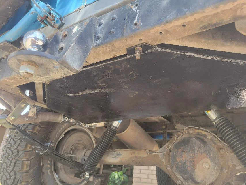

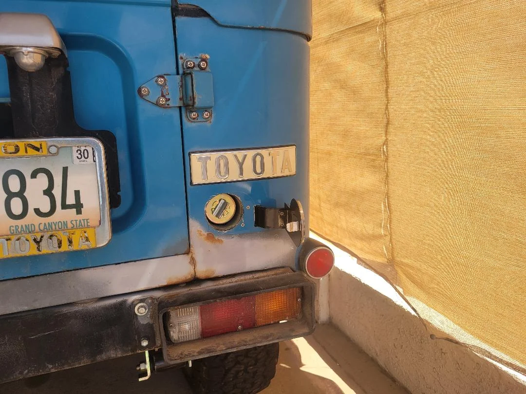

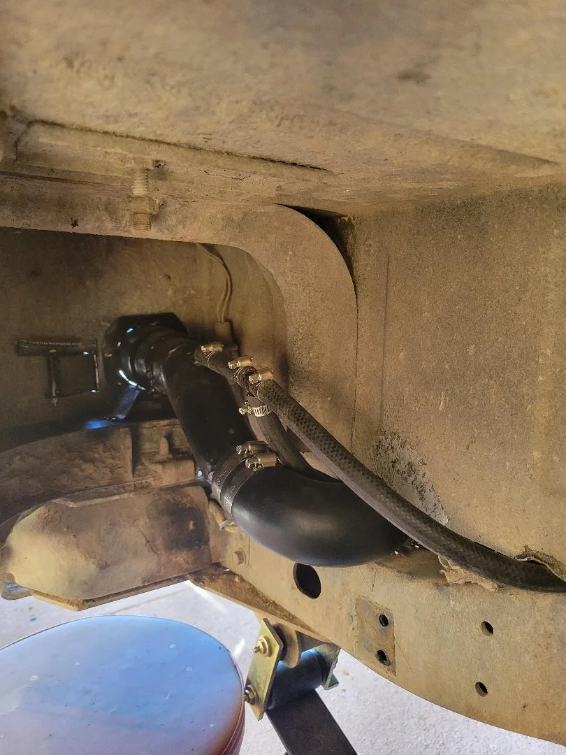

I installed an old aux tank that I've had for a while in the 78. I'm not sure if it's a Downey or some other fab shop? Anyone recognize it?
Been wheeling 40s for 40 years and always wished I had more fuel capacity but couldn't bring myself to take the hole saw to the tub... so I hid it under the 4Wheel emblem
With the low fill neck position, it fills slow at the pump, but I'm a patient man...
Next, I'll fab an inner fender to protect the filler hose.
View attachment 4213331View attachment 4213332View attachment 4213336View attachment 4213335
You built a hinge for the emblem?! Thats awesome
genious!

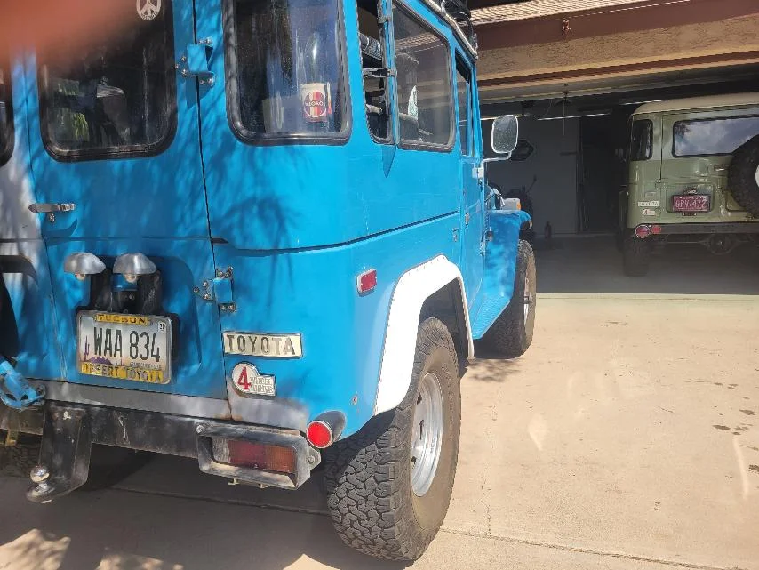

That is some sweet craft on the 4WD emblem gas filler!! Love how some old cars hid them behind the taillights/plates/emblems and such.

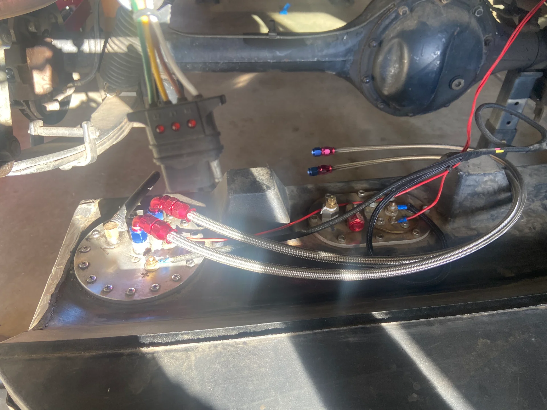

New fuel lines, installed a Wilwood proportioning
valve on the rear disc brake line, pulled the top off, installed a happy dog. Good week.

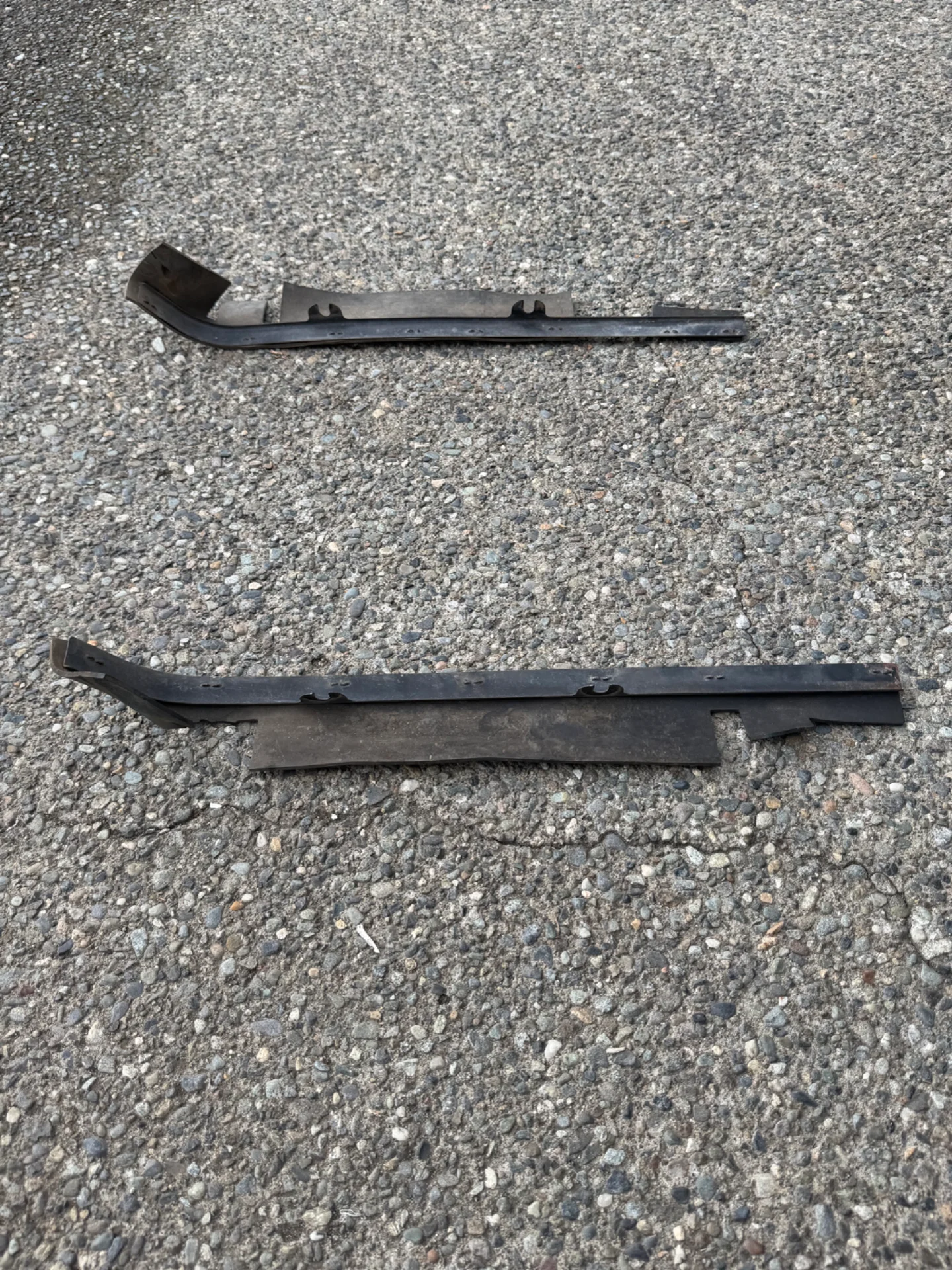

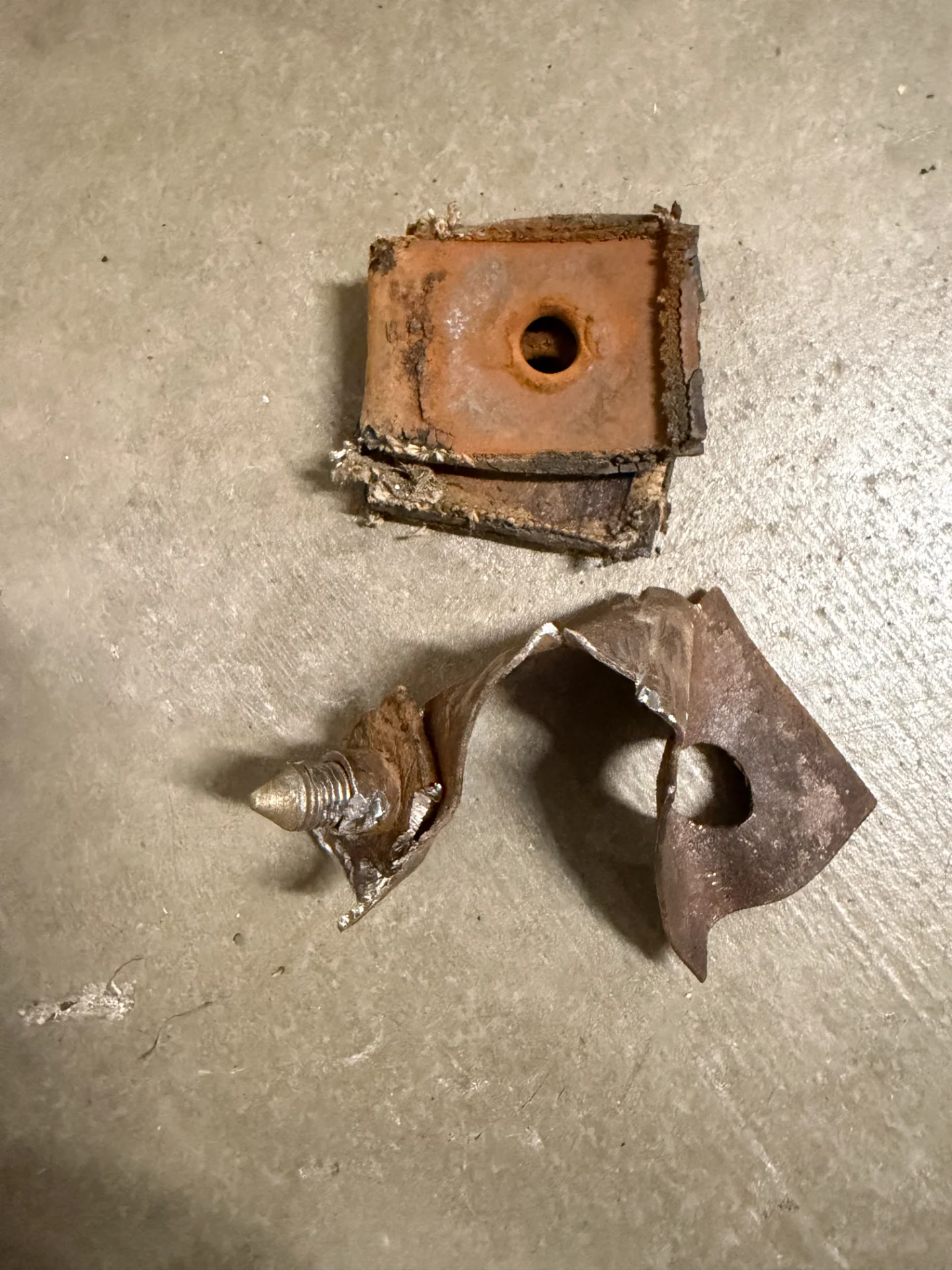

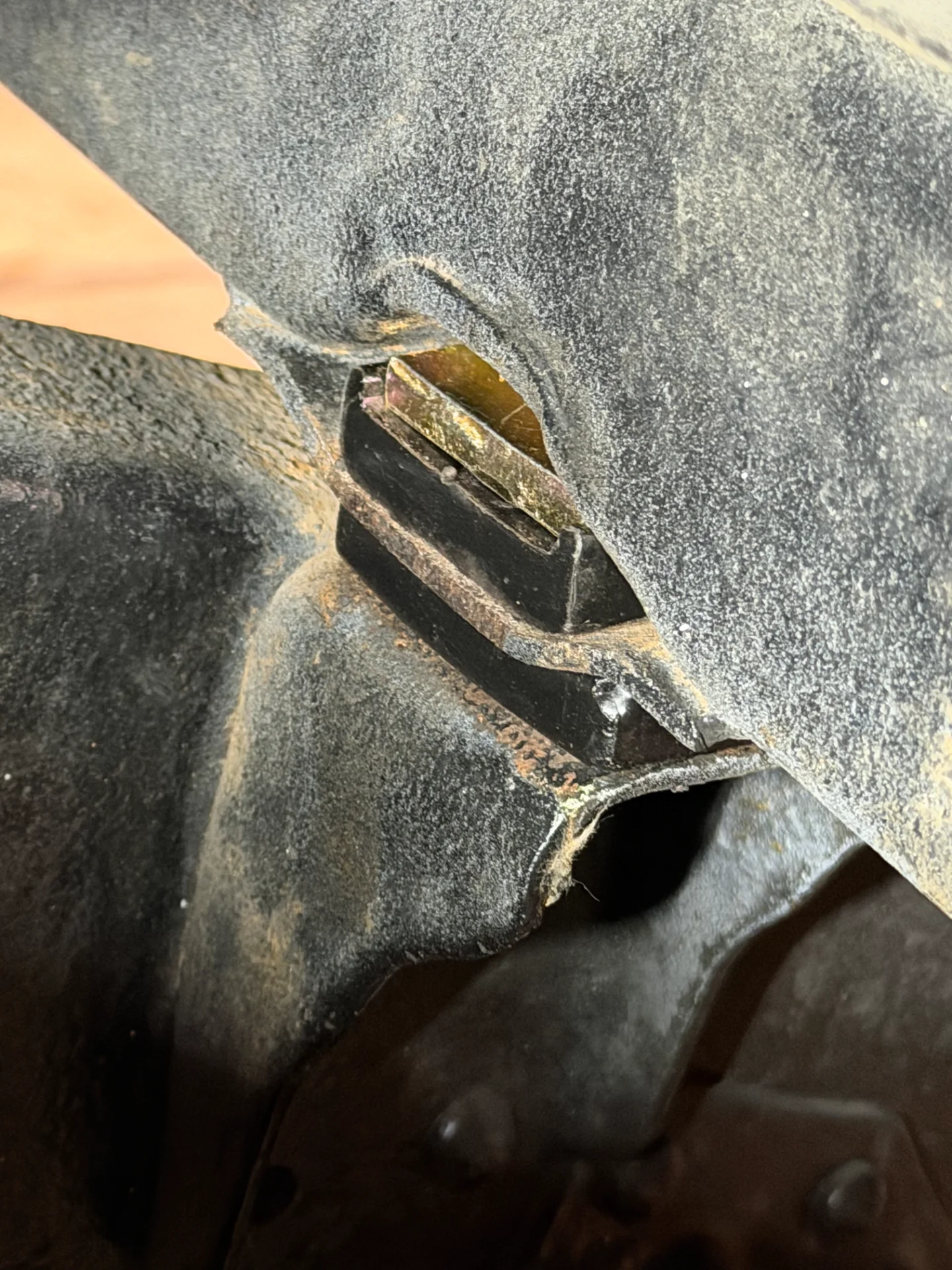

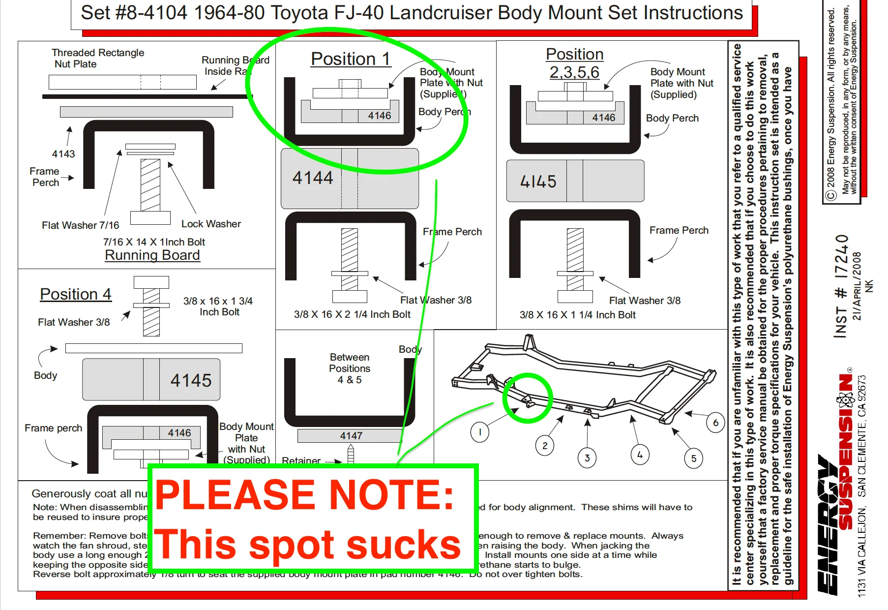

I swapped out my body mounts. Not to be dramatic, but I hated every minute of it. It's never as easy as replacing the old with the new. Some had to be cut out; some bolts broke, leaving them trapped in a tough spot. I ended up having to punch out a few with an air hammer. Oh yeah, and Energy Suspension provides these super nice metal plates with a welded-on nut. They're really nice in every area except spot #1, where they are too thick. Took some modification and a ton of curse words to get them in there.
In the event you happen to break a bolt when removing the old rusted ones, I pray for you.
Was it worth it?
