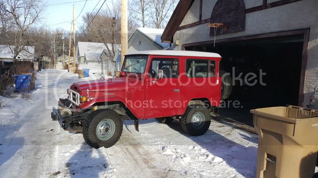

Started it up and gave her some fresh air. Been in the garage hiding for the last month as the -25C and colder temps kept it indoors lol. It was above freezing the last few days so i let it run for 20 mins or so out in the sun then back into the garage.
