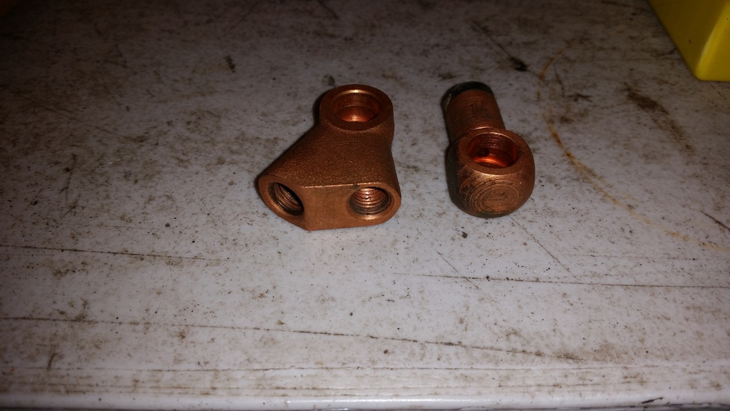

cant say I have ever seen a new one of these(on left)
Any idea the part number of the fitting on the right? 9mm or 10mm?
