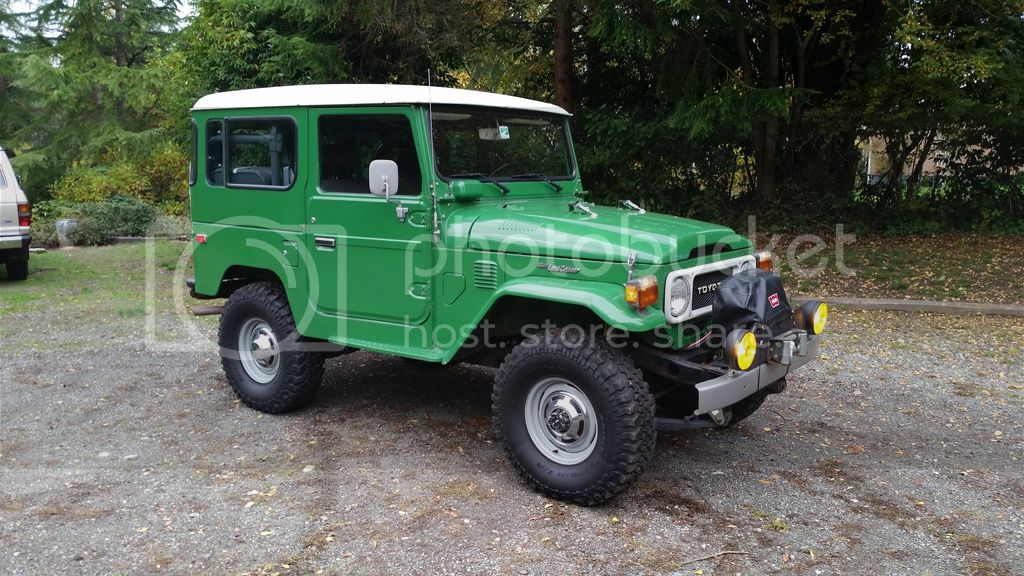

The 67 FJ45 LPB got its top back on for the 1st time in about 10 years, gonna pull it again and redo the rear seals(I have new corner pads)
thats Jared, my Cruiser tech in training.....;)
also got a new slave cylinder, oil change and all fluids changed, new radio installed, turn signal issue fixed, new 25mm drain plug(took me forever to find that from Toyota)

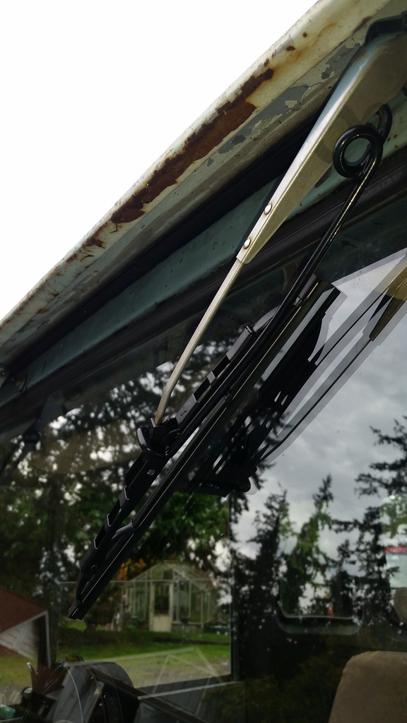

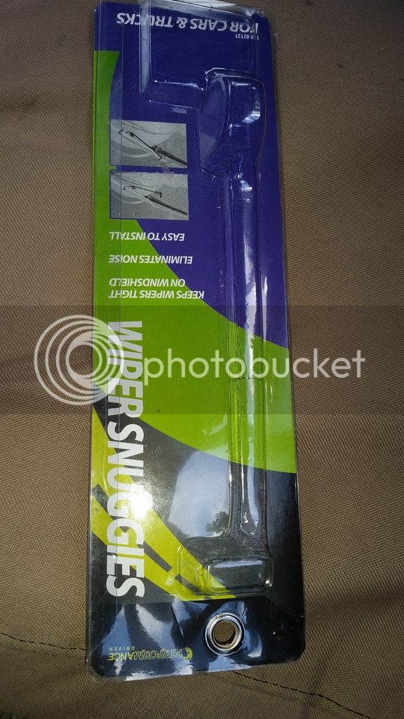

also put some new wiper blades one, had to go aftermarket, none of the 5 OEM styles I had on hand worked. Also added some Wiper Snuggies

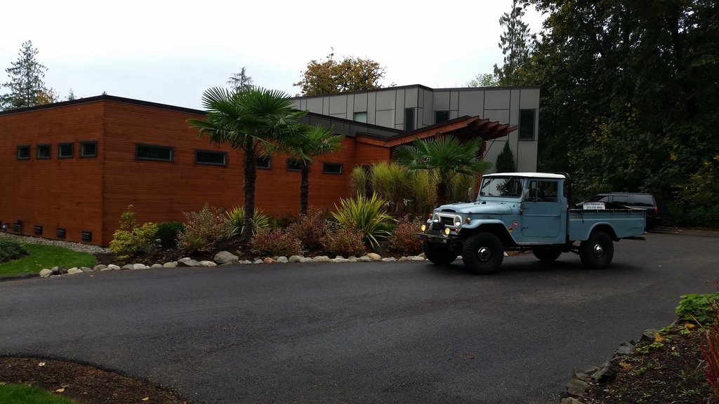

so the LPB is back in service as my Real Estate rig.....and its working very well. This is a home I just sold to some super cool people from Texas

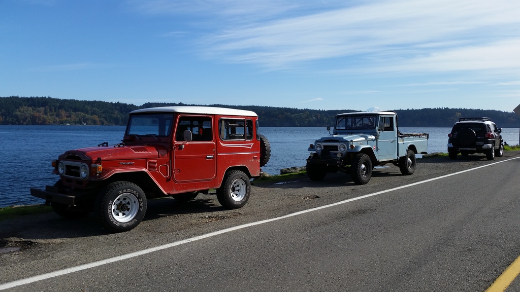

went down to the beach for lunch after working on it, that's Little Red the 77 I got for my buddy Jared there were Humback Whales breaching behind us. Nice older guy in a FJ Cruiser stopped to chat.

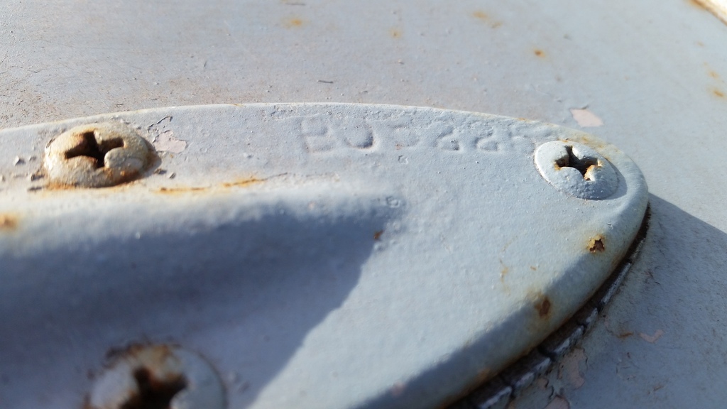

noticed the hood hinges had this on them.....BJ82215?

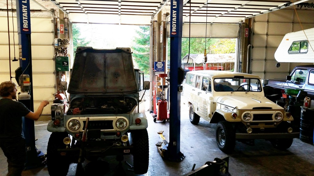

I went around time and time, tightened some bolts and stuff.....no love. Lubed the chasis and suspension. Next step was to put it on the rack and start checking from below.
While waiting for the rack to open, I went thru a pile of new parts I had, put on a new inner and outer shift boot, new boot retainer(I had lost the old one) I also put on new rubber the hood rests on(sides and front) as well as new window pads......it was at that moment I found the noise.....when I undid the hood hook it made the same springy chirp. Took it for a drive and no more chirp! so somehow when it warmed up the springs in the semi new OEM hold downs started to make a chirp noise. Amazing.....

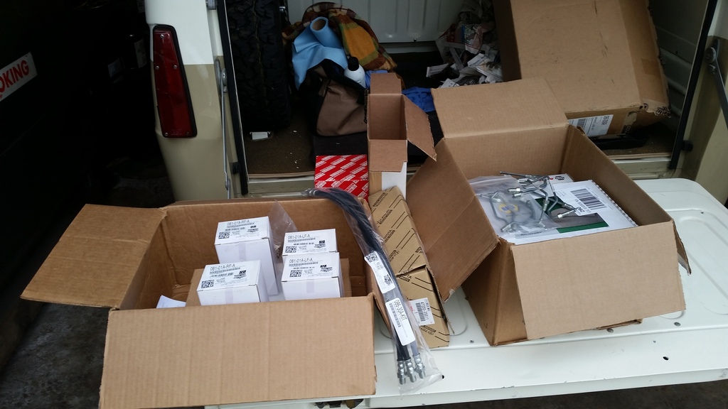

finally rounded up all the parts to redo the drum brakes on the 64 FJ45LV, right front drum was locked up solid(I knew it had a leaky cylinder when I parked it last)........yeah I know.....why not a disc swap?......well the 77 FJ40 Jared got was suppose to be a parts truck when I went to look at it.....turns out it wasn't.
So I ordered up all 9mm new wheel cylinders, all new soft hoses, all new hard lines, new OEM master, new shoes, springs and other stuff.

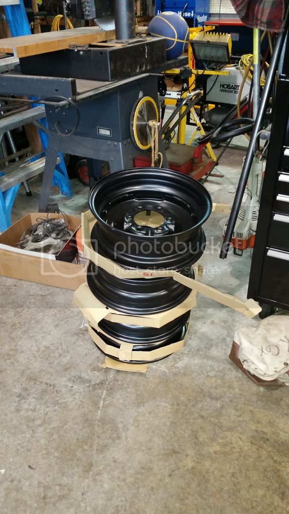

Also a set of new OEM wheels(I have a few sets of early caps)
