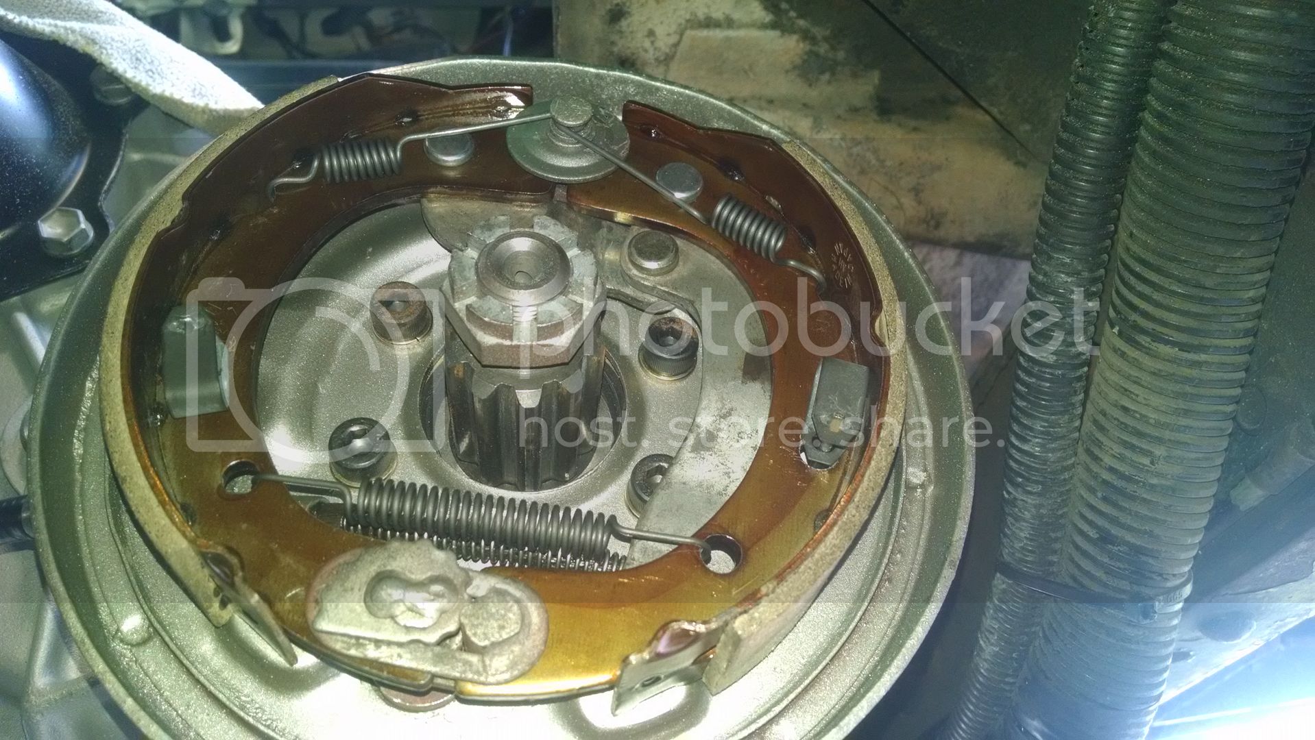

Sggoat Gary and myself doing an Emergency brake rehab on the '71, new seal and brake pads. Typical oily gear lube impregnated with decades of dirt and leakage. The Goat has the formula, soak the hardware in a gallon of old carb cleaner overnight, rinse then soak awhile in Super Cleaner detergent bought at Advance Auto. looks like 1971 new parts now. Wish he would of told me of this combo sooner. Cleaning and degreasing the rear driveshaft too. Weird.... when we removed the rear driveshaft at the rear pumpkin one bolt and nut was missing and the other 3 were barely snug! I have not messed with this since the engine swap back in '84....Did I not give a final tightening to rear DS bolts back then and have been over three decades over numerous Colorado mountain passes and Florida streets and boulevards with loose nuts??? Appears to be the case. Better service the front driveshaft too. Bought the shoes, dust boot and seal from JT Outfitters, best price with shipping.. Got here fast. I got a big discount and priority mail over their online shipping quote by calling my order in FYI.

I have learned a big lesson.my son and I tore it apart In April and between life ordering parts and waiting on the major part to come in .i should have never taken it apart until I had everything to do the job.
Or, take a LOT of pictures of everything you do, at various stages.
