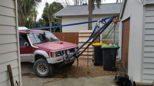

Pete,
Can you give us more details and pics of the gin pole?
Looks incredibly useful!
Thanks
I have one that fits my L200. It's just two 50mm box section beams that hook into the factory towing loops and a pair of ratchet straps that run to the frame behind the cab. It is tested to whatever a H motor weighs!20150709_134420.webp
