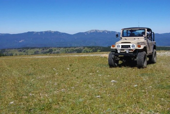

Installed the roll cage and bikini top. Took Da'40 for its maiden voyage putt into the mountains.
