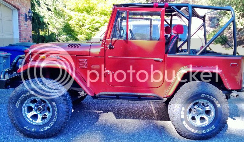

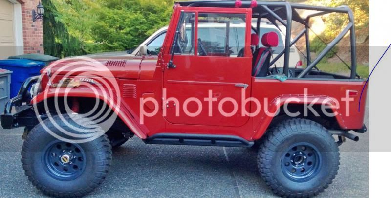

Met up with another Mudder to buy his lightly used 33x10.50 BFG KM2s on ATX Mojave 15x8 rims. Replaced my 35x12.50s in order to reduce the height by an inch so that my FST bows can fit in my garage. Added benefits were improved steering(less wandering/tracking in ruts) and better acceleration. The back is not sagging; just the driveway slope.
Before:
After:

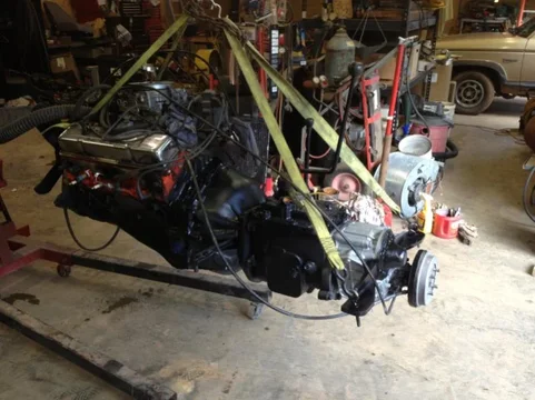

Finally separated my tcase and tranny. After hunting for a puller with no luck I came up with a new use for my '40 and ratchet straps. Luckily my splines are in really good shape.
