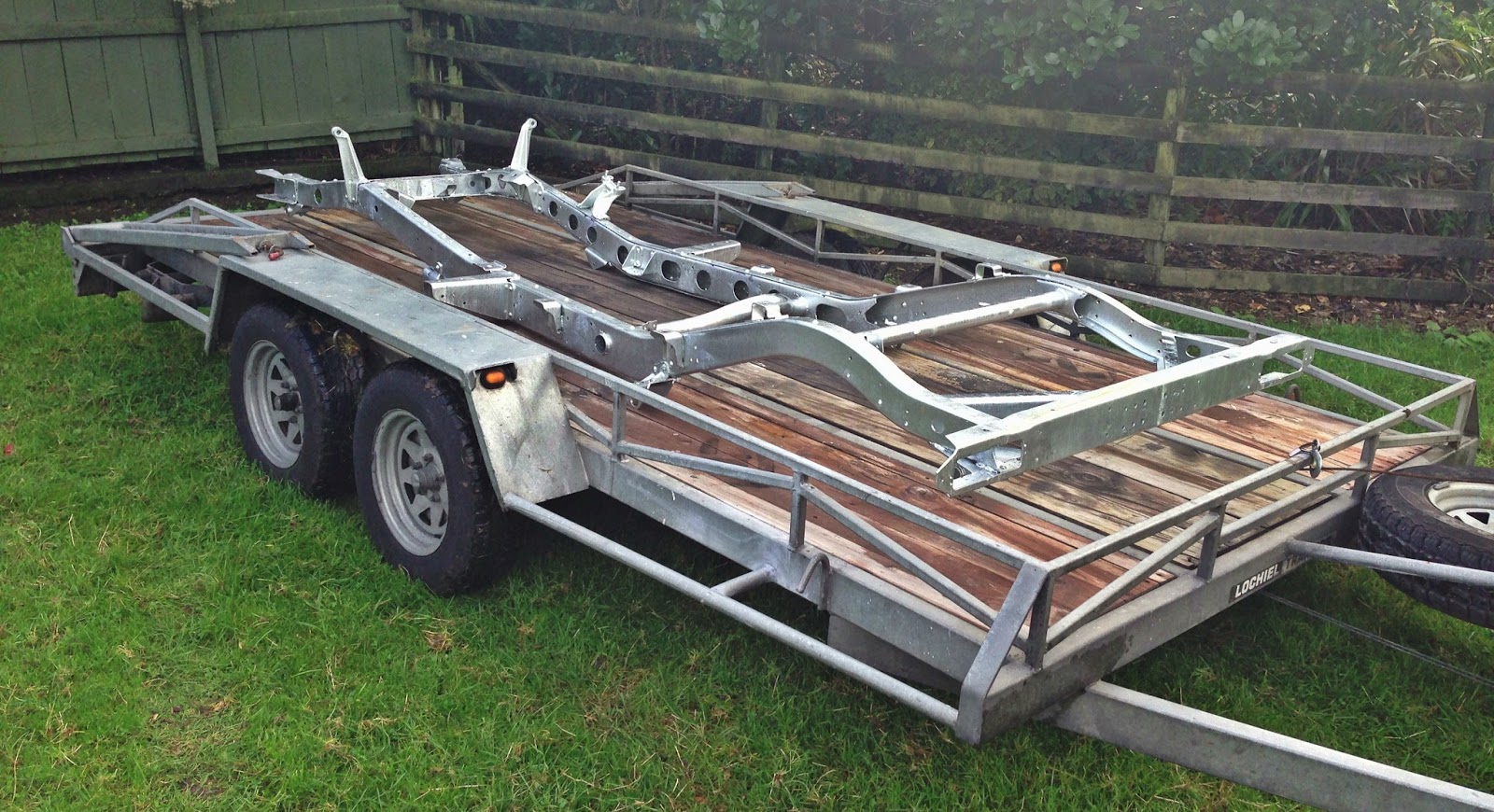

Wish I'd done that 20 years ago, rather than just paint... :frown:
